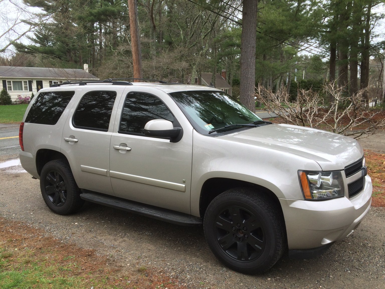

New to the page, just sold my 96 Tahoe 2wd that was lowered 4/7 on 20s. Picked up a 07 Tahoe lt 4x4, has 20" Yukon wheels on it now. Iam looking into either 22" or 24" reproductions and a 2/3 or 2/4 drop. Here is the truck as of now.

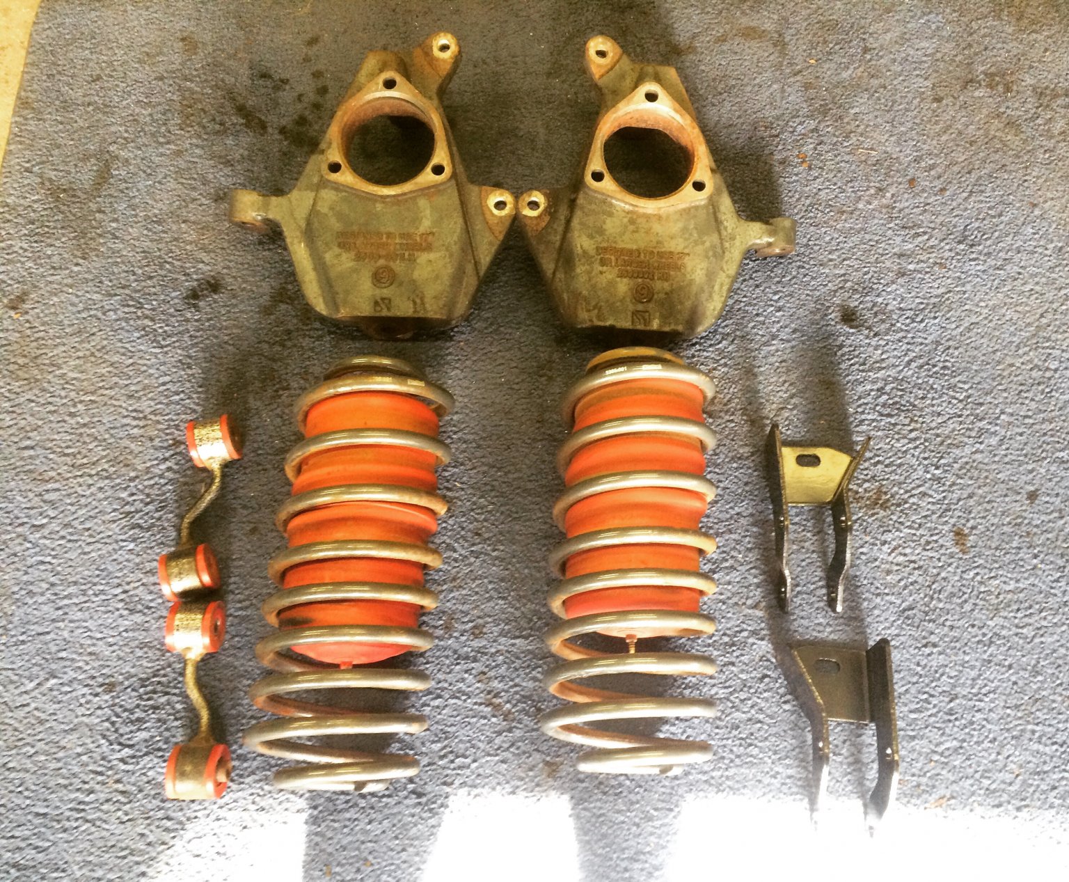

Well, browsing Craig's list today in my area came across a guy selling a bell tech 2/3 kit for 07-11 Tahoe. With djm shorter sway bay links and the other brackets to move the rearend back. Also helper bags inside the springs. Scored every thing for $200!

Get new bushings for endlinks and drill and tap for zerks

Not a bad idea, do I I have to run the other brackets it came with? Seems like the hardware kit is more used for over 4 inch drops in the rear. I guess it pushes the axel rearward?

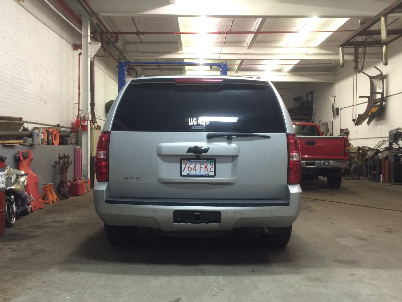

Got the bell tech kit in the truck today. Left the rear spacers out for 2/4 drop but I didn't like the rake. So I put the spacers in for 3" in the rear. I like the look and ride but is there a way to get 1/2" more out of the front?
