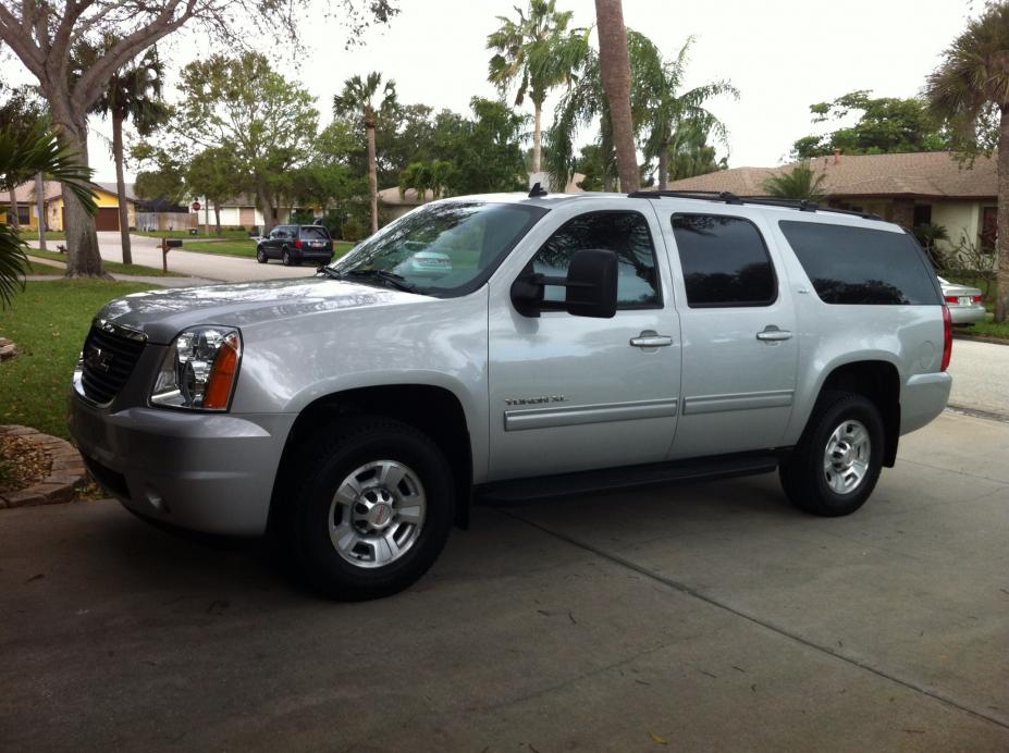

New to forum and first post.
Just recently, last week bought a CPO 2011 yukon xl 2500 4wd. This truck is awesome, love the power of the 6.0.
I searched the Internet for weeks and had to fly 900 miles and drive it back but the deal I got was worth it.
I have noticed that when I am stopped at a stop light the engine will sometimes shudder, it was really bad on the first tank but now on my third tank it seems to be getting better but still there.
I picked up yukon just outside of DC and drove it back to Florida. I don't know if the colder weather had anything to do with the shudder or the fact it might have some older gas in it from sitting on the lot for almost 60 days. Now on my third tank and being Florida it still does shudder but not as bad.
I know it's under warranty but after researching on the Internet this seems to be a characteristic of this engine or am I mistaking. Any suggestions?
Other than that this truck rocks and looking forward to next weekend when I get to tow my 8000 lb travel trailer.
In case you are curious I replaced my 2007 ford expedition Eddie Bauer 2wd which at best towed the trailer poorly. Even with the 3/4 chassis the yukon rides much smoother and so much more power.
