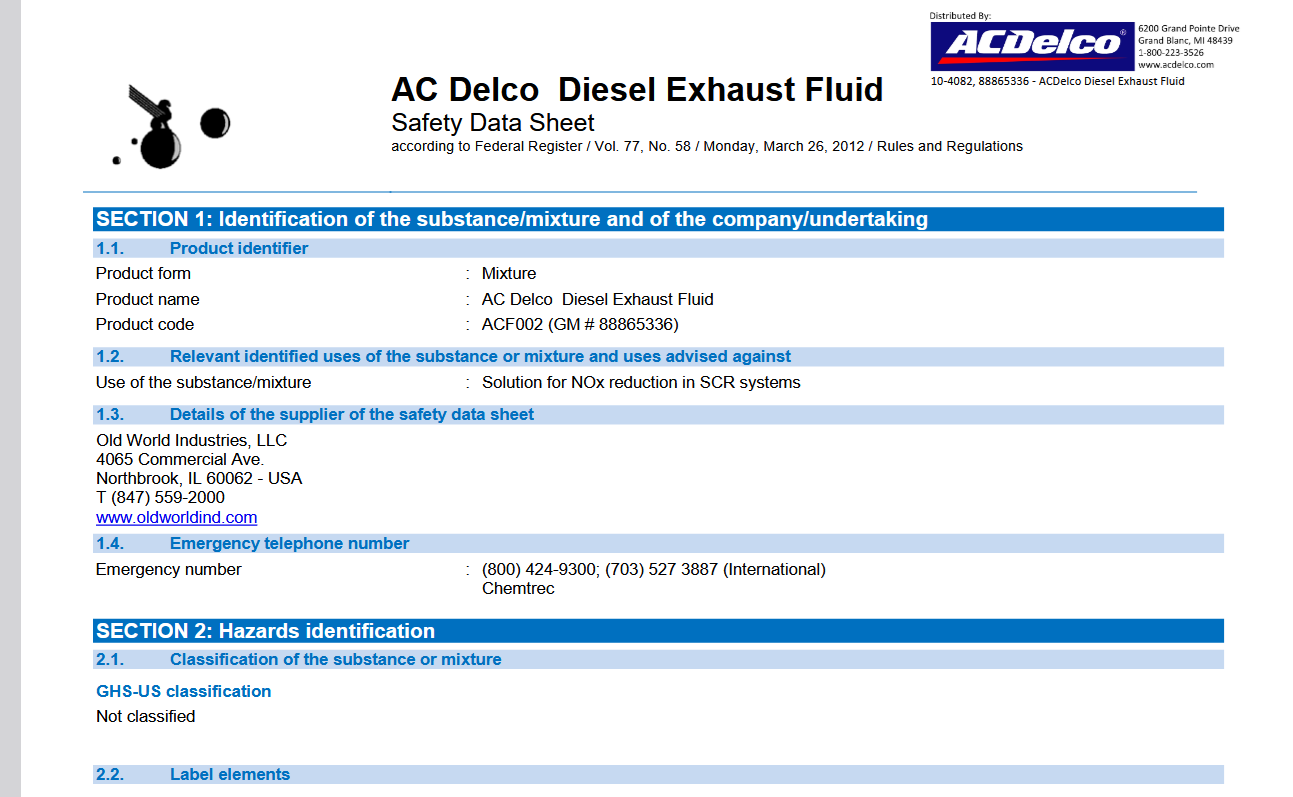

Fwiw, the DEF tank is suppose to be filled to capacity during dealer prep. DEF use is related to how hard the engine is working and towing is working the engine and more DEF use is NORMAL.
  • 10-4023 acd diesel exhaust fluid.pdf

I don't need any DEF but I been to WM several times since I got this truck and they are always out of DEF. The space on the shelf shows they don't stock much, about 3 ft of shelf space. My SM gave me a gallon of AC Delco DEF with my truck and I have yet to use it 6 months later. 4,000 miles, gauge is only down 2 bars which is about 1 gallon per owner manual. DEF per SDS is 67.5% water, 32.5% urea.
