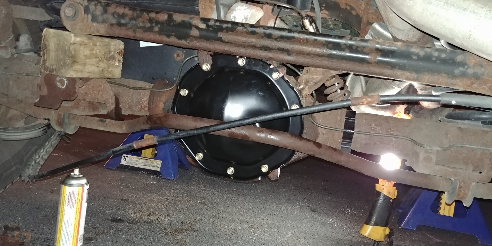

Finished last night, it took me 3 hours from start to cleanup. However My buddy stopped by to show off his new 4" exhaust on his Cummins 5.9 so that took 15 min away. Put rear on jack stands. remove the drivers side track bar (pan hard bar) bolt and move it up and out of the way. Impact with 6 point 13mm was easiest to remove the bolts, last person in here stripped a couple since they did not move the track bar out. I hammered on 1/2" 6 point socket and they came out. Old fluid was not as viscous as I would expect, previous owner pulled salt water sail boat, maybe some water in there? Magnet is fairly clean. I uses a paper gasket instead of RTV, lets see how it holds up. The Dorman bolts look to be zinc plated and use a 12mm socket. I filled at the port by the pinion seal till it overflowed with Valvoline synthetic 75/90 and a little Lucas Heavy Duty oil. Wiped down the cover with acetone and spray painted it to protect from future rust. Good for another 100k.
