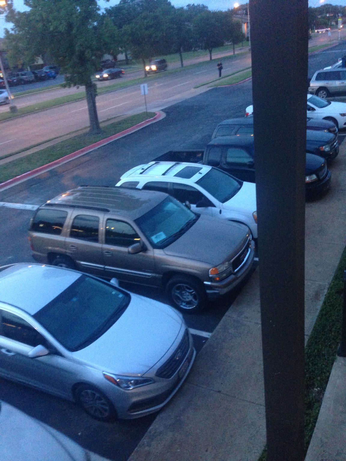

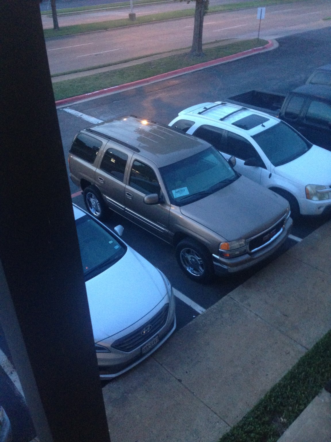

There it is; nothing to write home about BUT paid for in cash and hopefully lower cost to maintain than the %*#+ Land Rover. It has nearly 130k miles on it (according to odometer but I wouldn't bet $$ on that low #) and I propose to do all fluid/filter changes next 2 weeks then maybe some cosmetic replacements. Steering feels a wee bit sloppy but undercarriage passed a visual check. I'm hoping parts are robust enough in that I can take my time searching for deals thereby stockpiling parts for when replacement (pads/rotors/hubs/CA/TRE) becomes necessary. I can not start turning wrenches on it any time soon or I will have to listen to my wife nag me about how paranoid and obsessed I am. I hate that.
