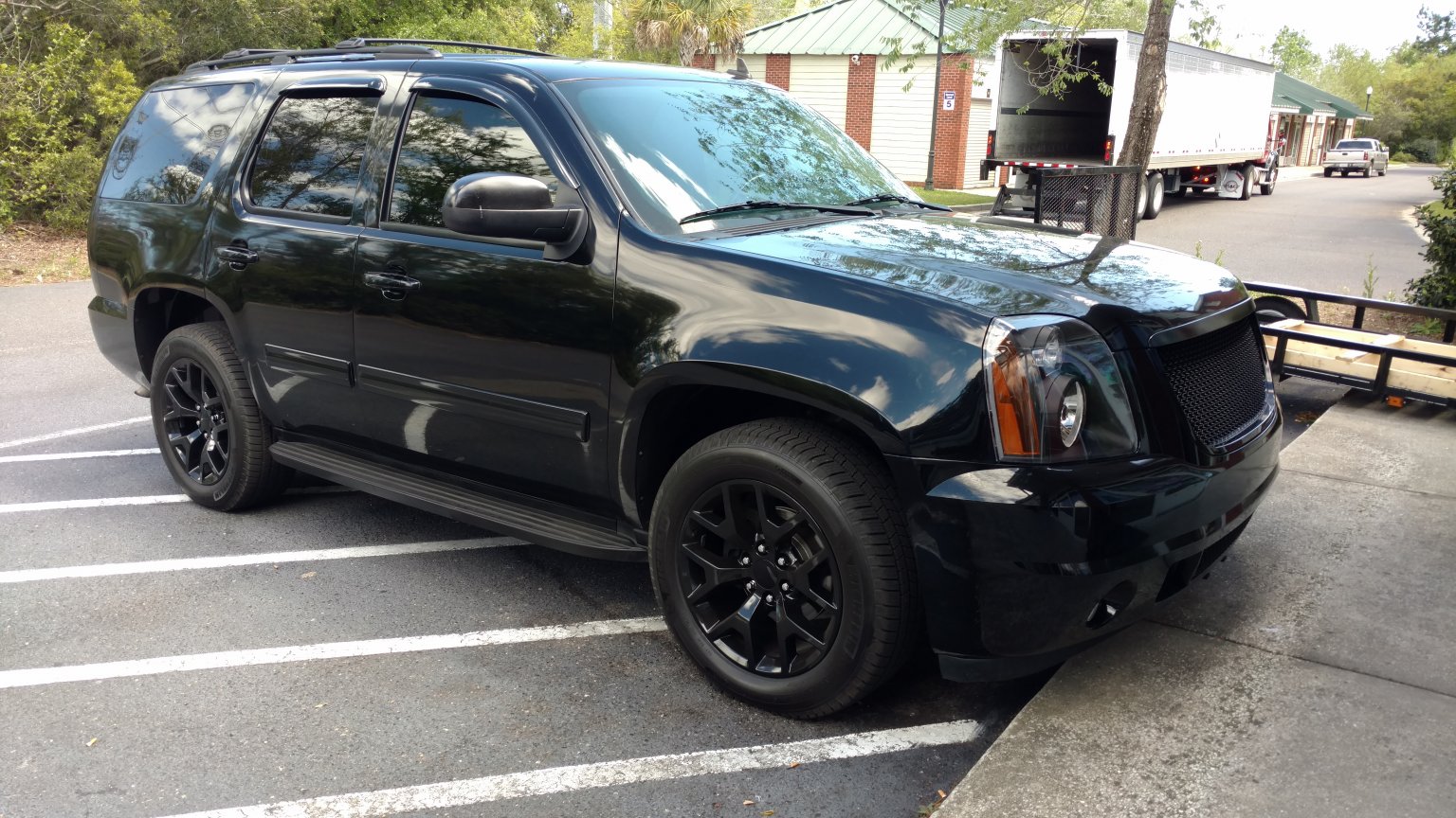

I was curious if I can add power fold mirrors to my 2011 Yukon. I understand I would have to purchase the power fold mirrors and the driver mirror/window control unit. Is this all that would be necessary to add power fold mirrors? Is the other cabling there (power/control etc.)?

You'll need the mirrors and a programmed drivers window switch. You can either buy one new that's suppose to come in the SLT, or you can have yours reprogrammed a the dealer. All the wiring is there already. They plug in to the window switches all the way from the mirror

Thanks for the heads up, the dealer told me I'd have to run a new harness to support the mirrors. Are they blowing hot air?

The mirror comes with like 2ft of wiring from the mirrors to the switch. So yeah, they're blowing hot air
