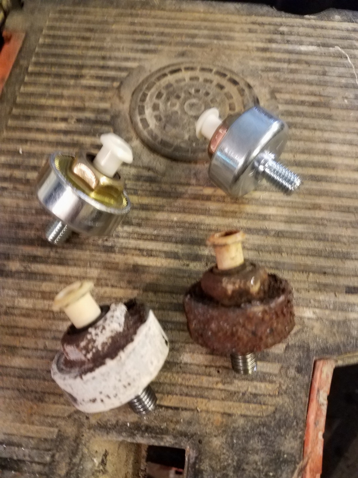

Thanks. And yes, my OBD scanner is in my center console.
Just for grins I thought I'd show a pic of the old sensors next to the new ones.

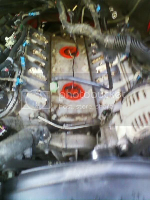

I thought I'd give a little review of my experience replacing knock sensors in the event someone does a search in the future.
As I stated earlier, I am no mechanic. Fairly handy but not a lot of experience. I watched several YouTube videos and figured I could do this. Especially after getting an estimate from a local shop for almost $900 to do the repair. My cost was about $180 for 2 knock sensors, harness and manifold gasket.
I used a 8mm, 10mm and 22mm socket, a screwdriver and a pair of pliers. I needed to buy a couple of tools that I did not have - a 3/8 fuel disconnect tool ($4.50) and a pick with a hook shape ($8.00) to remove the fuel injector wire harness connector.
It took me a little over 5 hours to do the job. It is basically removing the stuff in the way of the intake manifold and removing the intake. The sensors are in the valley below the intake manifold. Took my time, cleaned everything and other than my brain fart of turning the key, it all worked fine.
One trick... in one of the videos I watched, the guy recommended running a bead of RTV just outside of the rubber seal which seats above the knock sensor. This is to shunt water away from the hole the sensors fit in. Good idea.
Go for it - not too hard!
