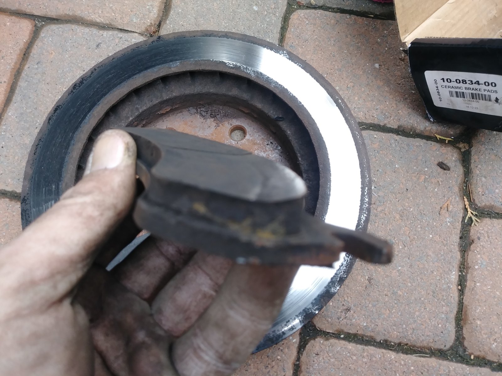

i bought a set of R1 e line drilled and slotted pads with their scorched pads due to my brakes needed to be done super bad when i got mine.
looks like the last owner was a pad slapper, with 121,000 on it these have to be factory rotors. all 4 rotors were pooched like this one. even got a curved pad lol
