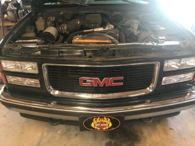

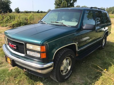

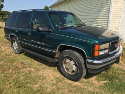

Hey Tahoe/Yukon'ers,
I'm Cody from Flint, Michigan (actually Durand). I've just picked up this wonderful Emerald Green / Tan GMT400 Yukon 4x4 from a friend's mom for $1200 with 170k, very good tires, and some rust here or there that is repairable.
It had sat for 6 years before my resurrection in the driveway. It needed a new alternator, as the old one was seized up, and of course a fresh battery and gas + treatments. Tank was near empty when I began, so I severely doubt I damaged the pump as I primed it a few times before cranking.
Threw fresh headlight assemblies and brackets in it last weekend, as you'll see how bad the originals were in the pictures. One had 2" of water in it.
Everything works aside from the A/C, which I've already determined is the compressor being shot. Bearing makes horrible metal noises to accompany it.
Rear diff cover started leaking the other day, seemingly as though I'd blown it out, as it coated the back of the truck with oil and residue. Gotta get a wash in there somewhere!
Things done before its hibernation:
-Fuel Pump & sender assembly (yet gauge does weird things)
-Fuel tank
-Tires
Things I have for it, ready to install:
-Distro cap/rotor, plugs, wires, as the spark looks kinda weak and orange
-Fuel filter
-Front calipers/hoses/pads/rotors
-Rear axle hose
-Master cylinder & fresh fluid throughout
-Serp belt/tensioner/idler
Things it needs:
-Main front-rear brake line looks crusty, but stops fine
-Diff fluid changes front and rear for peace of mind, will be swapping to 75w90 synthetic
-Front right bank O2 sensor
-Oil change
Problems I've found:
-Radio volume/power knob is missing, and super sensitive to rotation... sometimes gets mind of its own with volume, likely due to dust
-Occasional hard start when sitting more than a day or two (truck turns over fast, catches almost like a backfire, then cranks again... I release the key, it diesels once or twice, I crank some more, same things happens for a minute or two until it coughs to life and runs... it's very hesitant to take throttle for a minute, hence needing fuel filter)
-Rear left barn door lower hatch has rusted completely free of the door! (anyone have a good door shell/door they'd sell me local-ish?)
-Power mirrors don't work
-ABS is in-op (likely a wheel speed sensor or hub tooth ring)
-Rear diff cover leak, obviously
Considering how long it sat, it runs and drives PHENOMENALLY well! 4x4 works great, power windows are flawless, transmission and fluid are in excellent condition, and even the old engine oil is still looking gold. Leaks nothing, leave's no drops on ground from engine!
Going to be an excellent tow rig & hauler of stuff, as well as a good winter vehicle for the lady when it's especially bad out.
I'm glad to be here guys! Pictures to come.
