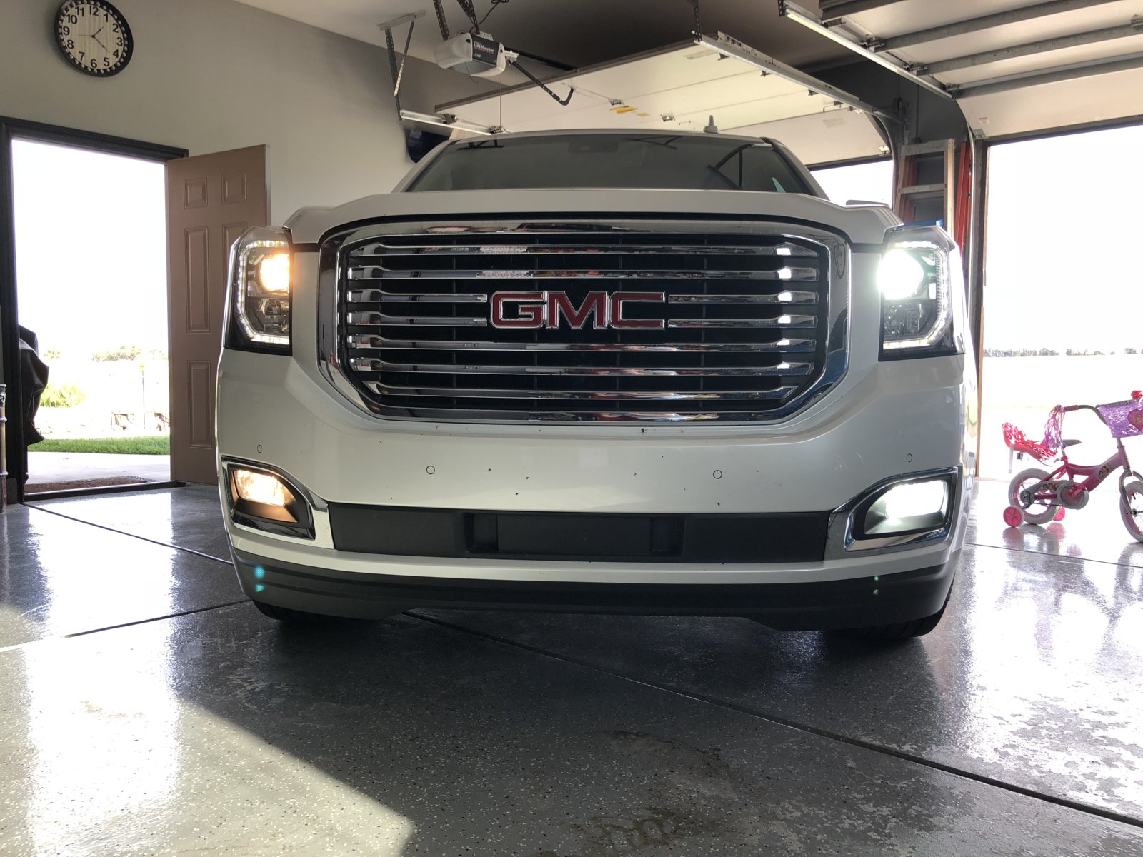

Here is our 17 Yukon. This is a comparison pic, pass side being OEM, Driver being aftermarket. I went with 6000k HID for low beam, and 6000k LED for high beam and fogs. The kit I purchased was from Vanquish Auto. I have had great luck with everything I’ve purchased from them, both for the Yukon and my F250 SuperDuty, although they don’t have the best name around the forum for their customer service.

Here is our 17 Yukon. This is a comparison pic, pass side being OEM, Driver being aftermarket. I went with 6000k HID for low beam, and 6000k LED for high beam and fogs. The kit I purchased was from Vanquish Auto. I have had great luck with everything I’ve purchased from them, both for the Yukon and my F250 SuperDuty, although they don’t have the best name around the forum for their customer service.View attachment 248534
you are one of the few that has had any luck with vanguish auto even though they are a supporting vendor (or used to be) they are the running joke around here.

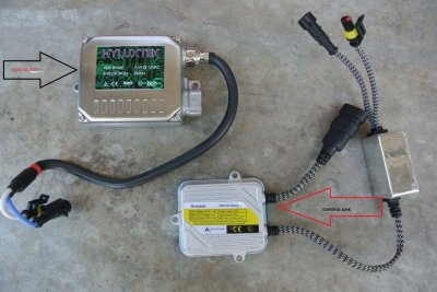

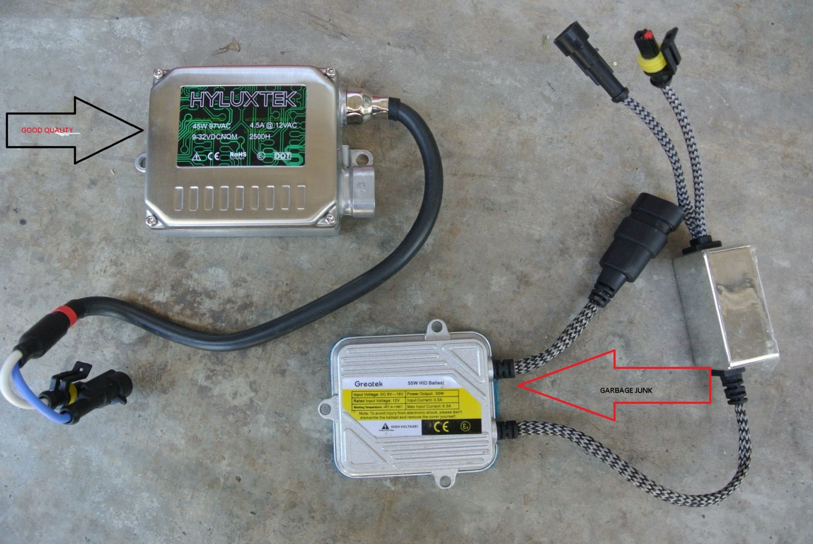

over the course of time I discovered if installed properly HID's work perfectly, the power supplied thru the oem light harness is not enough or is barely enough to fire up a ballast, this causes strain on the oem harness and the fuse block. The best method is to wire fused power directly to the battery with a relay and ground to the frame, then only use the oem light harness as a "trigger" for the relay. this put's no strain on the oem light harness or fuse block. It is best to use good quality relays and ballast's and a good power wire, bulbs not so much they only last so long no matter if you paid $5.00 or $50. A lot of HID kits/ballast's out there are complete garbage they may say 55w but there are in all actuality not even 35w especially the "digital" ballast, you want a nice thick metal ballast see my photo below the one on the left is what you want a nice big thick ballast it weighs 1 lb+, the one on the right is crap garbage and does not even weigh 8oz, yet it says it is 55w, you could plug the same bulb into both, the good ballast will fire up the bulb nice and white the one on the right will make the same bulb look like 10,000-12,000k blue/ purple. If you run a good quality ballast and relay and wire it up properly you wont have any more problems than running any other kind of setup
