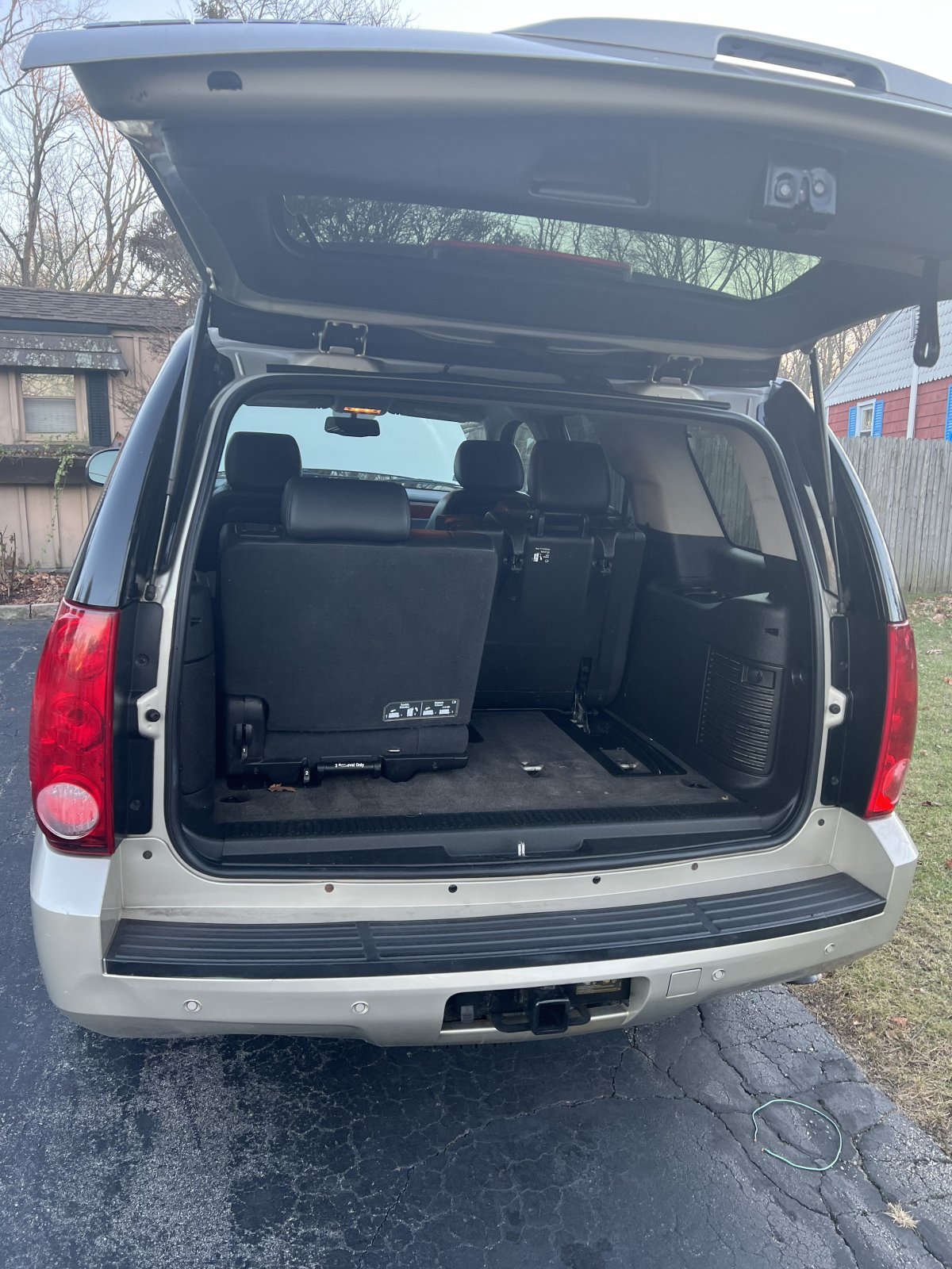

Pics of the truck, please.

lol Thank you. i just finally picked it back up today.... at least it shifts now. on the way home the CEL came on... then started flashing. then a message came across, very low oil pressure stop engine immediately. So, i pull over, shut it off and popped the hood. pulled the stick wiped/replaced, waited and repulled, there is oil on the stick to the full hot. Phew!!
just a bad sensor, i hope. tomorrow i plan on having some service done, including an oil change. i need to get under it and see what i'm dealing with. worse case i'll keep it thru the winter and sell in the spring and make a profit. the prices on these SUVs are skyrocketing. but if its not so bad i was planning on keeping it and putting a stereo in it. i also want a set of 22" snowflakes, like on the newer trucks. 18s just don't look right imho.
****let this be a good lesson for everyone, me too. if it looks too good.... it is. Run away. next time i'll know*******
i'll go take some more pics for ya!!

From the photos, truck looks really clean. The salt corrosion on the aluminum looks recent.
