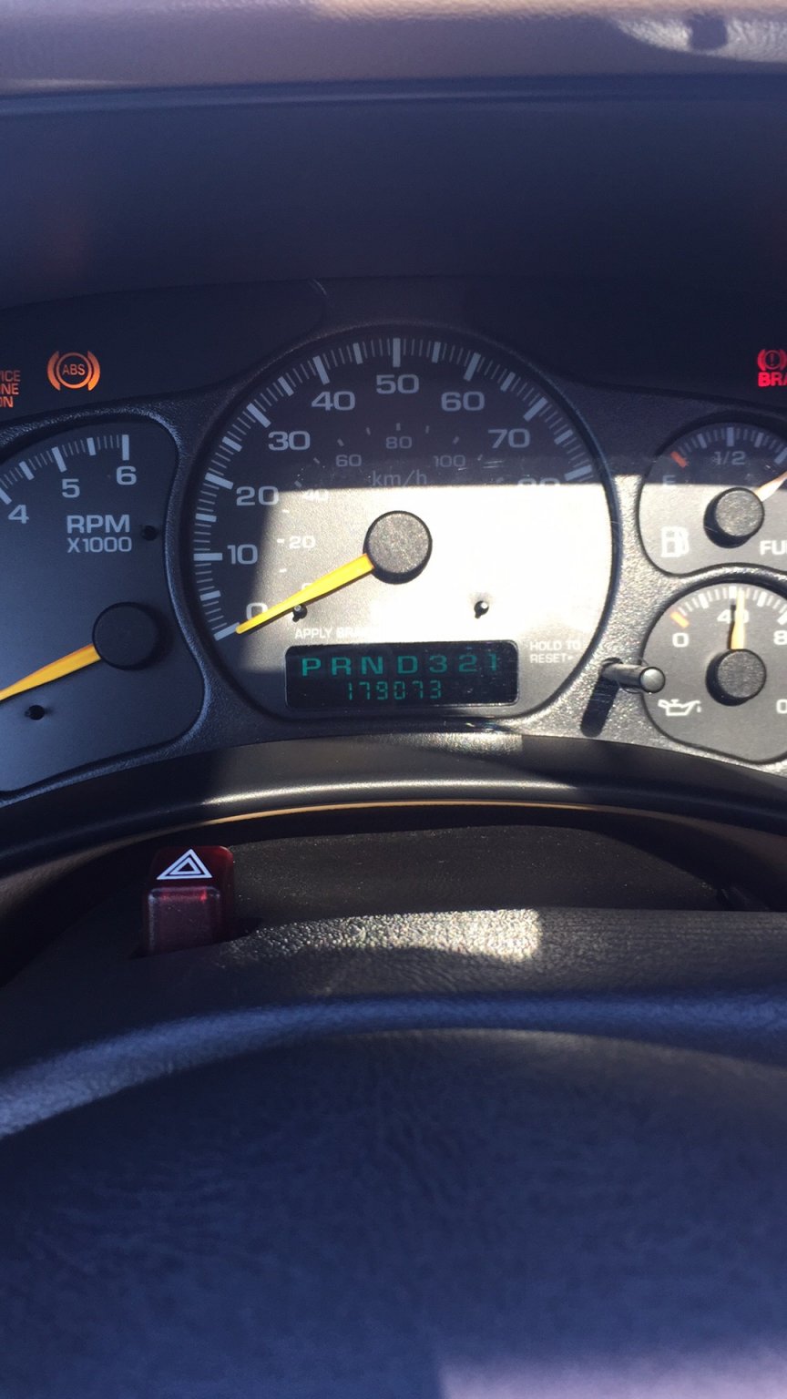

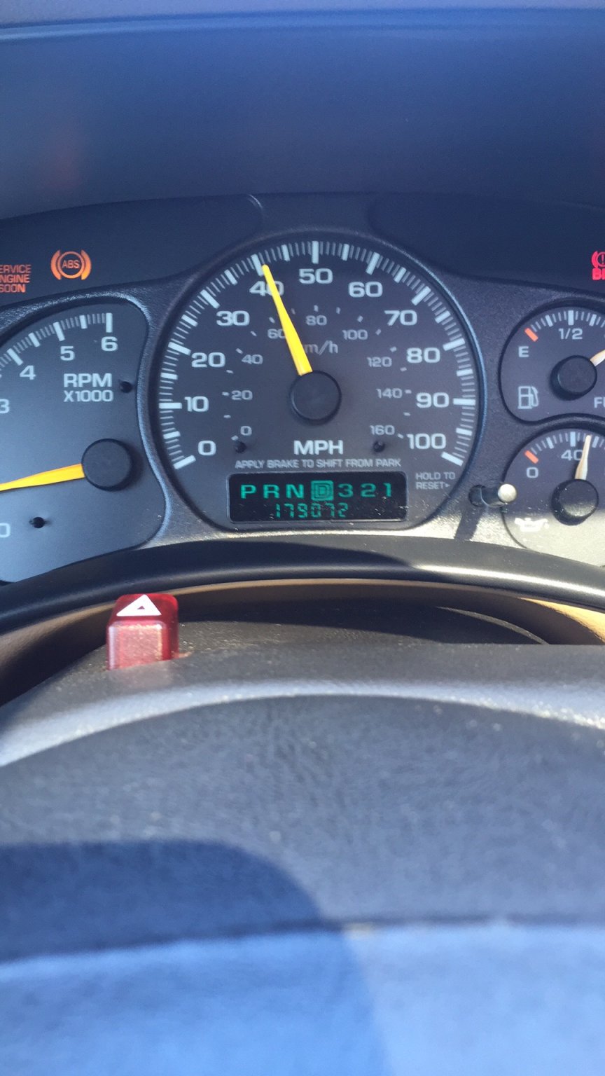

I just got a 2000 Yukon SLT with 179k miles. Decent shape. New trans. Has some issues I need help with. Hopefully this will help.
First. Evap p0449 code
Second. Abs and brake light go on and off.
Third. 4lo won't engage. Yes it's in neutral but don't think the truck knows it's in park or neutral. Neutral safety switch maybe.
Forth. New trans has a small leak can't trace yet.
Fifth. Power mirrors barely work. New switch maybe?
Over all a nice running truck and looks good for a 2000 but I need these issues fixed. Hopefully y'all can help

How are you making out with this ? I have ran into the Evap code before. Could be one of two thing that I have changed. The sensor on the tank or solinoid on the intake and gas cap. That was three oops. Abs could be a bearing and the leak. Need pics. More than likely a cooler line.
