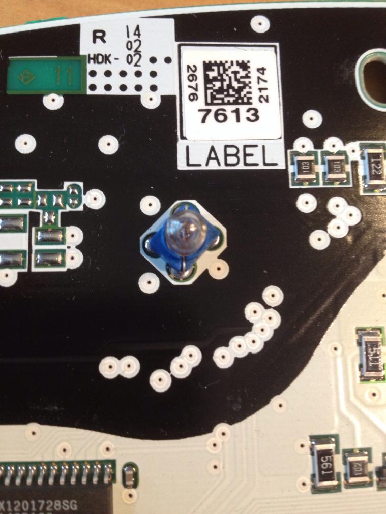

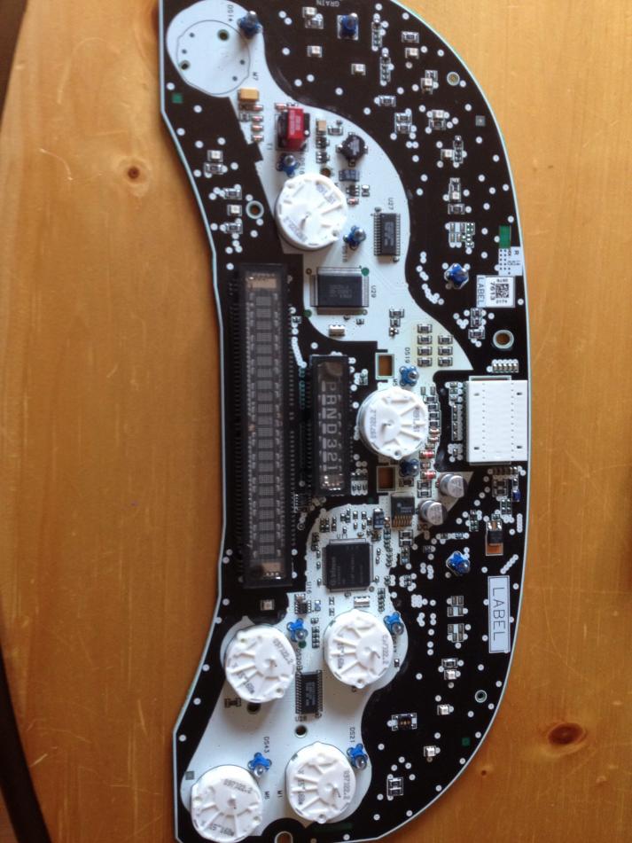

So the LED I bought were wrong. Attached is what the dash looks like
