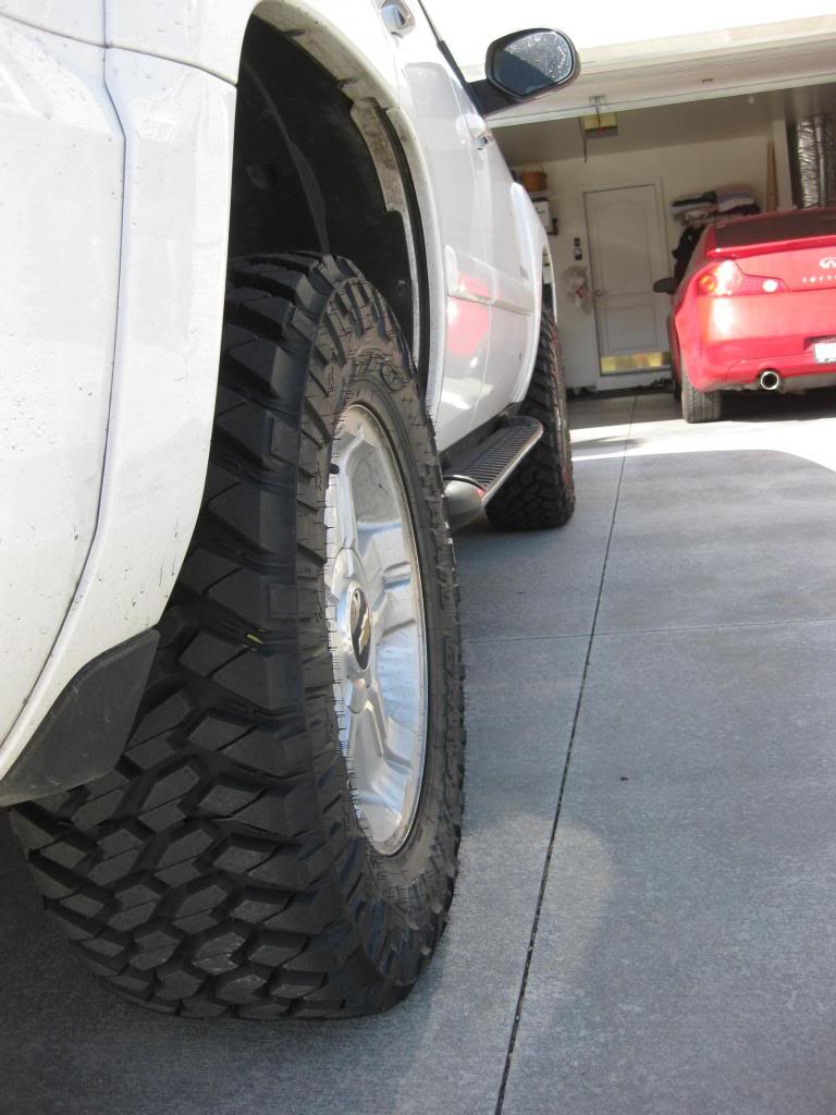

The first post of this thread indicated you wanted to go 265/70 or 75. Is width or height more important?
305 width at ~33 inches would be the largest tire I would go with just like InTruck indicated (which took a lot of trimming). On the stock 18s you could go wider than 285 but stay at 33 inches in diameter. This is all based on the threads I have read. If you stay below that threshold you should be ok to install and trim as required.
Here's what will be needed at a minimum (wider that 285s at ~33" diameter). In addition, the rear of the wheel well mosly likely require trimming and then both ends of the wheel well will need to be tied off. Another way is just to take off the bottom valence pieces of the front bumper, remove the side step valence, and tie back.
Good luck and post pics.
