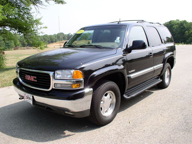

I bought my 2003 Yukon about 5 years ago with BRAND NEW tires on it. Those finally got close to wearing out about a year ago, so I found some new wheels on Craiglist with decent tread on them, but somewhat dried out tires. Those are now worn out and it's time to get new tires.
Here's the original wheels..
Here are the new wheels...
SO....
Stock tires according to the spare, and the door jamb sticker is 265/75/16. Current tires are a 245/75/17. Will a new set of 265/70/17's actually fit on the new wheels? I know we're only talking a 20mm increase in section width, but I'm concerned that I've bought wheels that are too skinny for these tires. Is there a better size I should be considering? Truck is mainly a daily driver, with some light off-road work (family farmland moving trailers/wagons/etc from time to time). Clearance and traction has never been an issue, and the speedo has ALWAYS been off by a linear 5mph since I bought the truck.
