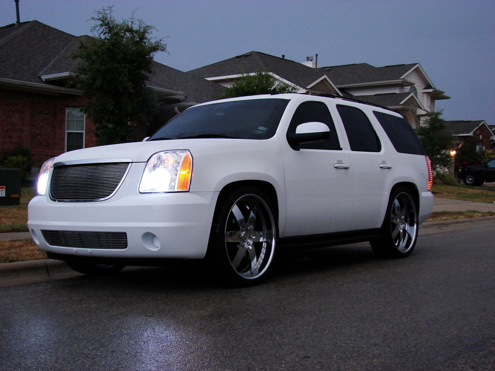

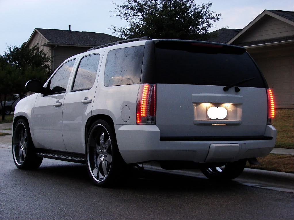

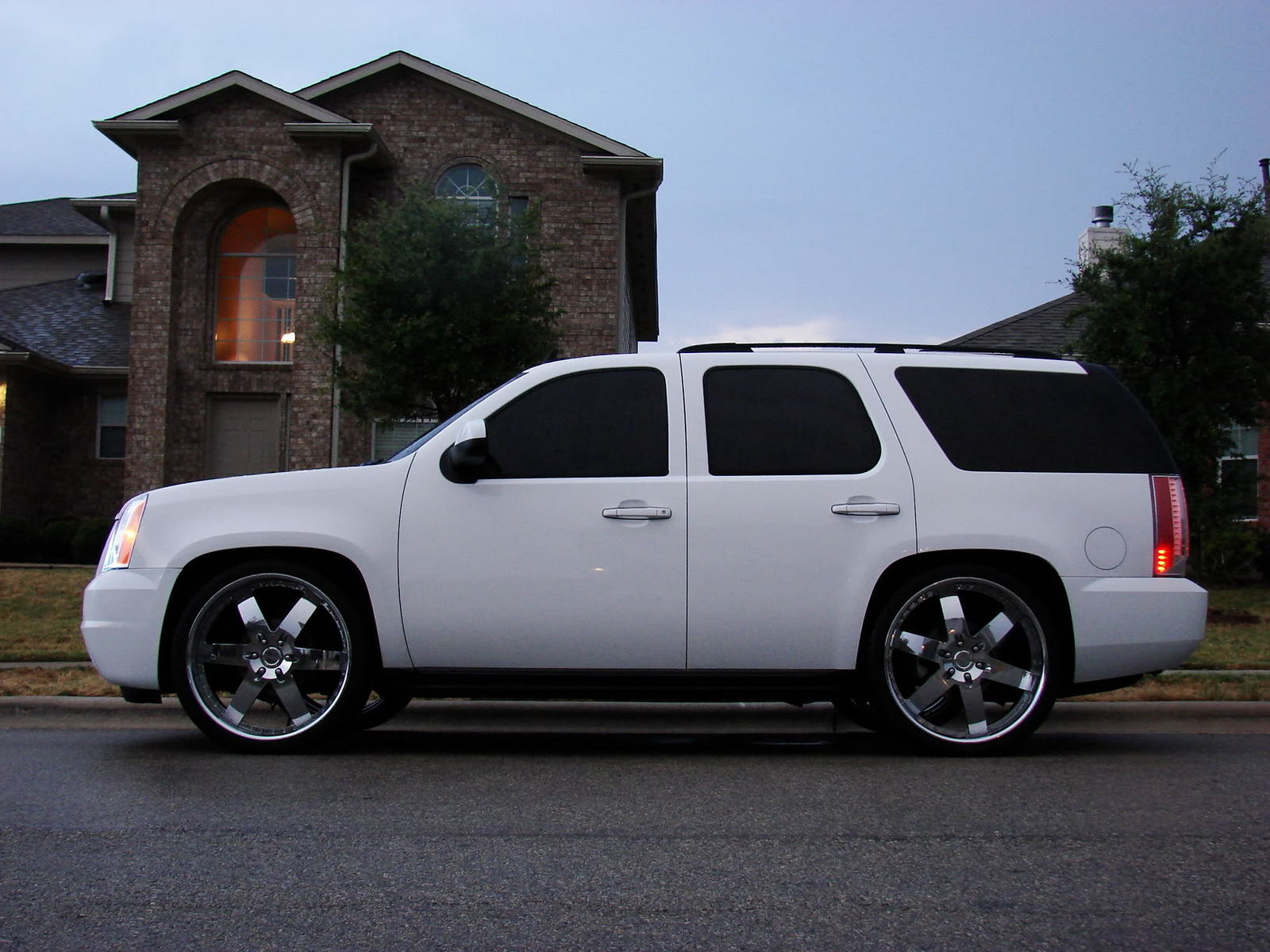

I went with the Bell Tech 739SP kit and the only custom work involved trimming and using a heat gun to re-shape the plastic fender liners. The front fender lips behind the tires also needed to be slightly massaged with a rubber mallet. If you have shorter tires than my 305/30/26's the rubbing should be less of an issue... Here are pics of mine at 3/4.5
