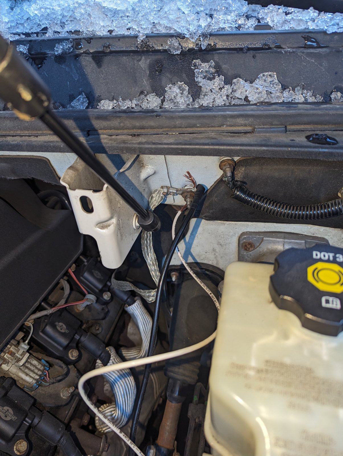

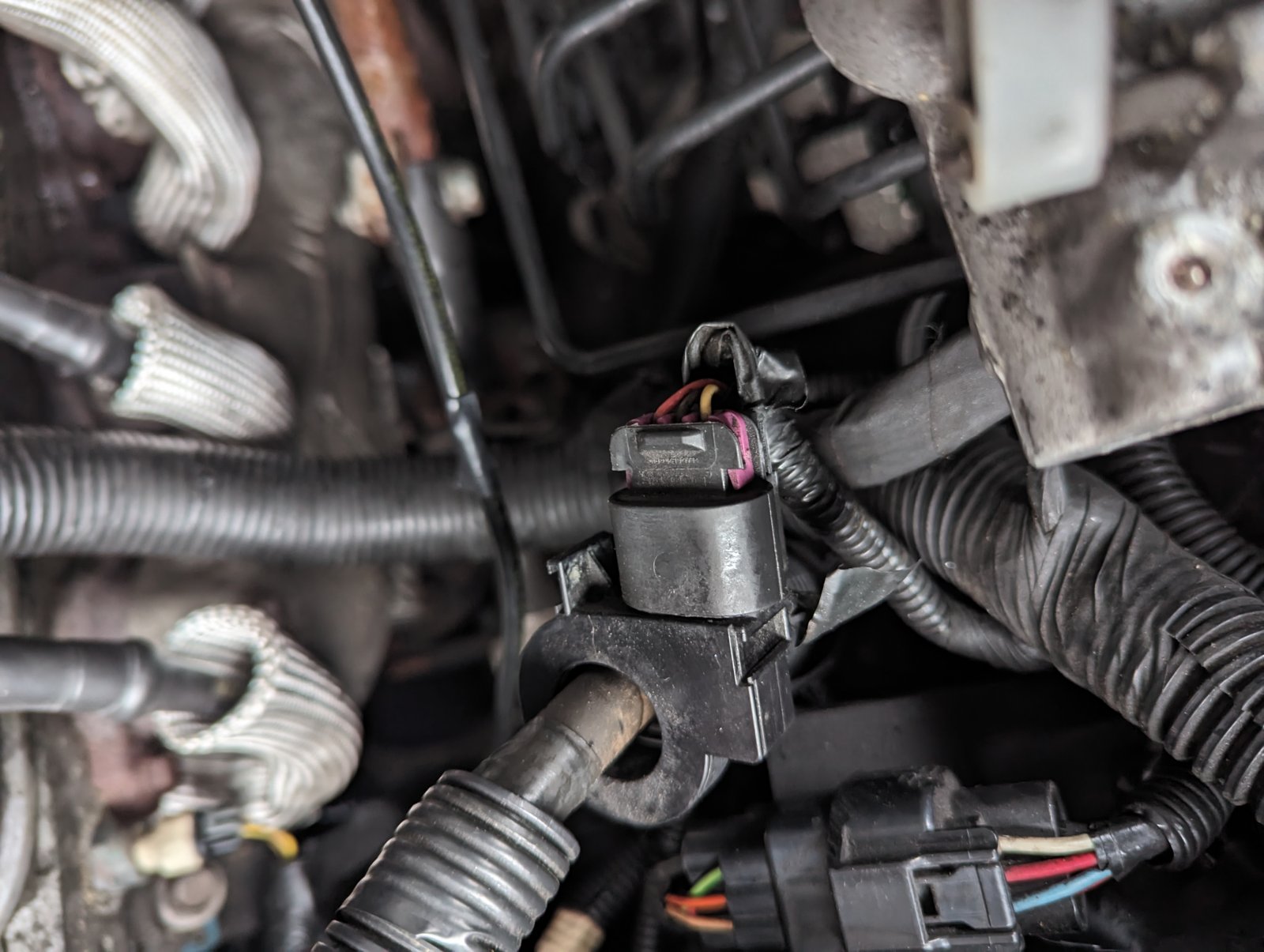

Ok, so what I've done here. Looks stupid but I wanted to make sure it worth drilling. So I connected to top arm mounting bolt. Nothing literally nothing, when ingnition is off no Abs light, when ignition is on no Abs light, only when I press brake pedal. And after I turn it ignition off it cycles, and repeat same thing. I spoke with PA Auto Would, the guys that sold me this trash. I broke right after service contact expired. Maybe I should talk to Westlake Financial, maybe there can take it back. Thought I have 9 k and 3 years to go. But for real I don't want to deal with this truck anymore. Repair probably would cost another 2500$.

I would be completely tired of it and frustratied too. I keep hoping you'll stumbled only a reason it doesn't have power to the brake system. did you ever get a chance to test power at the main fuse running to it while hitting the brakes. see if it hold up 12v or better under load.
there's also the ground for the brake module under the chassis at the cross member somewhere. if that is bad, even if the chassis to battery you're doing is good, that connection is how the brake module gets its ground. it's a long shot and I'm sure horrible to try and find under it.
