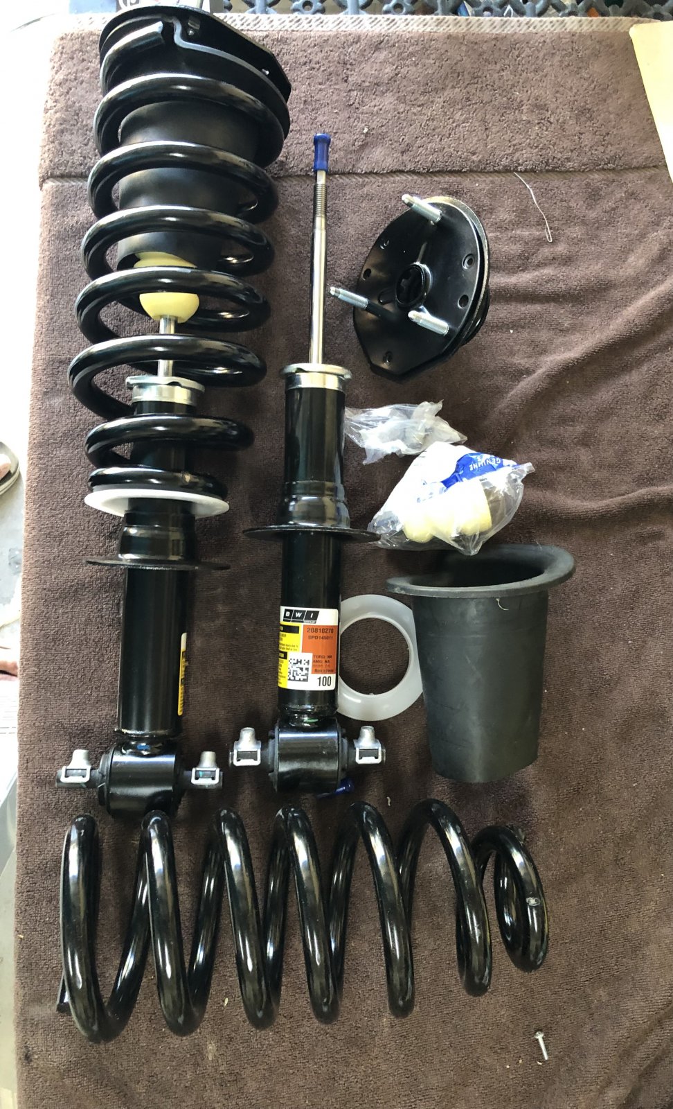

All taken care of guys and appreciate the help. I ended up getting a set of moog front coil springs#81254 direct fit for my RWD z55 suspension.
looking forward to the final piece of my suspension rebuild.

On a side note I ended up buying all the parts for a complete new coil over strut. With 130k on the clock (I’m original owner but still lot of miles) figured I’d go ahead and buy all new springs, strut mount, bumpers, insulators spring seat and hardware. Wasn’t too bad getting all parts but double check your oem strut mount and spring seat part #’s. The had the wrong spring seat part listed thru gm even with vin search.

Posting this as it may help someone
If your replacing the strut mounts and it’s GM part# 25940743 (I got mine on Amazon for 22.00 aftermarket part)
the correct and matching spring seat is part# 25940742 or 84061243 (same part)
I had multiple GM part suppliers try to tell me it was #15803177 which does not fit the above strut mount.
Also the correct top nut part# for my 2011 Yukon Denali (Z55 6ya,7ya) is
Gm part# 15815577
Hope that helps others!
