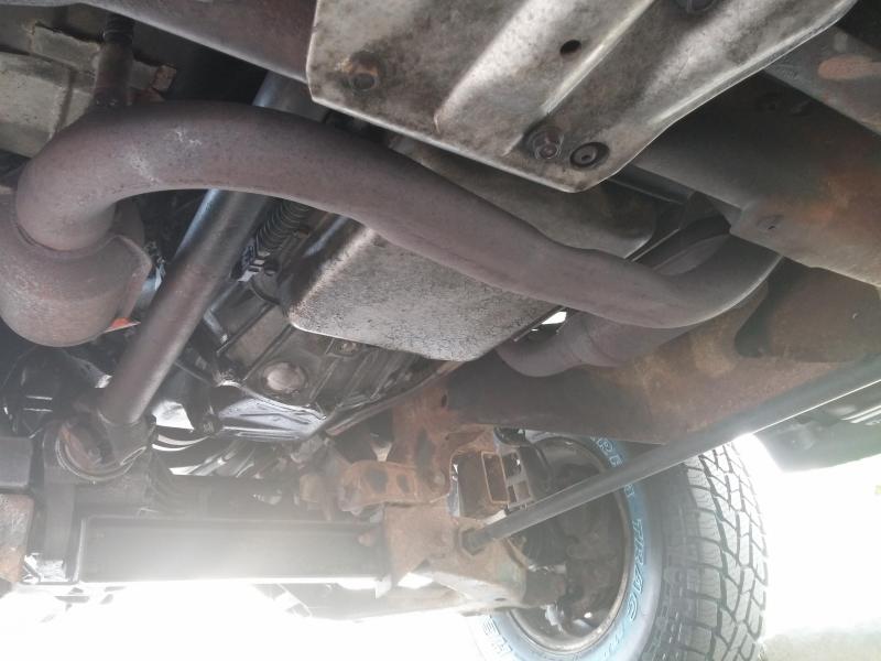

hello,
i am trying to replace my cat.but every picture i see that says is a direct fit does not look like my setup.all pictures show 2 cats under the passenger side of the truck but my truck has a driver side and a passenger side cat.reason i am looking at cats is because i am getting code p0430.
can anyone help me figure out what cat i need?
1998 gmc yukon 4x4 slt 4 dr

If you follow the exhaust down from the engine, the OEM setup has both tubes going to the passenger side. Each tube has it's own cat. The tubes then go into a "Y" and then into a single muffler.
Does yours not look like this? If not, the previous owner may have altered the system.

this is my setup from the rear looking forward.i have a cat that sits under the driver seat and the passenger seat.but the pics of the replacements have both cats sitting under the passenger side
BirchyBoy
Jul 21, 2013
548
Mine is a stock '99 and does not have the cat to the left of the drive shaft like yours does. It's possible that there are different setups, though. Hopefully someone here will know for sure.

on my 2002 the cats are right after the headers

Is that a 6" suspension lift?
Drivers side may have been re-routed due to the front drive shaft being lowered.

so this does not seem like a stock catalytic converter setup?

on most tahoes ive seen there is even an exhaust installation wright up and you can see the cats are right behind the headers i know this because they were hell to get off

i live in nj and i only have emission inspection.but i am getting a engine code p0430.if i get a o2 simulator will that take the code away?how do they work and is there a brand i should get.will i pass inspection with them in?

unknown at this time.
that setup might be a california converter setup that i think was implemented i think starting in 1998. i saw the same thing in the 2000 limited 2wd units. assuming nothing changed in the area where the original setup went then the old style should fit. there might be concerns tho with the o2 locations that might be slightly different and may need longer or shorter wiring. you likely would not get dinged either by a smog shop because is will look like a factory mounting position.

i live in NJ but when i checked the carfax i believe it was purchased in Cali and registered there for the first few years.
if i am throwing code p0430 could that be for anything else besides a bad catalytic converter?

On My 2000 yukon xl 5,3 4 WD i have similar as you. My is imported from us Florida i think. And i have seen "cats" that fit mine on ebay.

On My obd scanner i can see o2 sensors and do a diagnostic on them to see wich is bad, dont know if it works for you. I bought a scanner on ebay and it seams to work quiet good.
