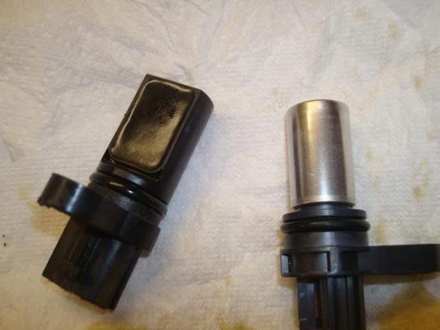

If its cranking (turning over) but not actually starting, it might be the crank sensor I mentioned above. Here is a picture I took when I replaced mine. The old one is on the left and the new one is on the right. If you go to buy one at a parts store and it looks like the one on the left, DO NOT BUY IT. You want the new style with the metal cap.
---------- Post added at 10:53 AM ---------- Previous post was at 10:47 AM ----------
Ok, I found the link to the write up on the Nissan forums. I followed this write up and had both the crank and cam sensor replaced in about 30 minutes.
http://www.nissanclub.com/forums/f-...haft-position-sensor-cps-2006-2-5-altima.html
Thanks for the link and write-up. Just need the knock sensor location.
I was reading thru other members post on the forum and the car does not buck at all. Runs flawlessly while driving all speeds and conditions.
I know a crank sensor can go bad and cause any vehicle not to crank.
I am going to pull the orignal one see if it has melted. Is there anyway to test it? I know there is a way to test if it still functional. Need a multi-meter and if the ohms are infinite then the sensor is no good. Thats old school, wonder if this will work on newer make and models!
Once again THANKS FOR ALL YOUR HELP SO FAR!n (everyone!)
