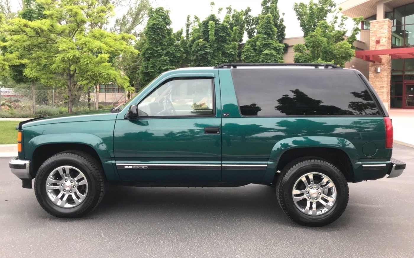

Squirrelsmith
Jan 21, 2018
914
790
20s off a 2015 silverado ltz

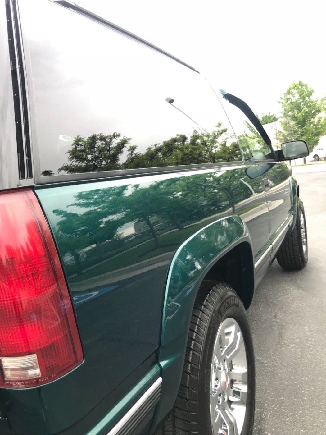

fastpat
Jun 2, 2018
163
71
Upcountry South Carolina
My '95 Yukon came with 18x8 late model wheels installed. They look like OEM, fitting completely inside the wheel wells. In fact, I thought they were stock from the photos. I'd recommend them, though I don't know the offset, it's obvious that it's correct because they don't project beyond the wheel wells.
