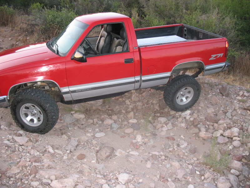

You can do it. I did it in my OBS. There wil be NO problems with the seat belts. I'll find some pictures for you. Well I know the from will work, I dont know about the rear.
---------- Post added at 11:55 PM ---------- Previous post was at 11:49 PM ----------
Here are some pictures

Cartwright what are those NBS seats out of? They look great. And it would go with my black carpet / tan dashboard.
