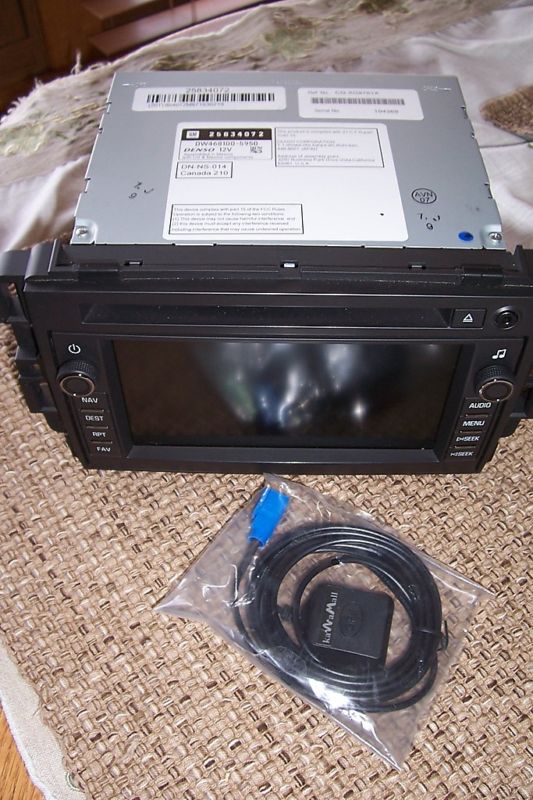

So I just picked up a oem nav system on ebay and had a few questions I was hoping you all can help with. Included in the auction I won was;
OEM Nav System (part #: 25834072)

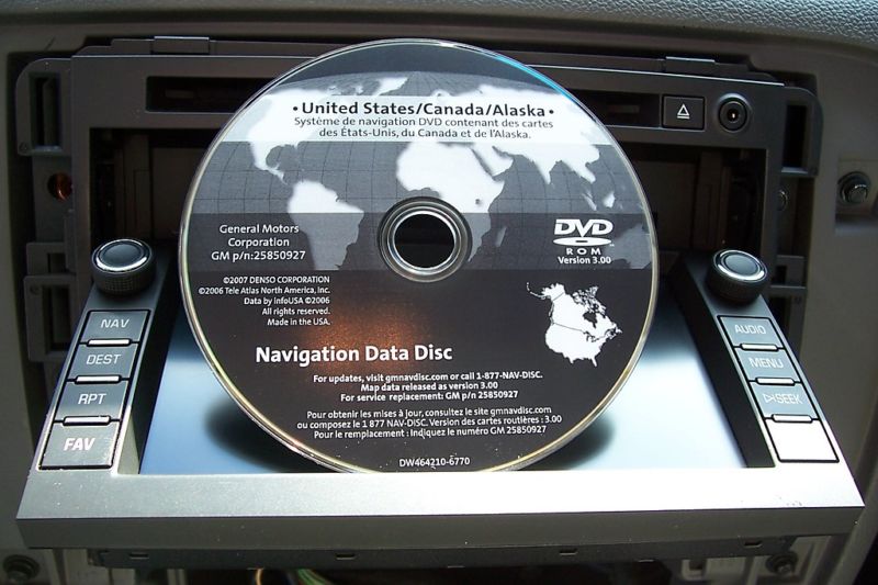

Nav Data Disc Version 3.0 (part #: 25850927)
GPS Antenna (not sure of part number)
Not sure if it matters but I have an 07 Tahoe LS (non-bose).
So to my questions...
Pretty much in general I just want to know what I'll need and maybe some problems or hurdles that are common...but more specifically,
1. Is there anything that I'll need to get before the install? I plan on taking it to someone to actually install it, but I want to make sure I have everything the guy will need.
2. What is the most current Nav Disc that I can upgrade to?
Thanks in advance.
F
FLtahoe
Apr 1, 2010
180
Florida, USA

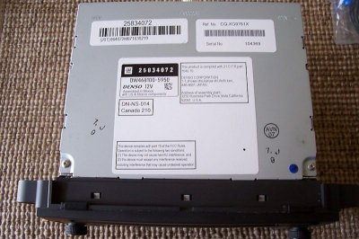

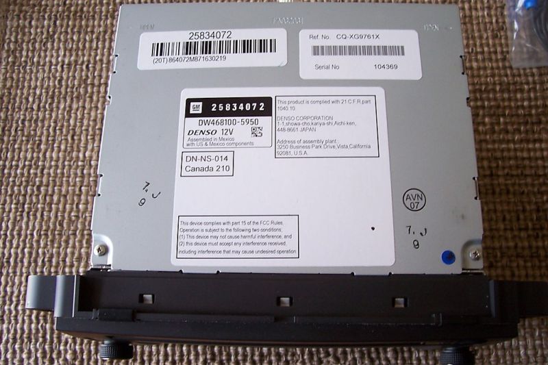

Not sure if it matters but it is listed as an OEM Denso Navigation from an 07 Silverado LTZ. Pictures below.
