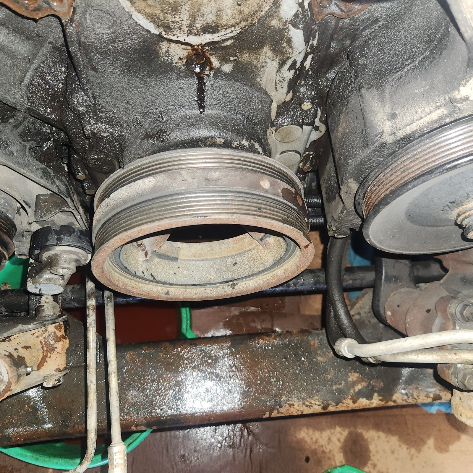

20240515_125402.jpg20240515_125452.jpg20240515_125452.jpg20240515_125452.jpg20240515_125452.jpg20240515_125402.jpg

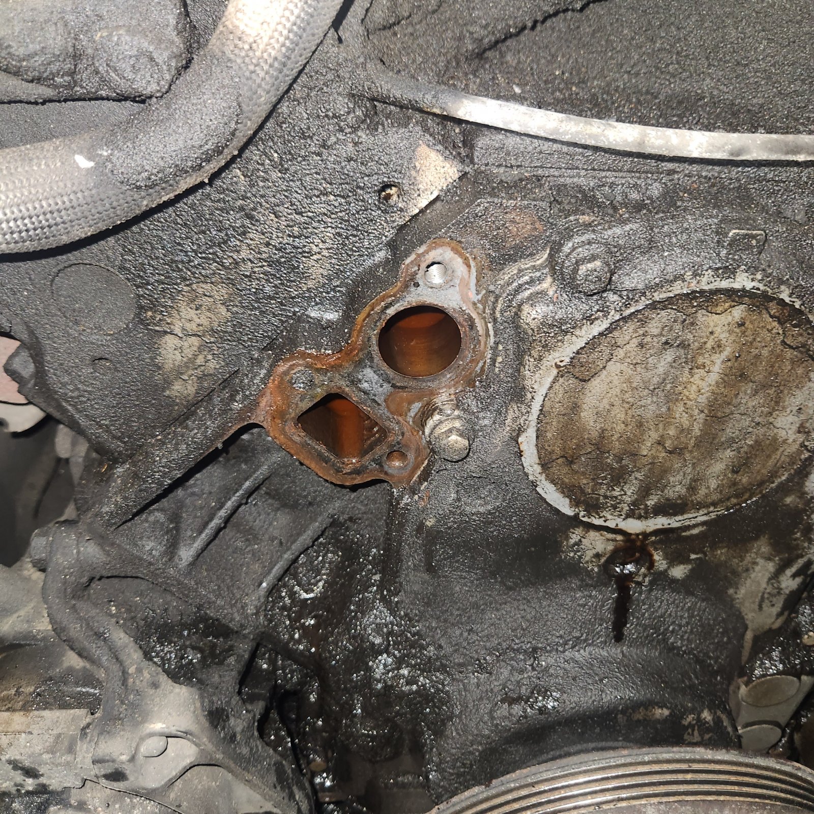

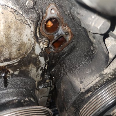

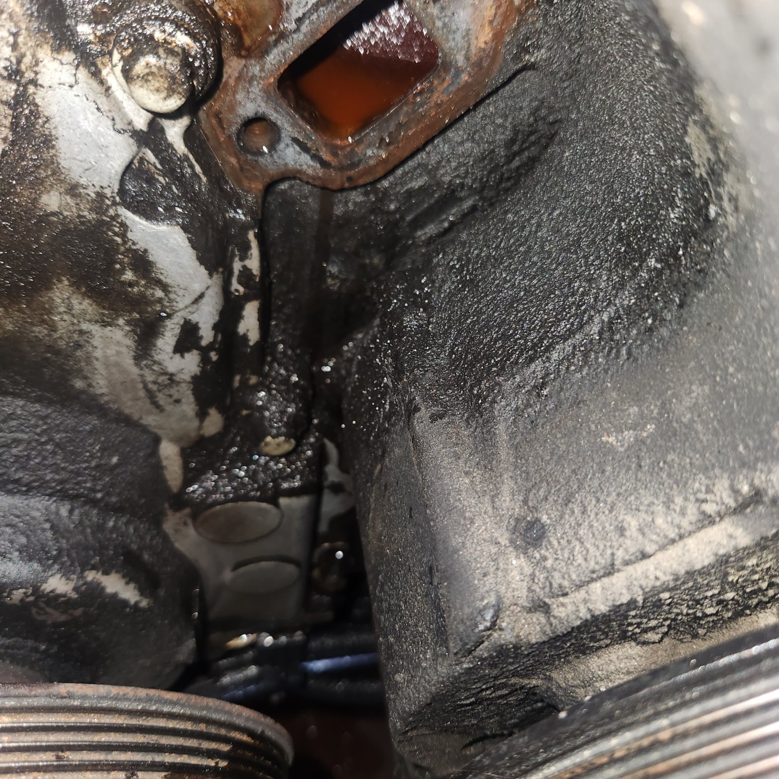

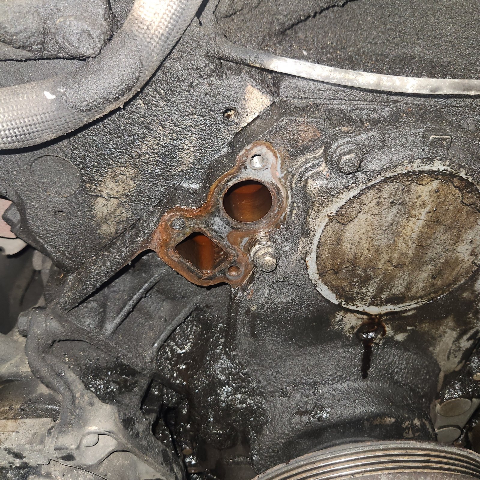

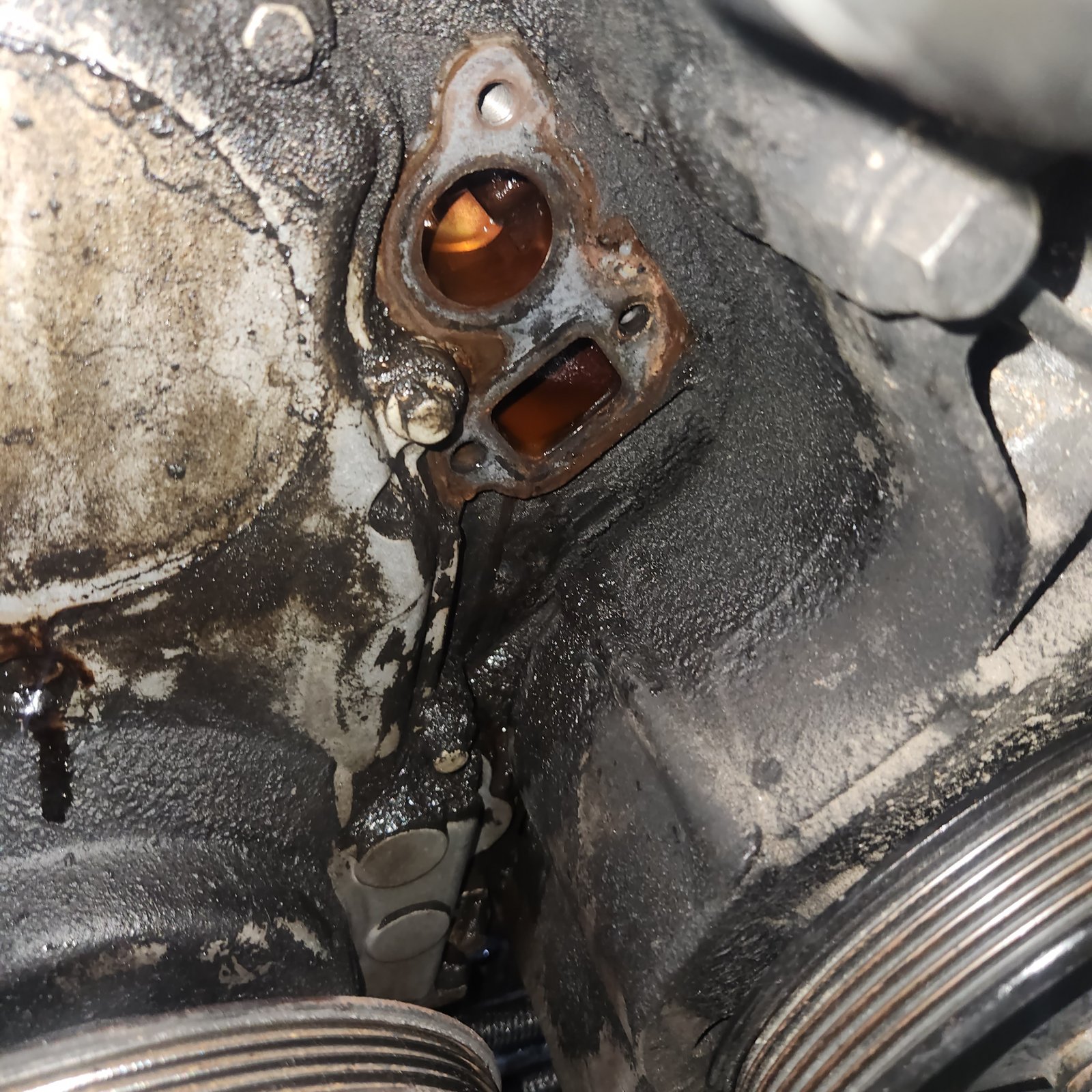

Instigator01
May 14, 2024
16
Looks like I found the problem.Driver side water pump connection was leaking.You can see in the picture how it's cleaned the front of the timing chain cover.
I must not have got the pan gasket on correctly And coolant leaked into whatever gap there might be.
Still seems odd.There was no sign of coolant leak but it seems the picture shows It might have been a pretty steady flow.
Once I Pull the motor I'll inspect that pan gasket and see where I screwed up.
Seems like the only way coolant could have got into that pan.
I will do a follow up once I get more information.
Anybody have any thoughts?
