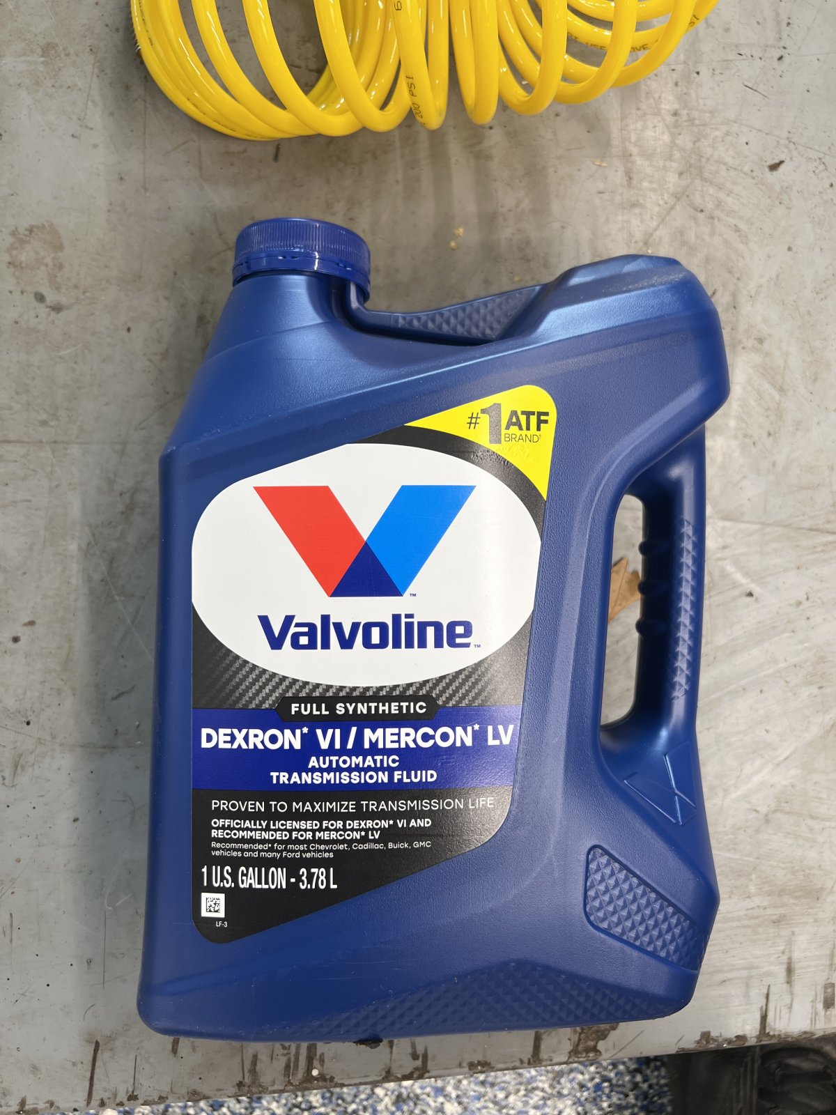

So I removed 4 Quarts of trans fluid and I have a gallon of Valvoline Full Synthetic Oil, that should be mixing it with what I have there now ?
