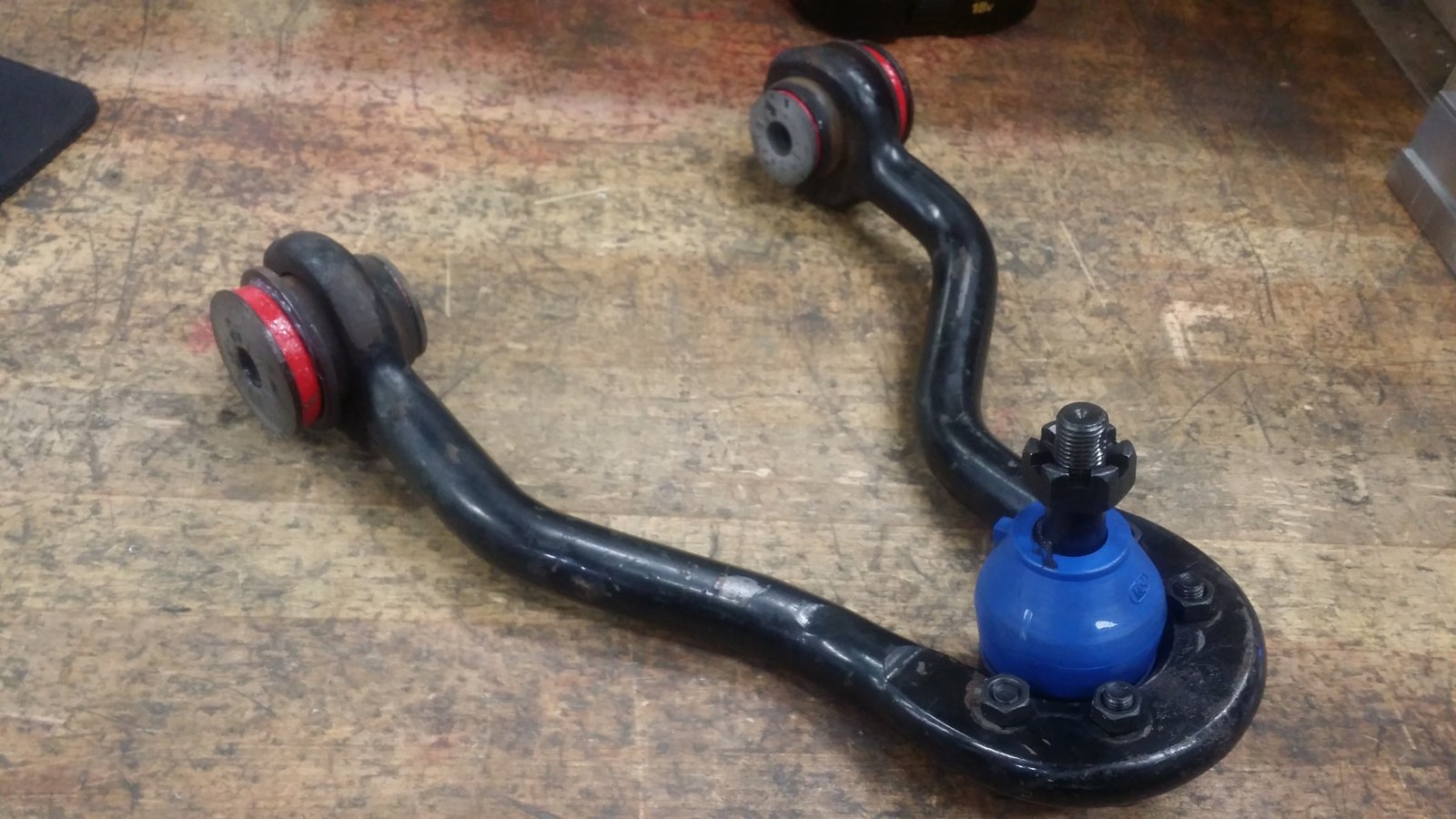

finally pressed out the upper ball joint bushing rivets. no big deal only took milling the heads off on a bridgeport and 4000 psi on a hydraulic press. Anyone that pulls this off in their home garage is some sort of wizard. I am not having a very fun time with this project.

Just burned the bushings out of my upper controll arms and i mean BURNED! There was no heat it up to brake the bond then press it out. It took massive heat and just blew that old shit bushing out

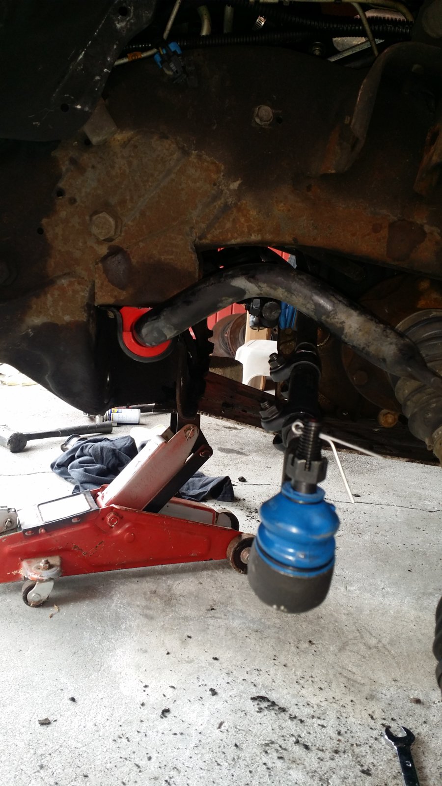

Here is a pic. Im on the home stretch

Pic of the mornings progress. Just have to press in the lower ball joint tonight at work then i'm ready for re assembly
