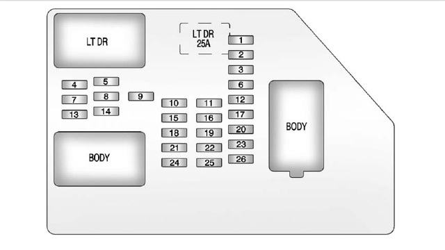

Check the fuse. #14 on the dash fuse panel is for power mirror

Does all the other switches on the door work (windows, locks, mirror adjust)?
There is a fuse for the drivers door module, not sure what all that controls, but it's #4

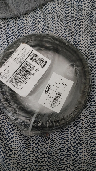

Just got my stuff in to fix my yukon. I am removing the poor ground for the battery with new #2 guage cable and other ground under the hood. As well the transgo is to fix the soft shifting my yukon has had. I have to let off the throttle to get it to shift.
I was informed to use welding cable as some automotive supply places will have copper coated aluminium. This stuff will withstand 2000 amps for just the battery ground. The roll of 20 feet wasn't too bad. About 60 bucks
