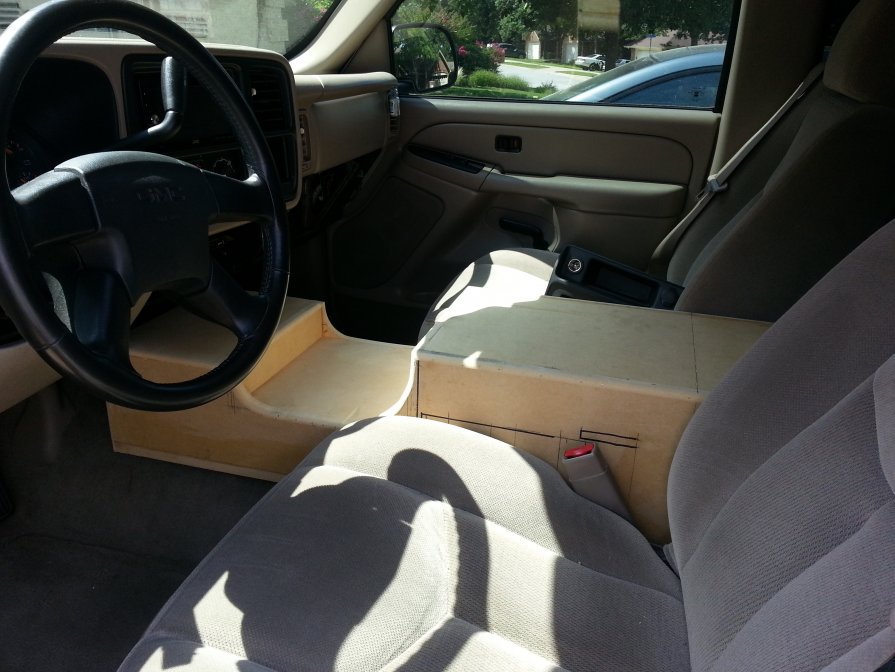

This box would probably fit that 12. So you have room to do it. I could have more airspace for the box but would sacrifice cup holders, and the arm rest storage to do so.
As far as sound goes its awesome. I love having my sub up front and centered lol.

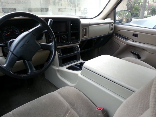

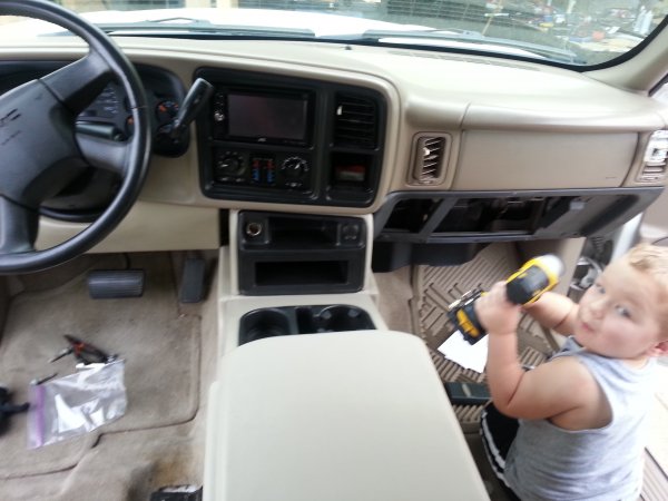

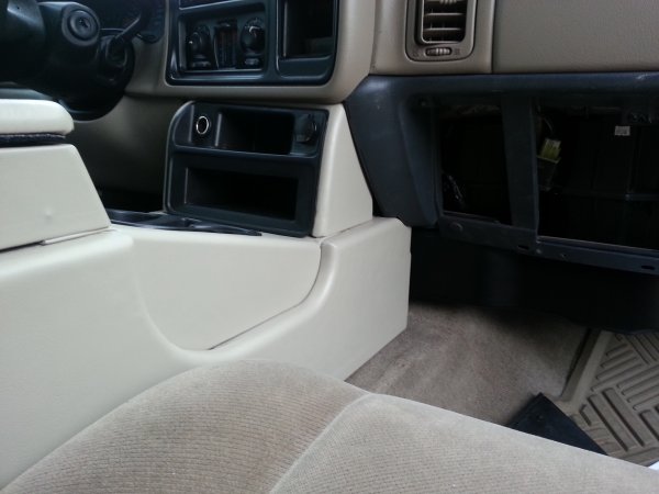

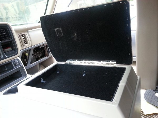

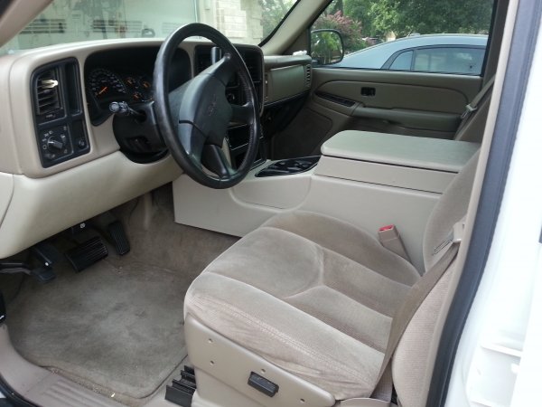

Here it is... Not completely done, but mostly. About the best I could do with the limited time I have.
Still need to make a filler piece for the drivers side lower dash where it meets the console.
Also need to paint the passenger lower dash panel and reinstall my glove box.

Looks good man, tad high looking, but very nice.

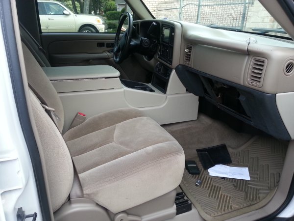

Thanks alot guys. I'm really happy with it.
It is a tad higher than planned, but being 6'2" it's actually more comfortable than the jump seat console was. I don't seem to slouch as much while driving.
Again keep in mind it has my 600w rms RE audio 10 in it. 1.25 cuft. After sub and port displacements. It is tuned to 30hz. Gross volume is actually 1.7 cuft. So it was alot of work to make everything work together.

Yeah at 6' 2 that is probably alot better for you.
I like it though, very creative and your pretty darn handy.

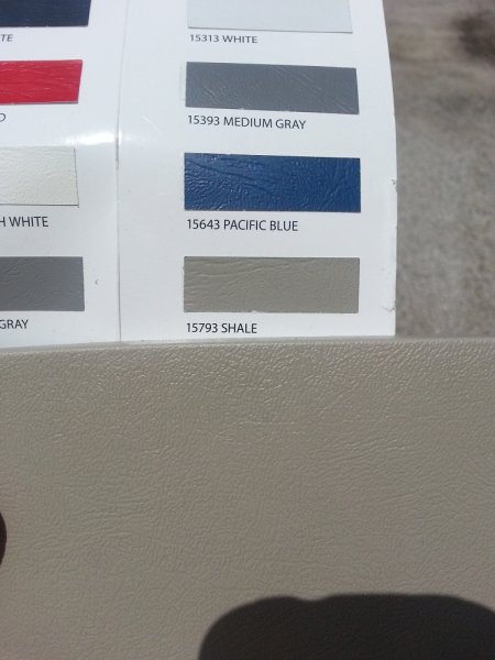

Thanks alot man. Well not much to update, just painted the passenger side lower dash and the color was off a little bit... But ah well lol. One of these days it will get repainted.
