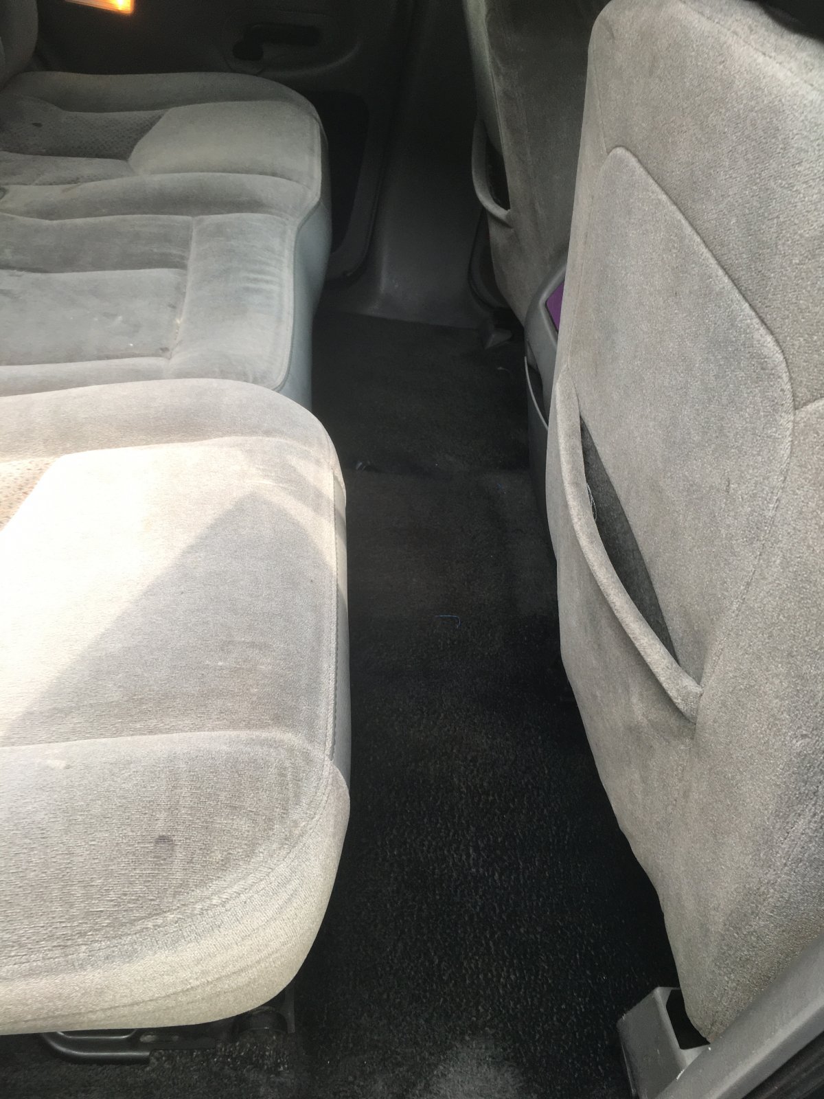

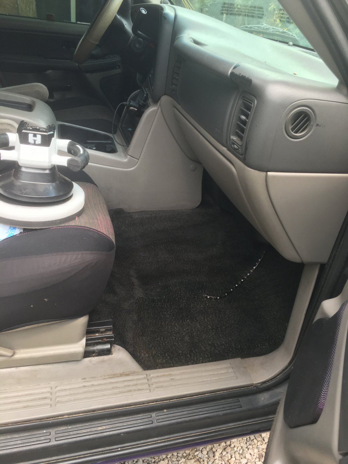

It's been a while since I have been active on here. Life has been hectic! I hope everyone out there is safe, and hanging in there through all this.
Now, my '03 Tahoe was never a show stopper, blah blah. But, it did look good. But I often found myself staring at the stains in the carpet. Now, after hauling around all 5 of my kids for the last few years, its gotten its fair share of stains, dings, dents, and scratches. But nothing bothered me more than the ugly stains on the carpet. So I set off trying to clean it up a bit.
After multiple cleaners, sprays, soaks, scrubs, nothing was working. It was time for drastic measures. I was going to dye the carpet, black. Here's a few photos of afterwards. I used RIT fabric dye, which is great. And, it doesn't stick to plastics. With that, you can keep a lot of the big stuff inside the car during the process.
It has been about a week since I've finished the front half and so far so good. The cargo area is under construction as of now, and will be getting the same treatment, possibly a little more if I choose to.
I knew it wasn’t going to be perfect, but as long as it didn’t look blotchy I was happy.
Side note: lighting sucks, but I haven’t noticed any lighter/darker spots yet. The cargo area, being a big square will take some time and concentration.

Did you pull the seats and center console to dye everything?

I understand it’s more work, but IMO you should have pulled the seats, console and all the plastic that meets the carpet. I know you said the dye doesn’t stick to plastics, but I can see the stains around the bottom of the parts you didn’t pull. Other than that it looks pretty good.:)
