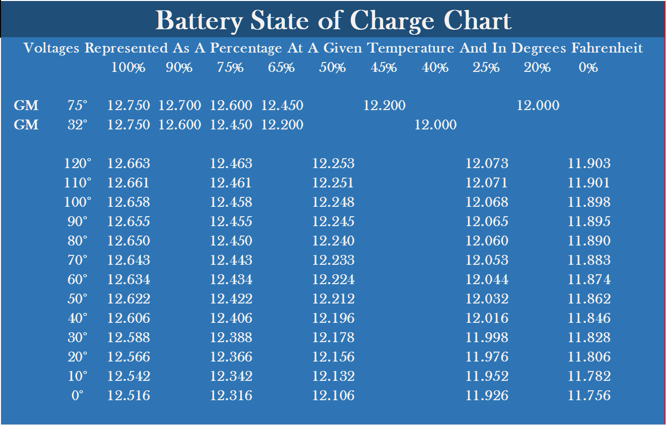

I don't even show that code for my 2009 or 2013. But what I can see is your dead battery at 11.6 volts.
When a battery's state of charge is below 65% after sitting overnight, it's time for replacement.
Most probable. However, if either of the main (pos, neg) battery cables is bad, that could cause a voltage drop between the battery and the fusebox.
