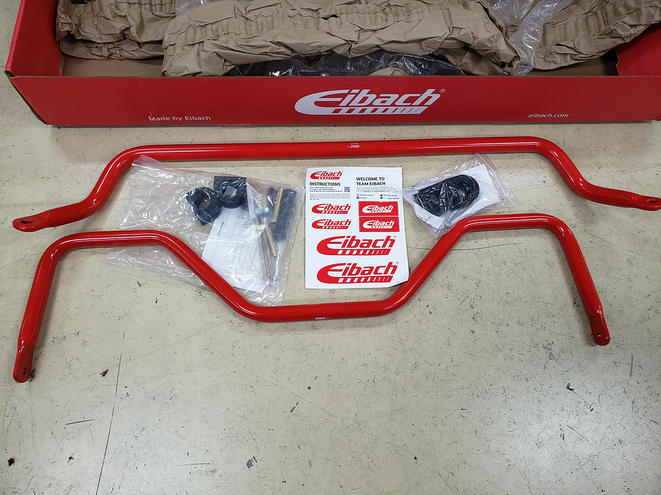

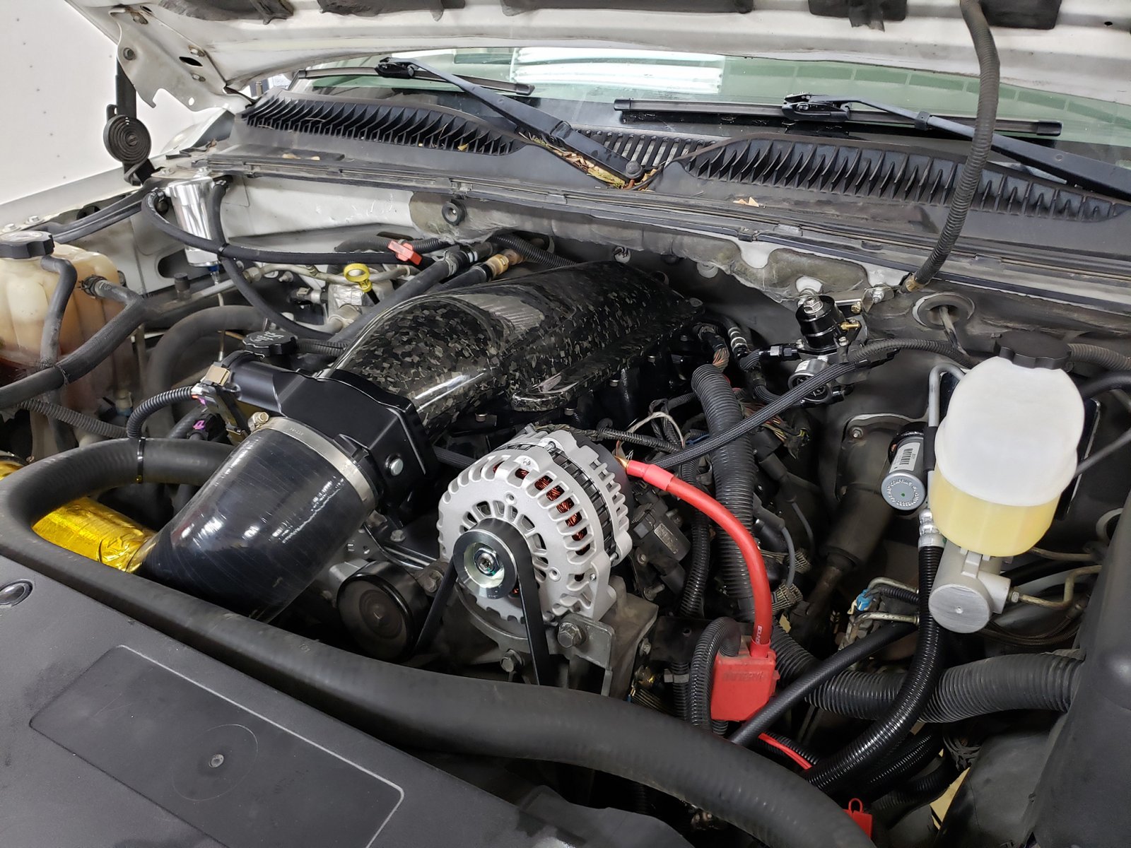

Some more work done lately. Eibach sway bars and did the hydro boost conversion. Hoping to finish it all up this weekend. A couple of more small things then, fluids

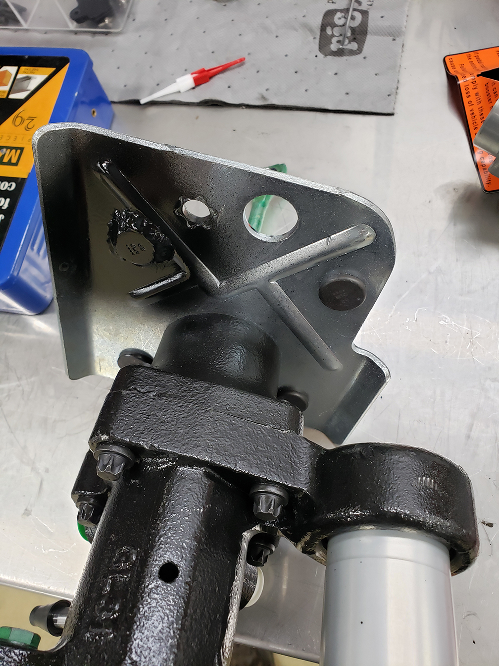

I know, but wasn't thinking about that at the time. I might replace the seat with a sport seat in the future. Something more side support and less weight
26,678
52,942
I used get tunnel vision too sometimes, focused on just the task I wanted to complete and not thinking. Then afterwards I looked back and go “ I could have made that a lot easier on myself”. I’m getting better at thinking things through the older I get and the worse my back is. Just looking at that pic made my back hurt. :mad:

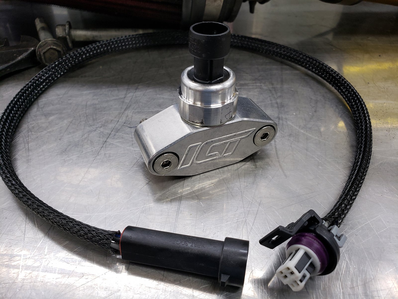

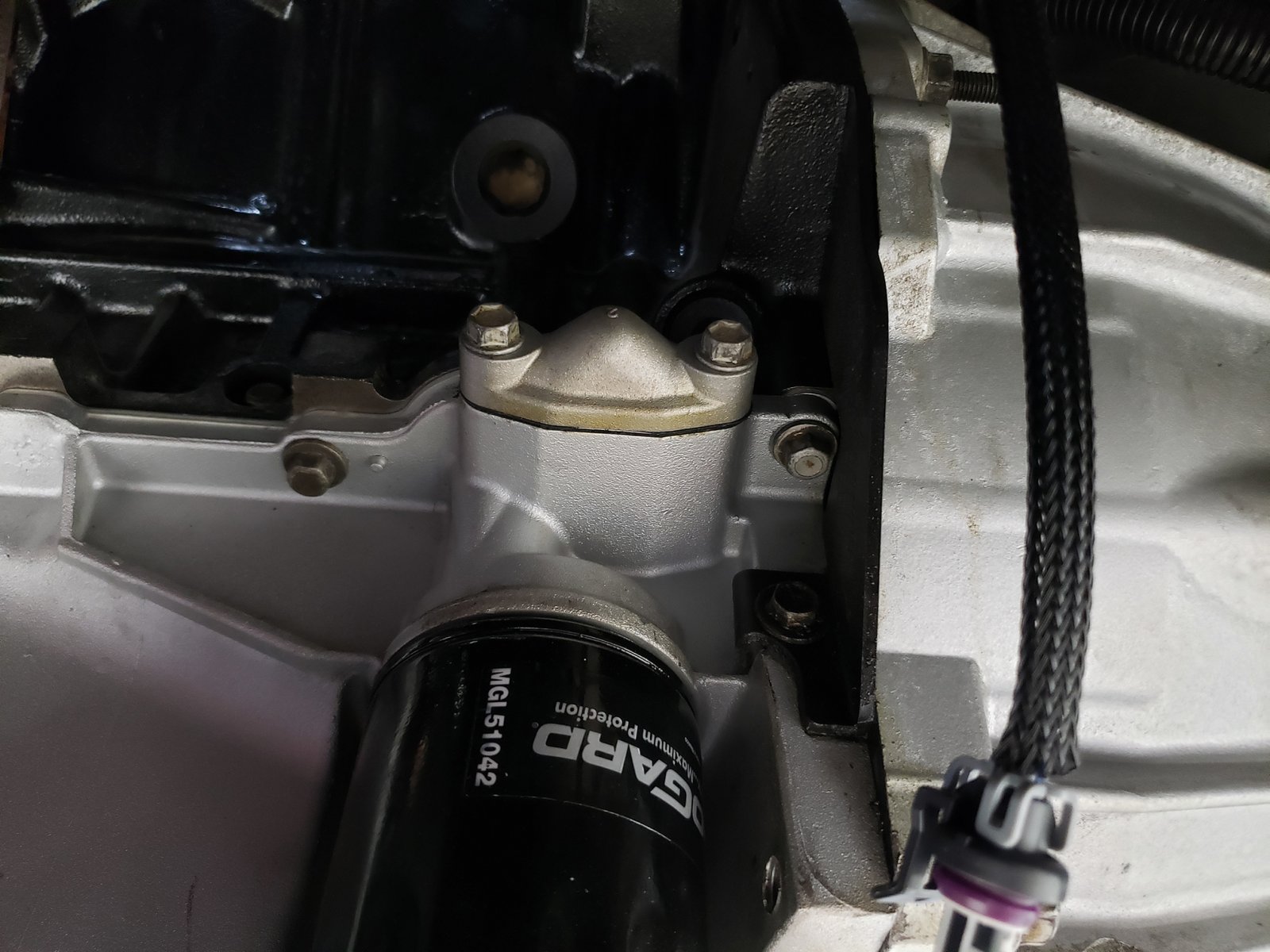

Relocated the oil pressure sensor from the back of the engine to the side of the oil pan where the oil filter is. That way I don't have to remove the intake manifold if I have to change the sensor again. The 2 foot harness extension makes it a simple plug in deal

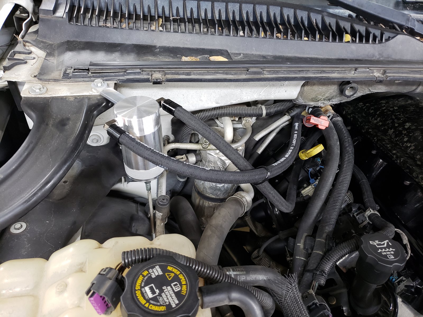

I also installed an oil catch can while I had the intake off
It separates the oil from the air and then reroutes the air back into the intake. At the bottom of the catch can is a drain
After I had done the electric fan conversion I noticed the voltage being a little lower than I was comfortable with at idle. So I ordered a 250 amp alternator and installed that one and now it shows 14+ Volts at idle with the fans running

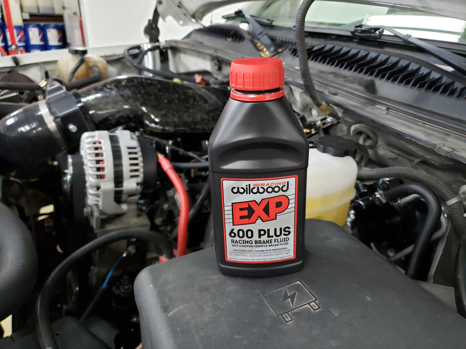

Last on the list was bleeding the newly installed brakes
You don’t need to remove the intake manifold to replace the sensor. Just reach up on top and do it by feel. I’ve done it, it’s not that hard. That’s a nice little adapter though. ICT Billet makes quality stuff.

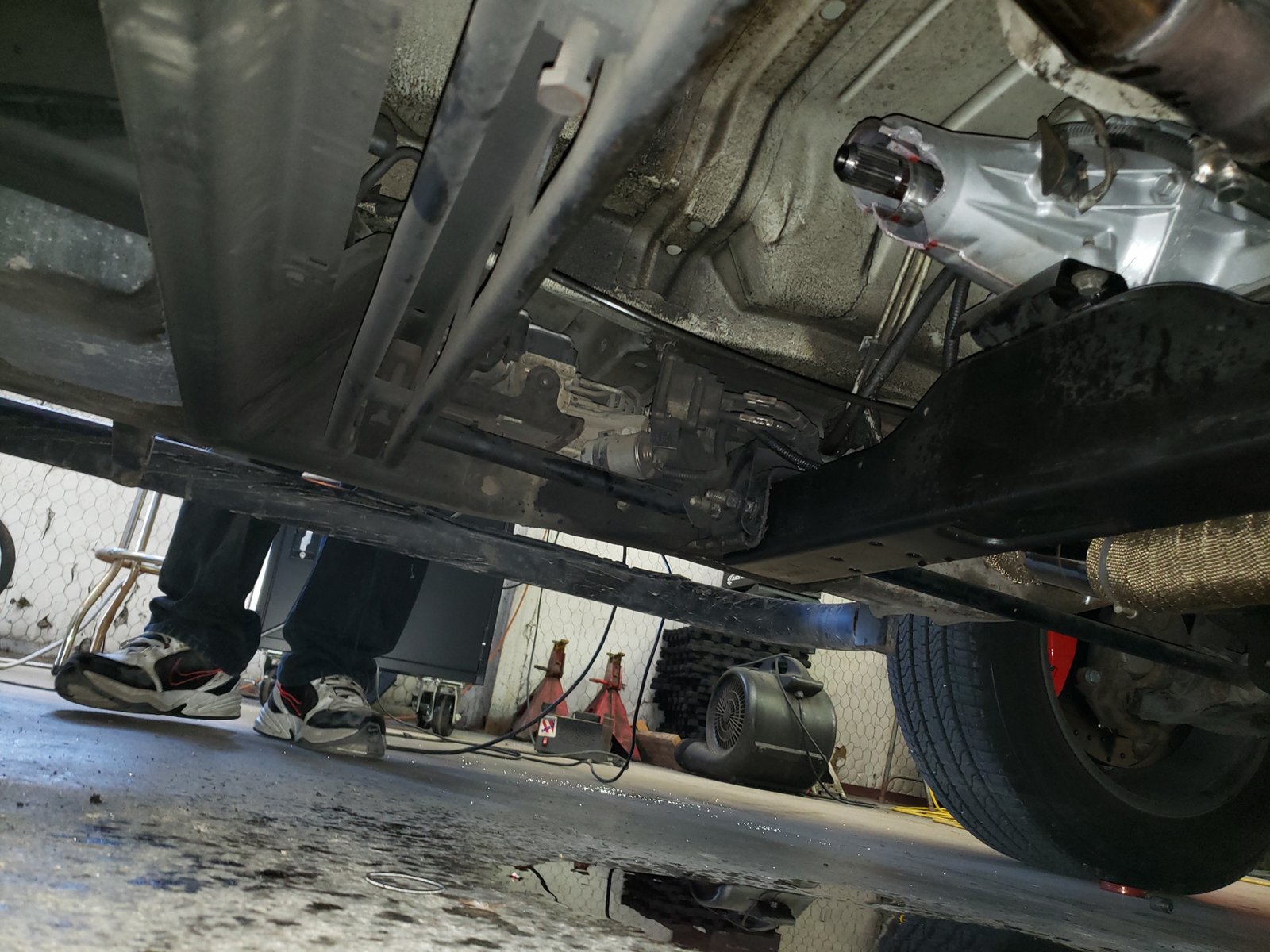

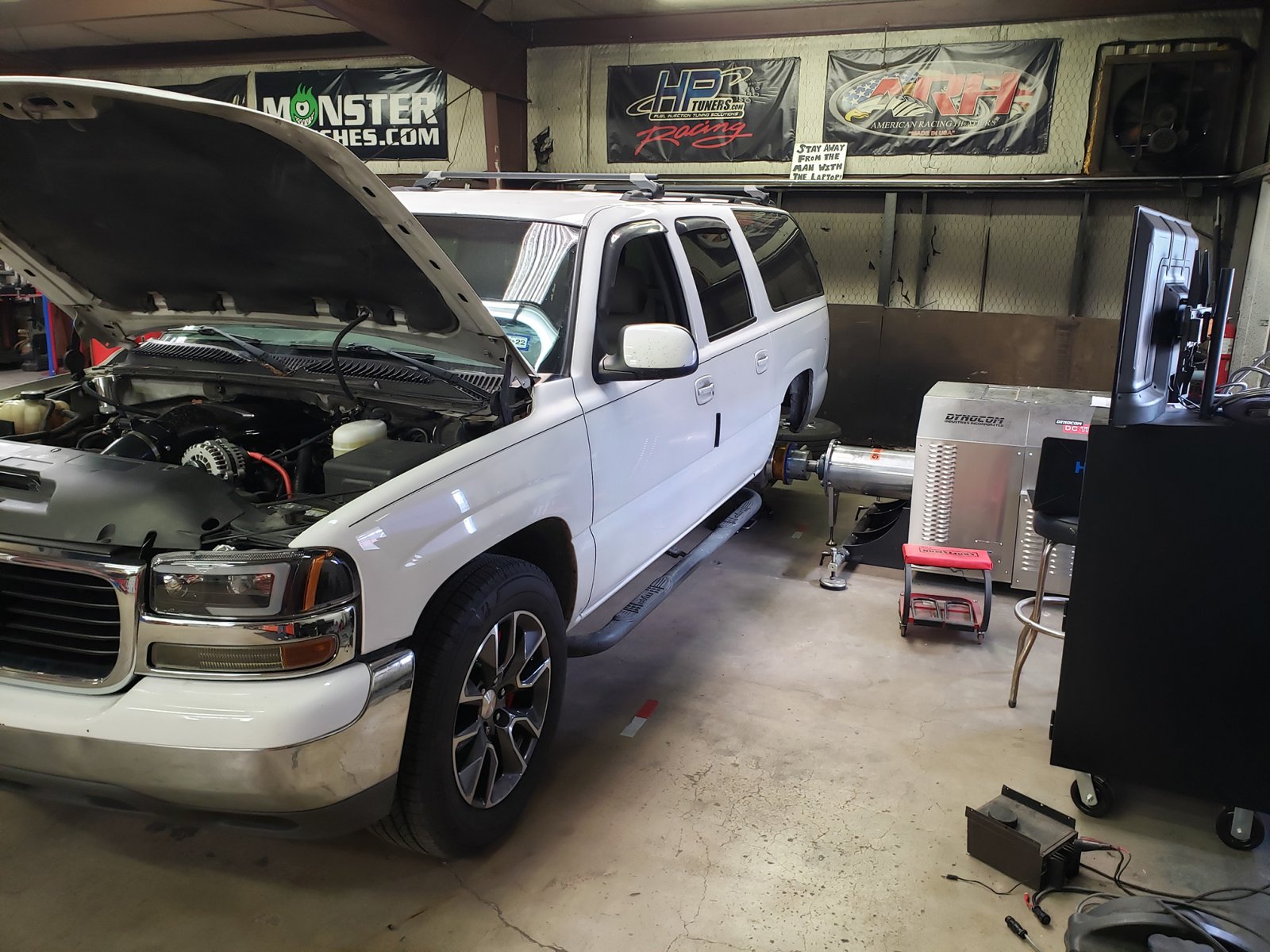

So the dyno day didn't go as planned. Driveshaft blew up on the dyno at about 5400 rpm and 96mph . It was quite the bang when it let go. It also took out the tail shaft housing. Now I'm going with a 2 piece shaft. My dyno guy told me he had never had one blow apart on the dyno, he said they usually come apart on the road at about 142+mph. The 2 piece shaft will cure this problem

Unfortunately I didn't record a video of that. He was slowly making his way up the revs, each run a bit more, then looking at the data on the laptop. This happened at 5400rpm , later on the full run will be to the redline at 7000rpm
Here is a video of the damage underneath (no audio)
33,169
51,367
Damage could've been so much worse.
