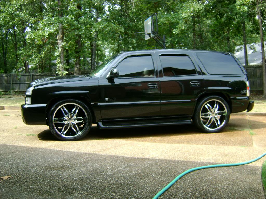

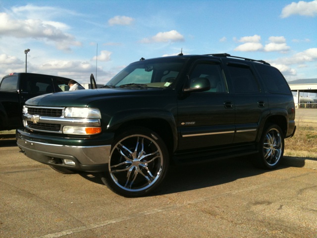

Went from this!
To this! My New Makeover!

I don't know if your changing the whole front end or just changing the bumper.
To install the Silverado front bumper, you will need the front frame horns that hold the bumper from a Silverado and all the attaching brackets. Your front horns will need to be cut off and the Silverados welded on. Also know to put the Silverado bumper on you have to use the fenders, grille and hood from a Silverado. Or you will have a gap between the fenders and bumpers.
If your keeping the Tahoe front. They do sell a SS bumper cover that will fit over the original Tahoe bumper.
