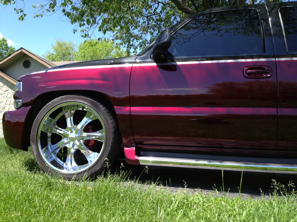

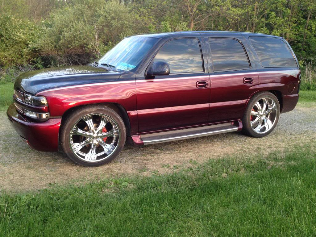

okay i know next to nothing about low rider type trucks and ive always been curious
now did you actually lower the suspension that low so it rides like that all the time or did you do some sort of hydraulic suspension that you can raise and lower it from controls in the vehicle kinda like the impalas you used to see in rap music videos
also with the wheels tucked like that how much does it affect your turning radius

Chris, it's just a static drop. It doesn't have air suspension, although I would love to do it. So yeah, it rides at this height all the time. And I can still turn full lock both directions without rubbing, but I did lose a small bit of turning radius with the lowering spindles. It isn't enough for me to hardly notice though. It actually sat lower before but when we removed the rear bumper and tow receiver it brought the rear up about 3/4 of an inch which sucks because it looked perfect before lol

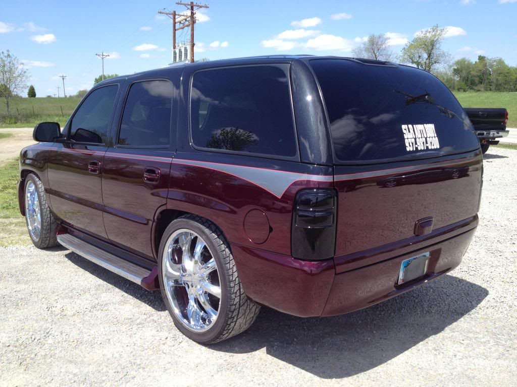

Looks good. How much of a pain was it to replace the rear door panel and rocker? Is that 1 or 2 patch panels? I've got the same issue on my 2000 NBS. Depending upon the difficulty and/or cost will depend on me stepping up to an NNBS. I love my Tahoe though.

Cain, I actually didn't replace the rockers, I only replaced the two rear lower quarter panels. There was some rust in one of the rear door jambs, and some on the bottom of the rocker. We just cut these pieces out, sandblasted them, welded in some new metal, and then welded them back in. I didn't replace the rockers because there was only one small spot of rust on the one side. Replacing the rockers on these trucks isn't cheap. We've done a few at the shop and the replacement rockers are quite expensive, plus they take a lot of labor to install the right way. It's up to you whether to replace them or not, if you really like the truck then I say go for it!

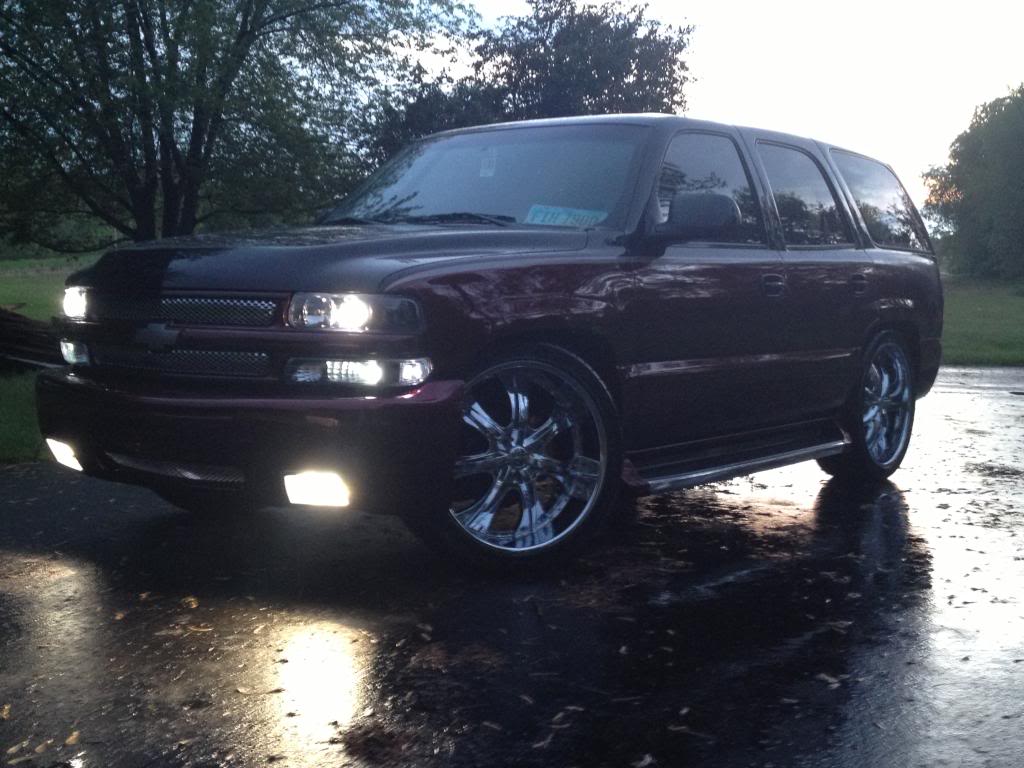

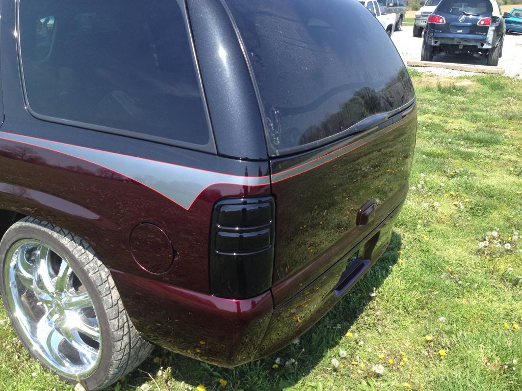

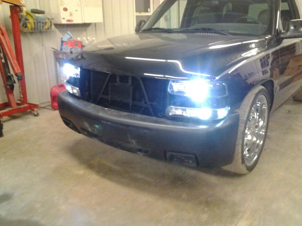

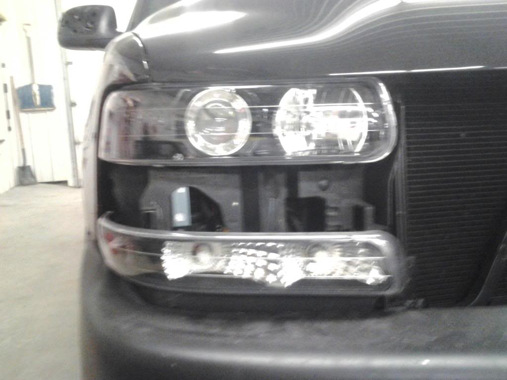

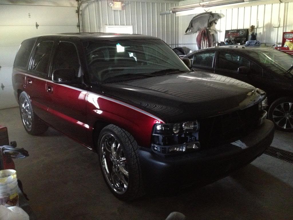

Then we got all the glass back in, I installed some black housing depo headlights and some black housing turn signals, we got the smooth vent caps painted, rollpan installed, tinted the taillights, but the right way this time. I got the front windows tinted 25% to match the other windows, and we put a red vinyl pinstripe around the silver stripe to help seperate the colors.
I got some morimoto 6000k 55watt HID's for the headlights, led switchbacks for the parking lights, some white 194's, and white led's for the DRL's
I just liked the colors in this pic lol

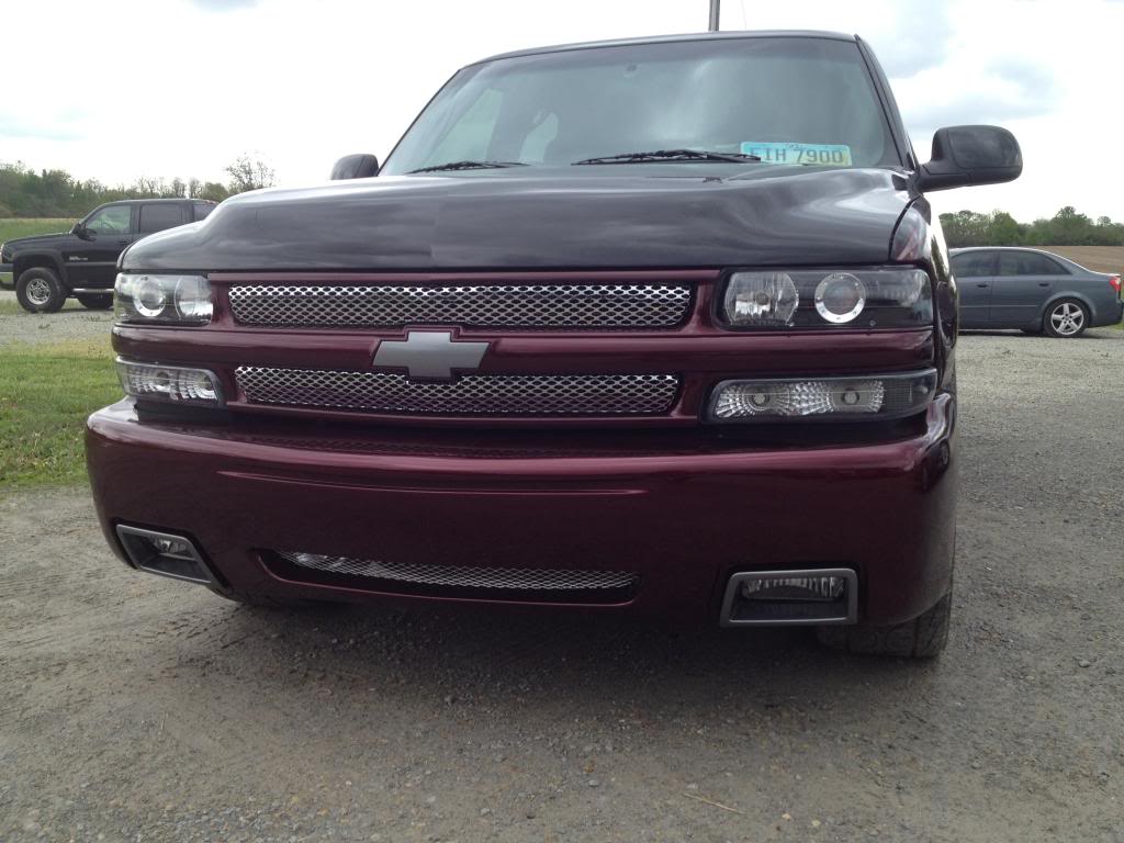

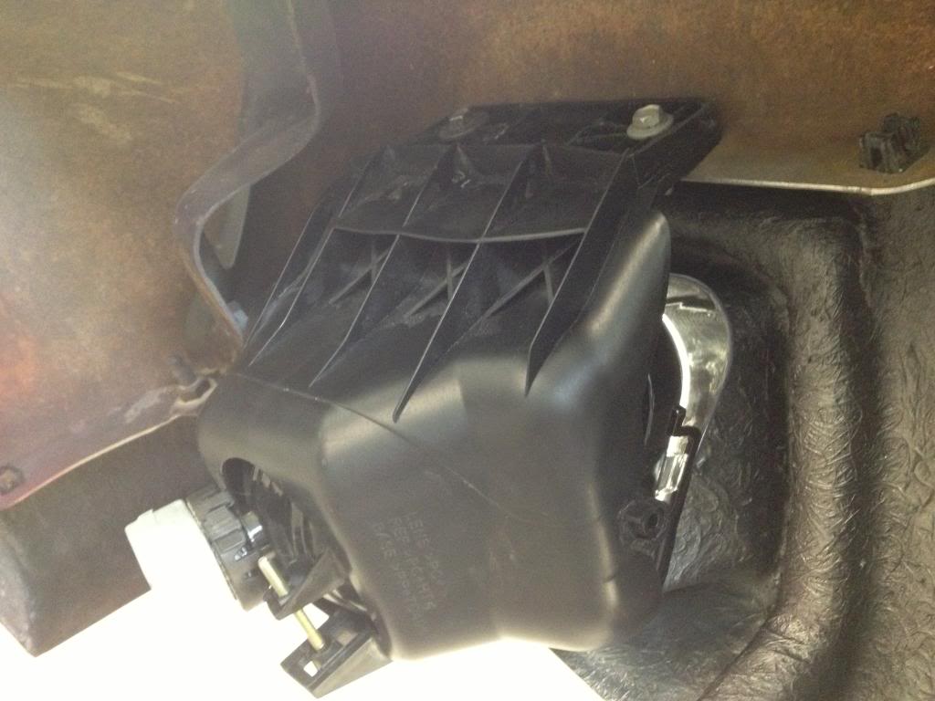

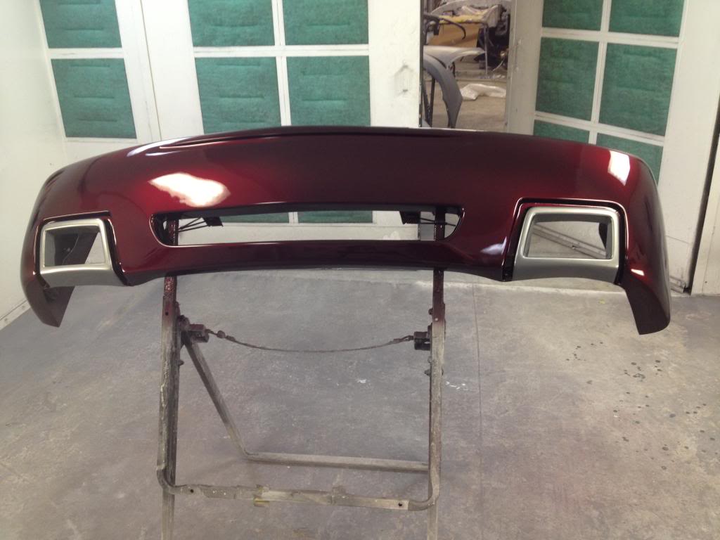

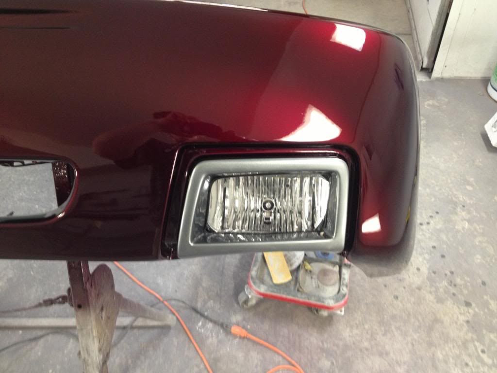

And then we had to deal with the POS ss bumper that I bought off of ebay. It was supposed to be one of the urethane ones, but it came, and it's f'in fiberglass. It wasn't the best mold either. They're supposed to fit with the top bumper cap still on but this one wouldn't fit unless we removed it. We had to fight and pull as hard as we could to get it to fit on the bumper, and ended up having to put a large cut in it to relieve some of the pressure. Anyways, we got that fiberglassed back up, and smoothed it out the best we could. I'll probably end up buying the street scene one later down the road. Anyways, I bought a set of 03 silverado fog lights and made them fit on the bumper by cutting down the ducts on the bumper and using different mounting holes for them. I put some HID bulbs in them that I took out of a set of jaguar headlights we had in the storage room.
Here's how the fogs look from behind
The bumper actually turned out pretty good for what we had to work with
The silverado fog lights ended up fitting in the hole fairly well

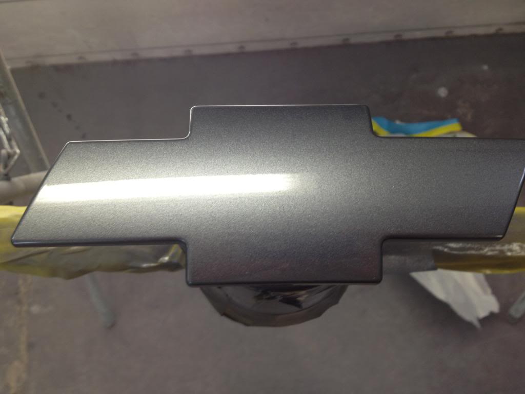

Painted the bowtie in the metallic silver

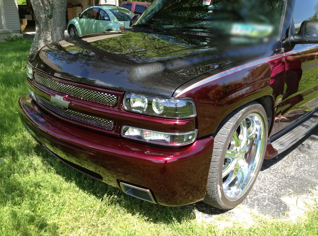

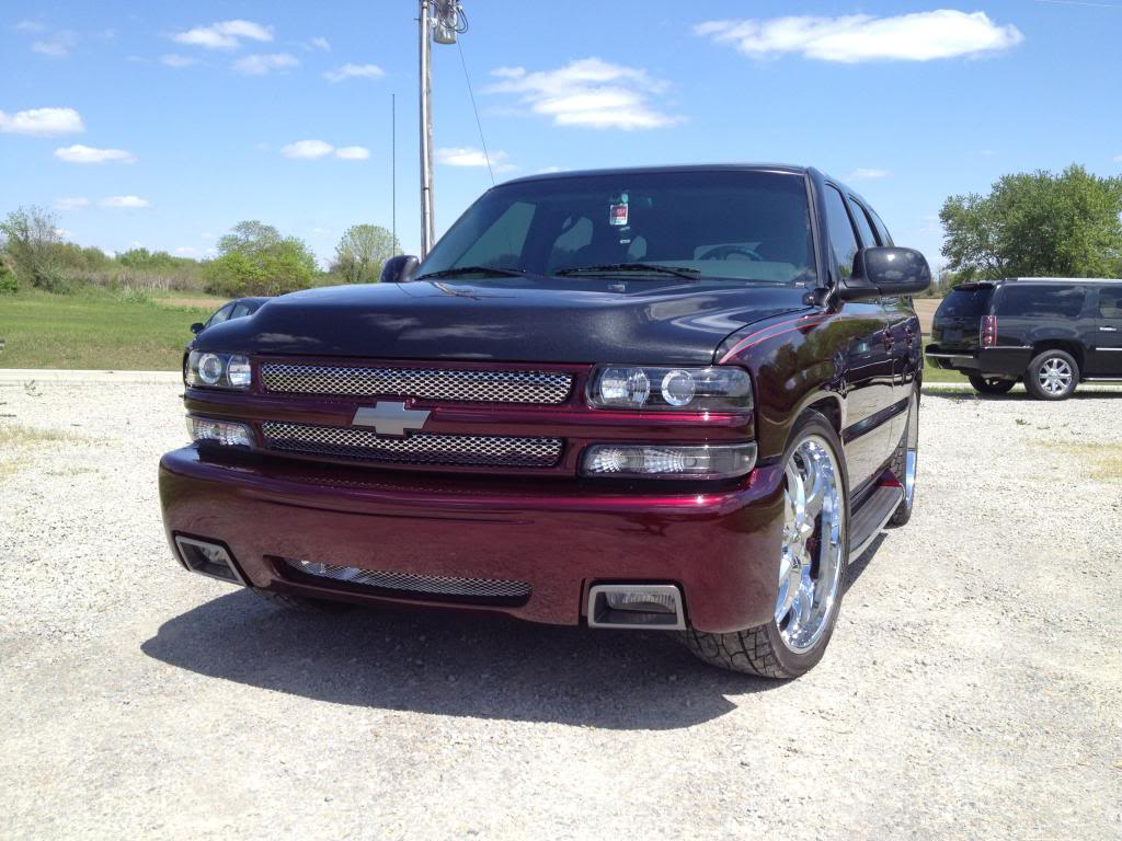

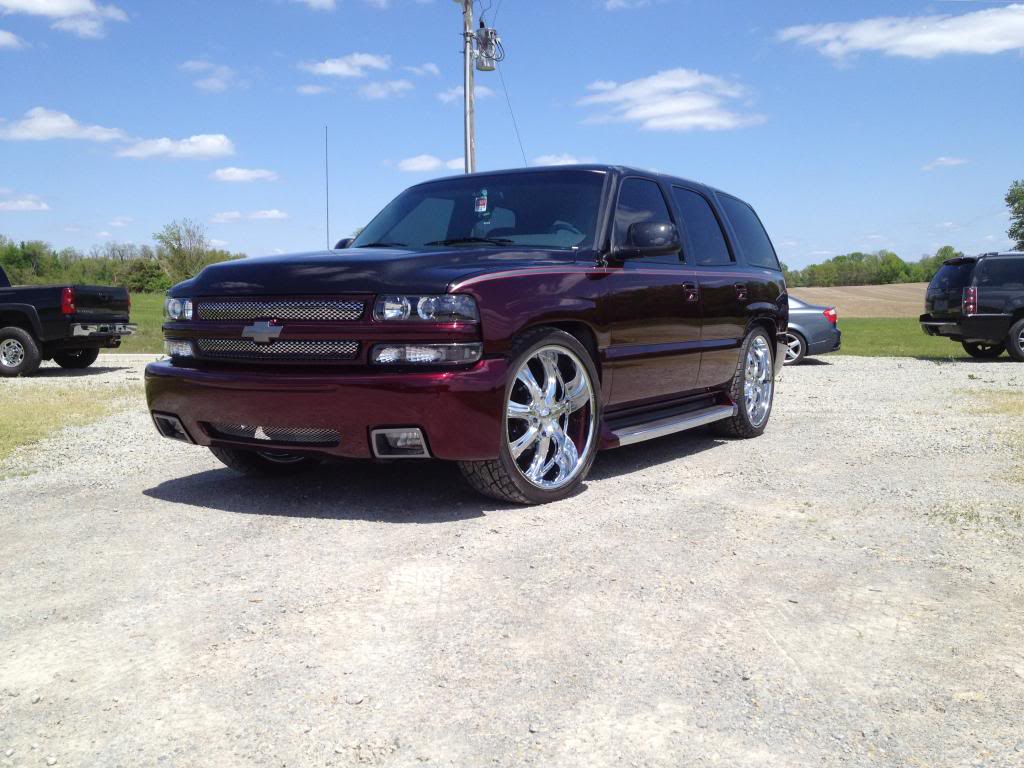

Then we painted the grille, which I also forgot to get a picture of, but that was the last piece! We painted the grille on Thursday, and Friday we put it on and were finished! I drove it Friday for the first time and absolutely love it. Turns a lot of heads and looks just like i've always wanted it to. I've been lurking on this forum for about two years and got most of my ideas from you guys. So let me know what you think! The weather hasn't been great this weekend but I took some pics when the sun peeked out a few times. Anyways, here are some finished pics.

Thanks guys, I appreciate it! And no, we didn't shave the roof rack because I got an escalade roof rack that I was planning to put on it. However, I'm thinking that it actually looks better without it so I kind of wish we had shaved it. And I agree with the rollpan thing, I wish I would have gotten a weld-in one.
