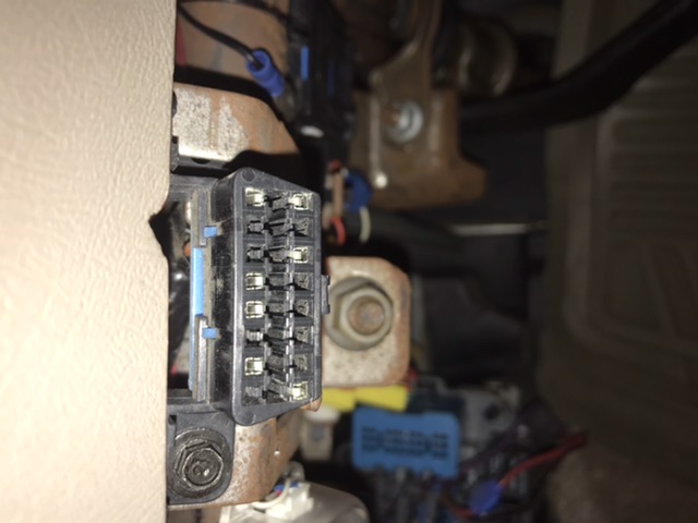

View attachment 239995 hey guys! I have a 2000 Yukon Denali (OBS GMT400). I was going to program some new keyfobs and found out my OBD II plug is missing pins 8 and 13. Anyone else have this issue with their truck like during the body change they switched a few pins around or am I legit missing a few pins? The truck had a collision before I bought it and they did some wiring, so I’m guessing they missed a few things but wanted to check here first.
from what I am seeing just doing a little poking around pins 8 & 13 are not used

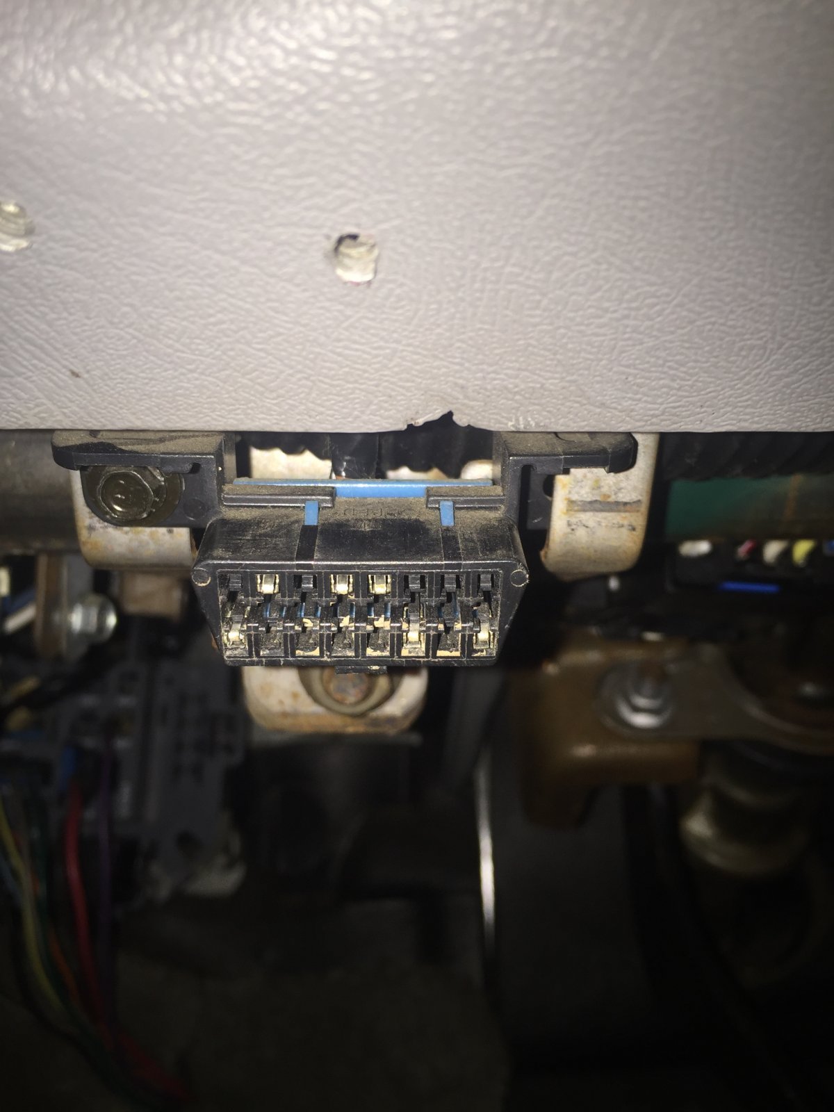

From my ‘99 (built August 1998)
T
TeaSpoon
Feb 6, 2018
20
Awesome thanks! Is yours the Denali body style?
