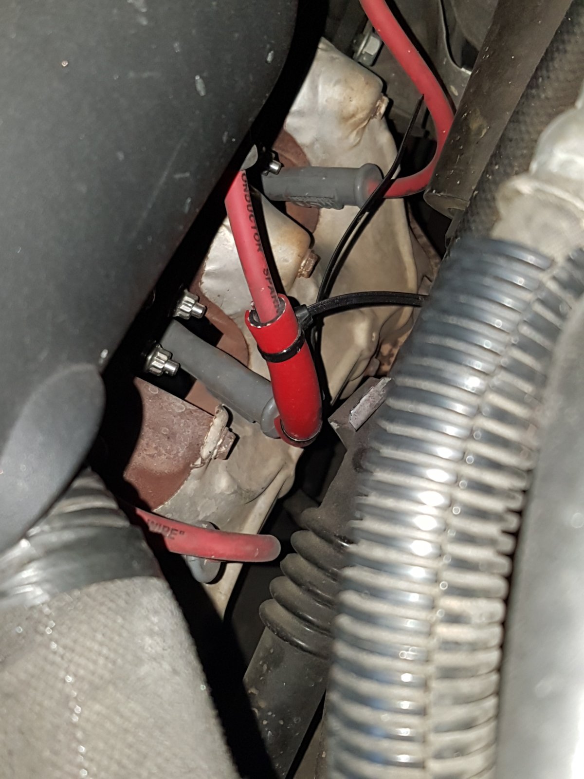

Sounds like a lead is grounding out or a coil pack is cracked and grounding.
Had my son (14) help me do plugs and a set of leads a while back. Delco plugs and msd wires. Ran great. He was happy to help dad in the garage, and I was happy to share with him.
Leaving work one night fire the truck and it's chugging, popping, barely rev, cel is on. Frack. Throw the scanner on random misfire. Hmm. Pop the hood get out of truck it goes away. Wtf. Get back in starts again . Going crazy now. Is my seat hooked up to the ignition?
Get a buddy to sit in truck. Nothing. My truck hates me. Great. So with him sitting in truck and me under hood with a flashlight in my teeth, start feeling around . Nothing. So now I'm looking for a hammer. So buddy gets out and I hear it, Crack ,Crack ,Crack of the spark. Gotcha Fracker.
Turns out when I was getting out I was moving the steering wheel and the steering shaft bolt at the bottom of the column was digging into the #5 (2nd from back driver side) cylinder lead. Thank the good man above it was dark out and I could see the spark jump.
So my fix to get home was a piece of airline cut lengthwise and tie straps.
I think that's a super common issue with aftermarket wires due to the longer length. I had to zip tie mine away from that shaft bolt too.
