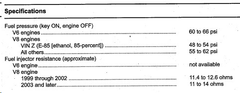

@sgosa, per Haynes:
Note key ON, engine OFF.
