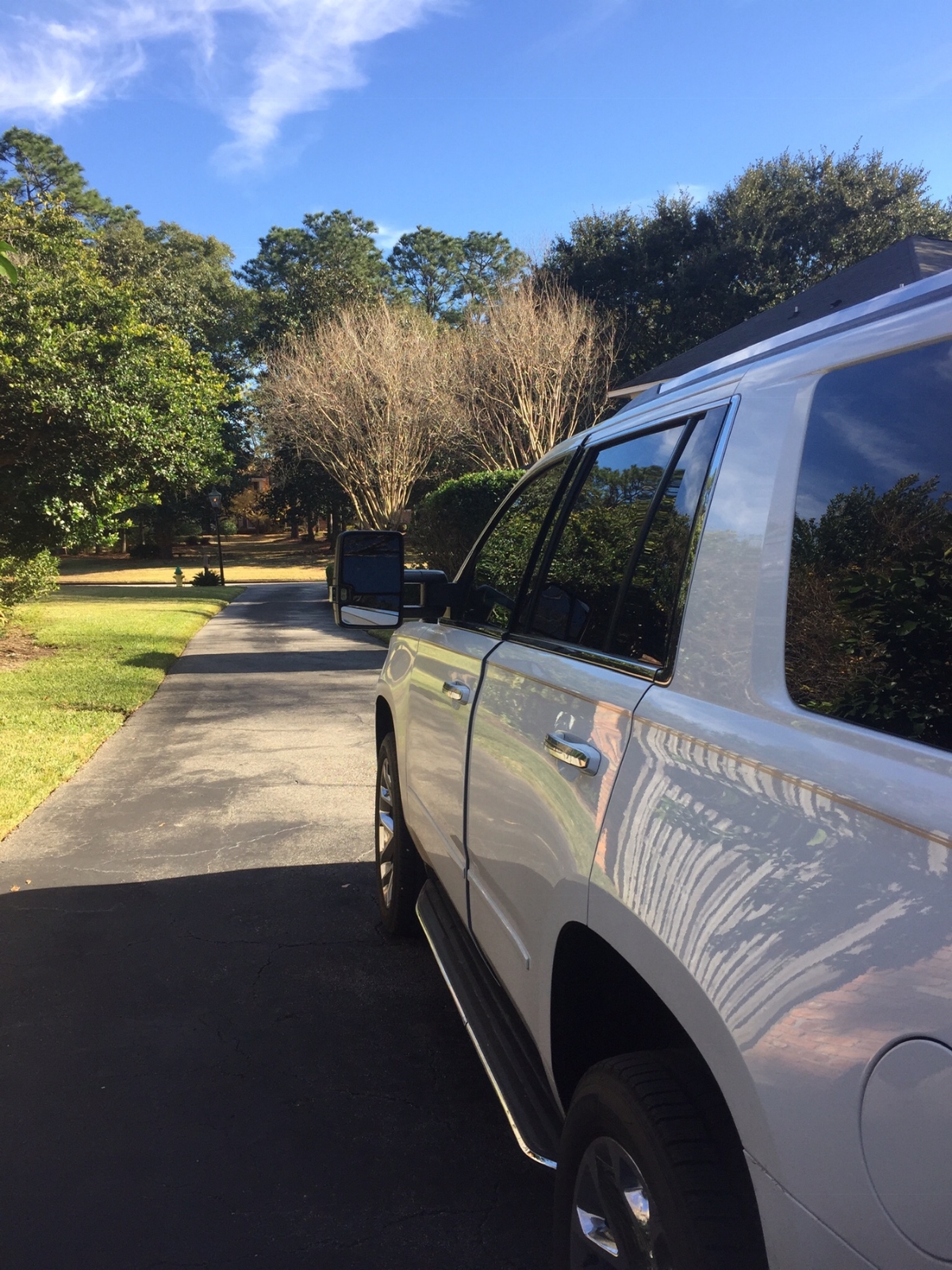

Would I be able to fit the towing mirrors from a 2500 sierra of the same year (2015) on my Yukon xl

Unfortunately, no. The sail piece is physically different.
1AAuto has their Trail Ridge tow mirror that fits. You’ll lose power fold as they don’t have a tow mirror that offers that. They plug & play with the exception of the running lights and rear cargo lamps on the mirrors. I can handle the wiring and make a harness for these to be fully functional.

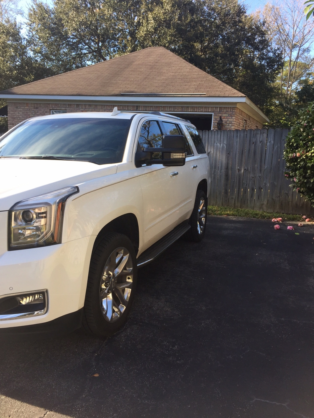

Do you have any more pics you can post such as full front view, full side view? Retracted and extended. I’ve been using the snap on tow mirrors but those don’t give the best view down the side of my travel trailer and need something better. Thanks
