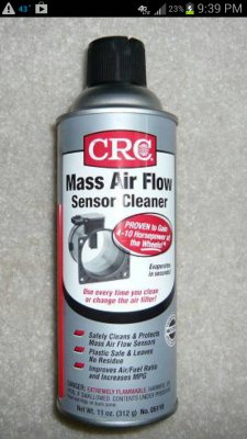

Awesome! took the plunge and got it all cleaned out. Is maf cleaner the same stuff you would use on the tb? I ran some sea foam today too, and didn't get any smoke. I put it in my oil (when I changed it) and in the gas tank. But nothing. I figured after 98,*** miles it would at least give me a little smoke... oh well. Guess it's a good sign. went to get the tranny flushed too but was told it was bad for the gaskets to be under that much pressure, and that it would leave metal and oil in the pan and filter. sooo just gonna change some fluid and call it good

This is the stuff I use, yes you could use It on your tb
