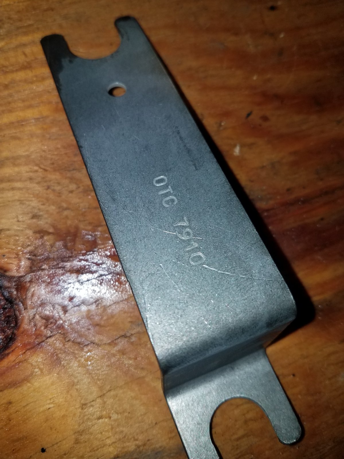

Also you will need one of these to disconnect the clutch line quick disconnect. I tried using flat heads and a few other tricks but was just tearing up the plastic sleeve. Got this on Amazon for $25 or something like that worked effortlessly.

Ive got a few like them just one sided.Being a tech I've got a drawer full of them that come with some new slave cylinders over the years haha
