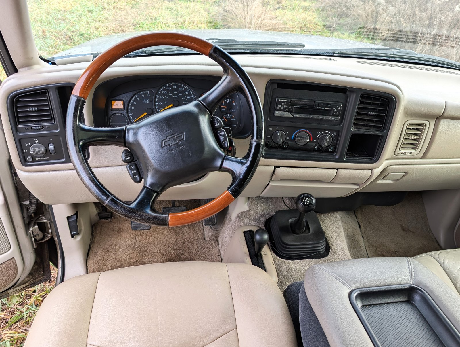

randomsubfan
Feb 17, 2026
I’ve always wanted to manual swap the transmission but I’m not sure how realistic that is. Has anyone else done this to their gmt800 and if so how hard was it?
Manual transmission is good. Manual transmission and manual transfer case is better ;)
Im in love with my NV4500 and NP241.
The swap was not so hard. All bolt-on. Its expensive. The gearbox costs the money, the flywheel, the clutch. Even a good metal clutch pedal costs a $250. You need a wide list of components. Its summarize in big money.

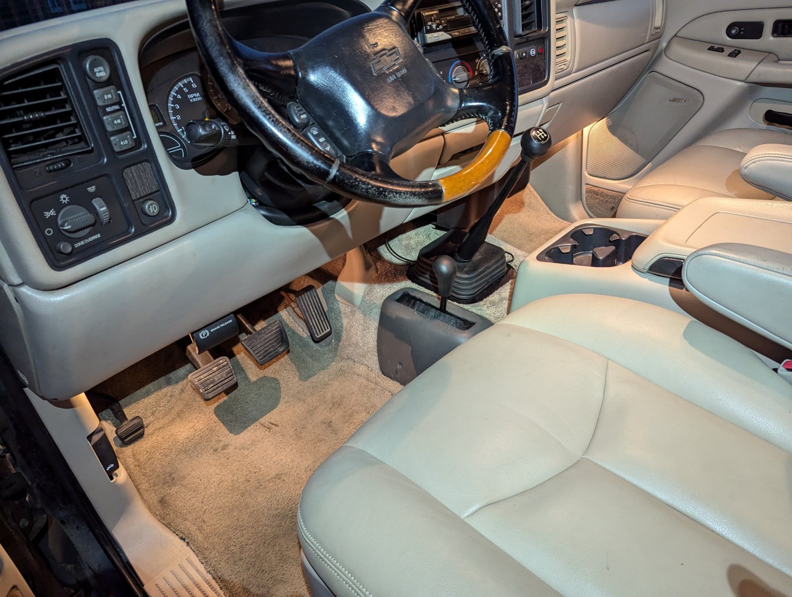

randomsubfan
Feb 17, 2026
Please regard my jealously as a compliment.
Would you mind please making that pic BIGGER?
Also, is that a fold down front center seat, gottdamnt?!
You should click on a pic and its became bigger :rolleyes: I suppose...
Here is one more pic. I made it just after the swap. The fold down front center seat (yes, it is) was installed later.
