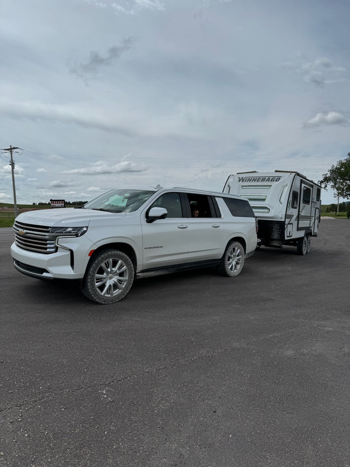

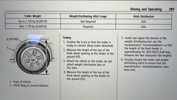

Just finished a trip from Tennessee to the Dakotas and back. I would strongly recommend a weight distributing hitch for your trailer. Page 289 of the owners manual for my 2021 Suburban says trailers over 6000 lbs require a weight distributing hitch.

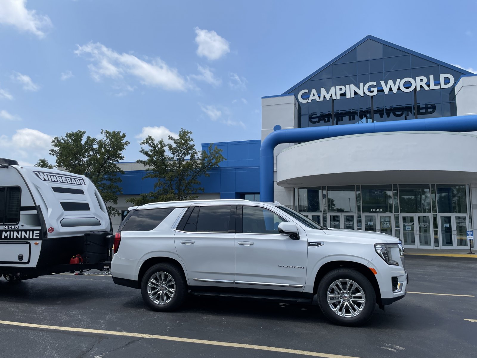

To the guy above me, how do you like your Micro Minnie? I have had a 2100bh for about 6 months now.

Yes, very easy. Once setup, it pretty much is like a normal hitch other than the stabilizer bars/chains that connect to it. Those detach very easily too. I see no downsides to using one other than it usually can’t be used across multiple trailers unless each trailer has the necessary hardware on it.

We like the microminnie design very much, had a 2108 before. stable towing and descent value for what it is. easy to work on. 1720 we have a is pretty small, good for about 2 week trip with 2 people & small dog.

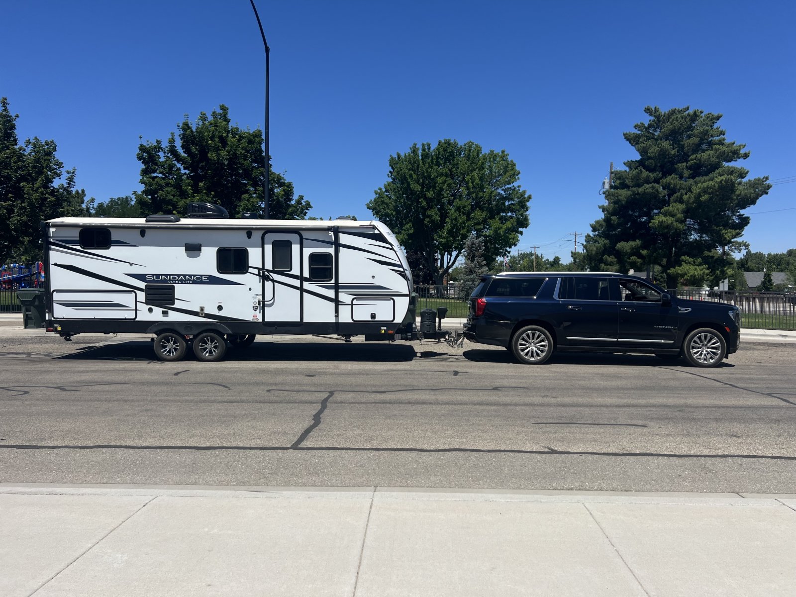

A year ago we bought a 2021 Yukon Denali 6.2L/10-speed with mageride (no air) to tow our 5300lb dual axle trailer -> camper w/650lb tongue weight. It didn't have the tow package so we added a Curt brake controller. It tows/operates very well / very pleased.
Without WDH the rear dropped and front raised noticeably more than with WDH. With WDH it's looks pretty much level and is rock solid up to 70mph w/20mph cross-winds.

Not exactly sure what it is when fully loaded but dry, it’s 570lbs. If I had to guess, loaded(around 6500lbs)it’s probably at 700-750lbs. For reference, the trailer is a Sundance 241bh.

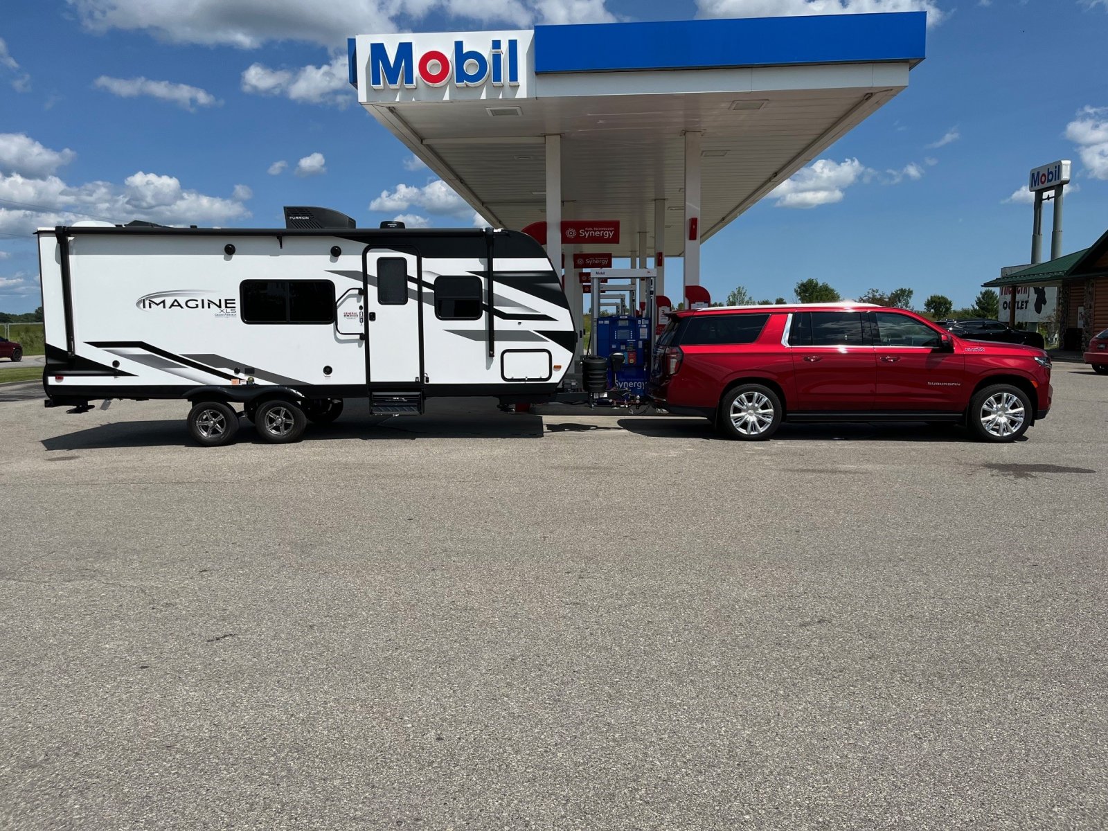

My 2021 Suburban tows fantastic. We pull a Grand Design Imagine MLE 22. It has a slide and weighs around 5200 lbs. unloaded. The Suburban sits a little low in the back but it tows so well, I don't want to adjust it. It will pull at 80 mph, only tried it to see, I usually stay at the truck speed limit, and there is no sway at all. I do have a WD hitch. It is the best towing vehicle I have ever owned. It does not have air ride but does have magneride.

Weight distributing hitch (WDH) for the win! Looks great.
I've been towing a 7500 lb camper with a 2012 Yukon XL Denali for several years now, and I agree that these rigs are a great towing platform. But I wouldn't tow anything more than 4000 lbs without a WDH with integrated sway control. I've had some experiences towing in heavy, gusty winds where I know I would have struggled to maintain control without effective sway control on the hitch itself.
It's also worth mentioning that the factory integrated trailer brake controller takes sway control to the next level by engaging the trailer brakes when it detects too much trailer sway.
