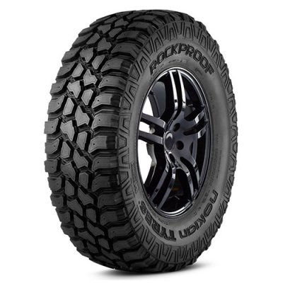

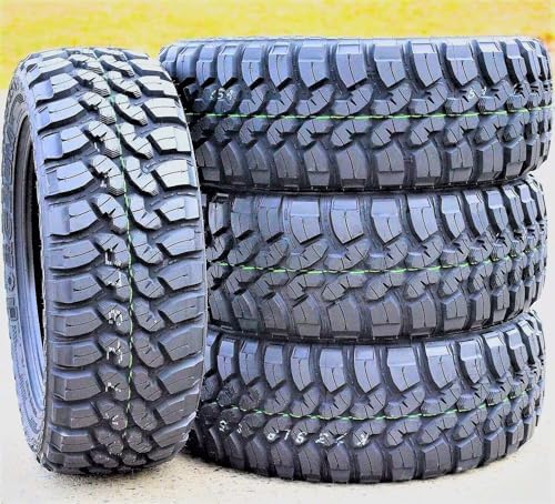

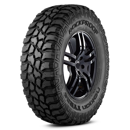

Here are some stock photos of what they look like
