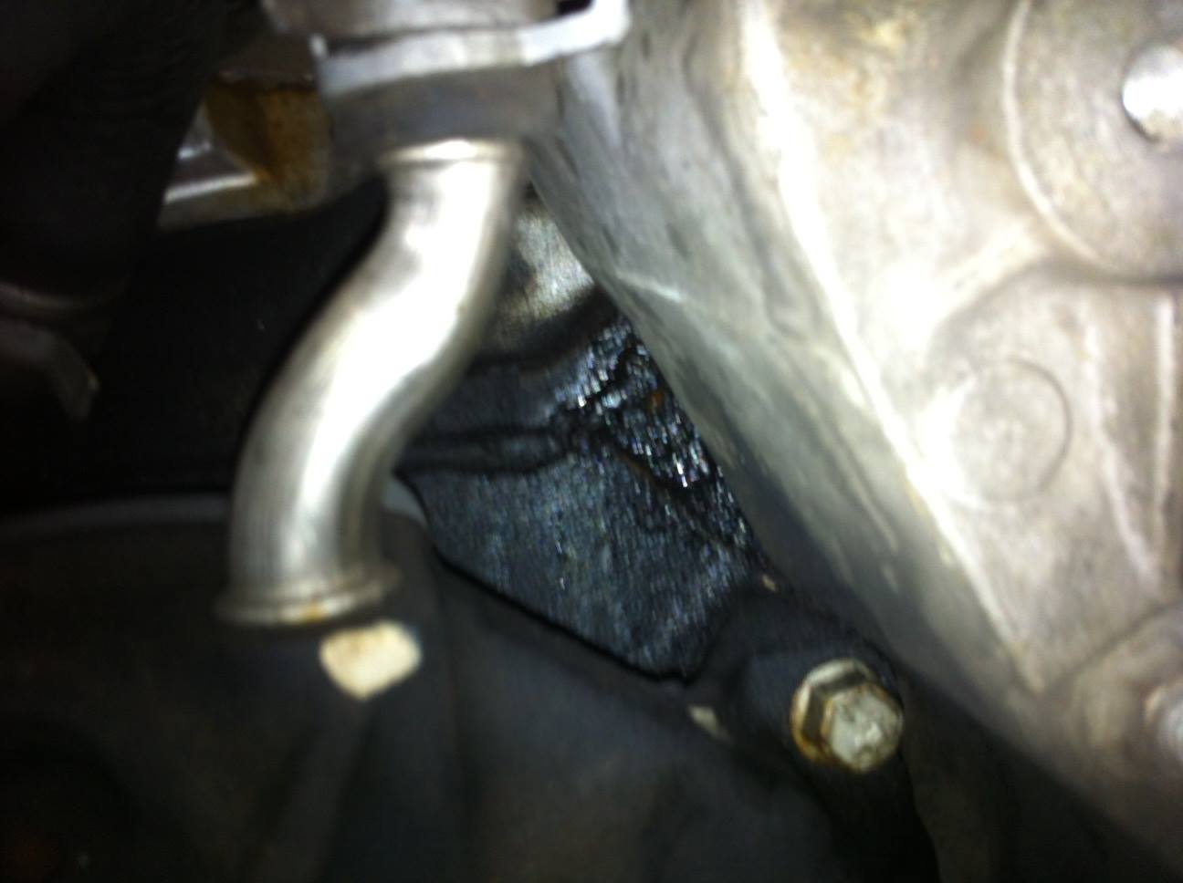

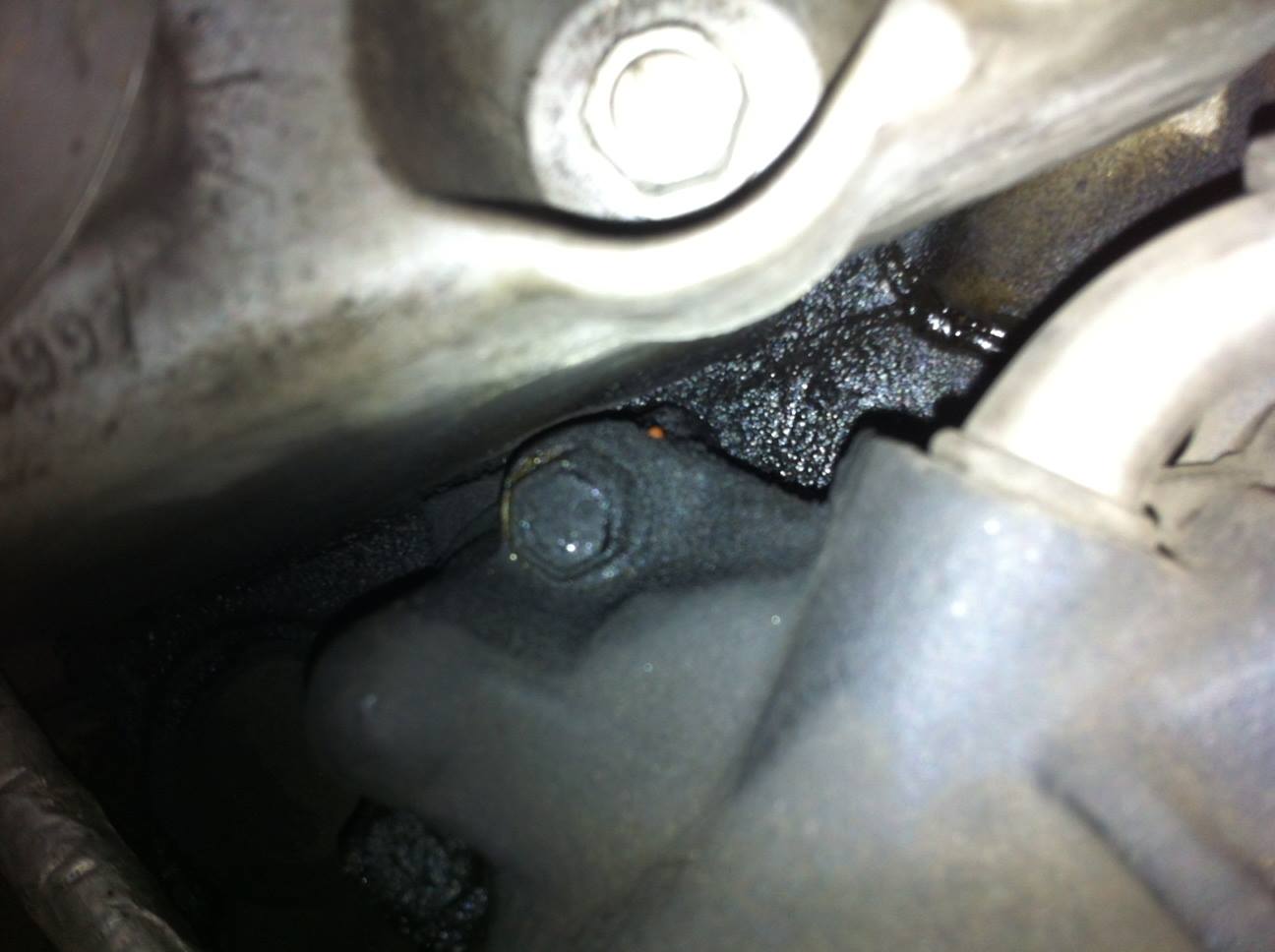

Here's pics of the front of mine from years back before I changed the water pump. It leaks where the intake manifold meets the head. I've not done mine because I have nowhere to do it. Every time I change a decent amount of coolant I put two tabs in before I take the truck on a run.

96-2D-Hoe
