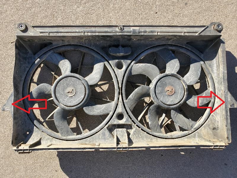

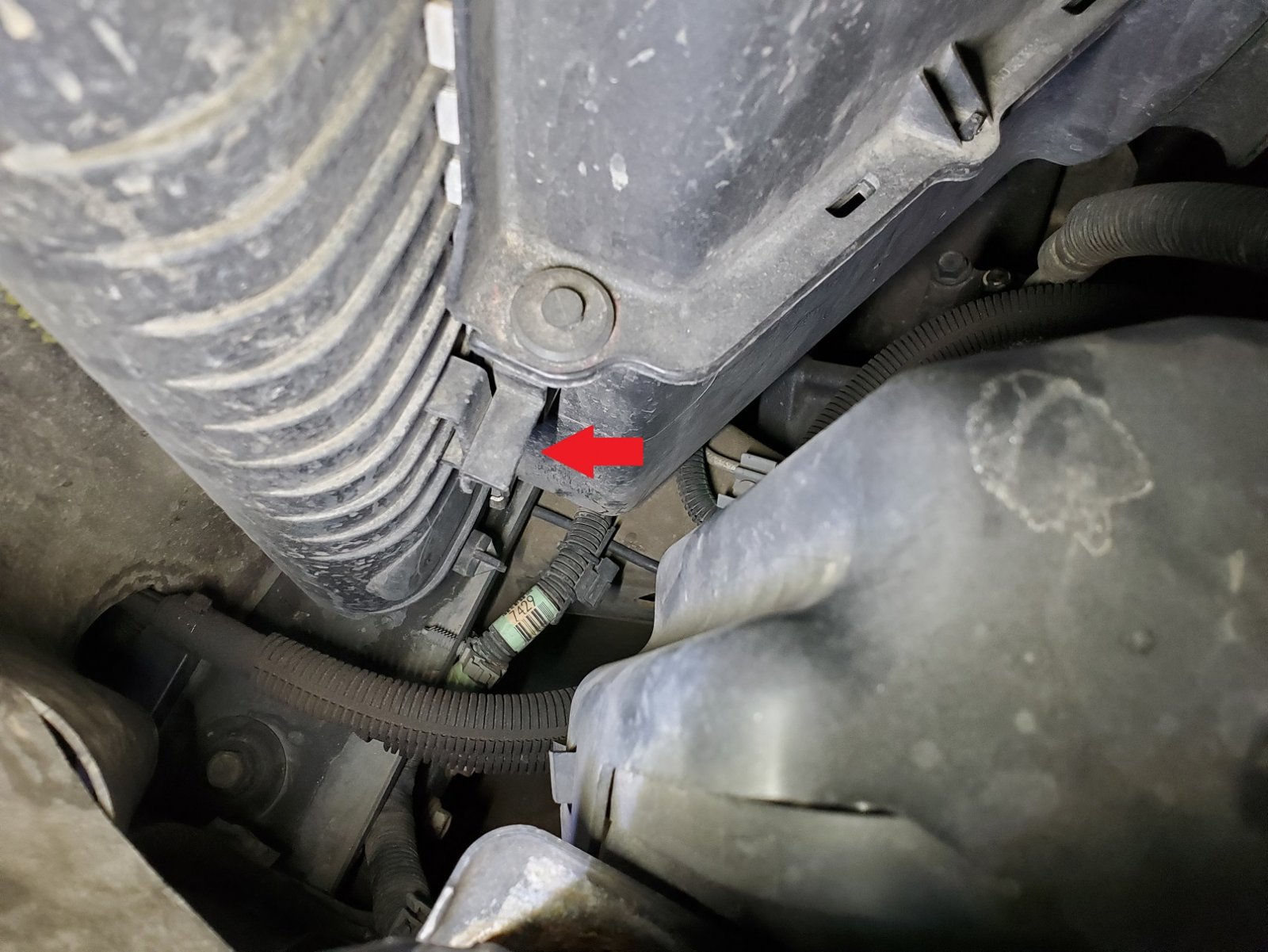

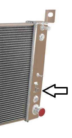

The radiators have a hook on each end; the clutch fan lower shroud (like the electric fan shroud shown below) has ears that stick out to slip into the hooks to hold it tight to the radiator.

On the clutch fan shroud the ears are a couple of inches below the bolts that hold the two halves together.

couldn't have asked for a better descriptive example. wouldn't be the first time ive seen those bolts missing as its a typical spot for a bolt on numerous vehicles and years. dont know why but bolts there tend to rust hella quick and will snap when removing them.
@Sam Harris did you recognize your electric fans? ;)

THANKS fless!!!! Just what I needed. I don't think it was on right when I took it off as it was never that stable before. Gotta love those KISS things..... Keep It Simple Steve
