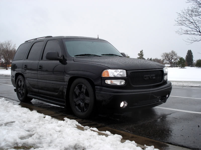

Easy stuff
Cv angles are still fine, no issues with my 5/5 drop or whatever the hell it is now :cheers:

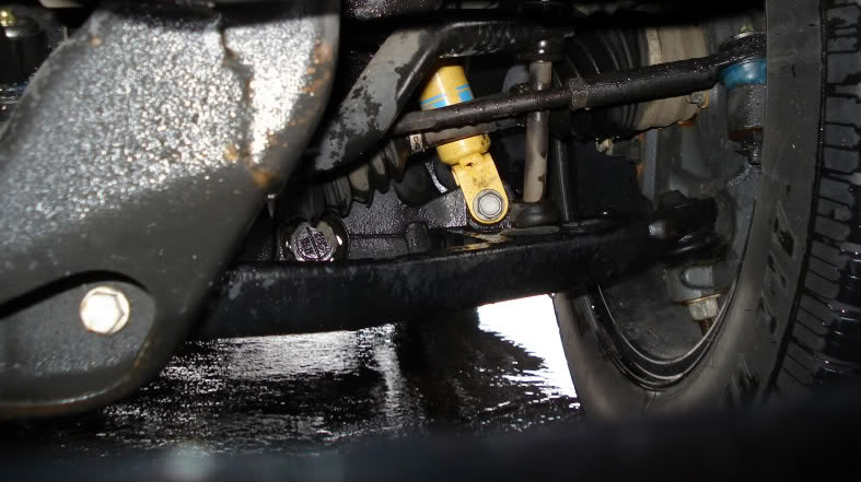

Ride is a bit worse, but I need to cut my bumpstop brackets out and install some lower profile stops...funny since I've done it on a half dozen trucks and still not my own. Front is dropped via 2" belltech drop spindles and 3/4 ton torsion bar keys. Rear is belltech 5" springs with isolators removed and the coil buckets beaten to hell for the most possible drop without bags. I'd do a 2/3 drop with spindles if you can afford it, 3/5 you have to start doing all kinds of extra crap but it's worth it.
