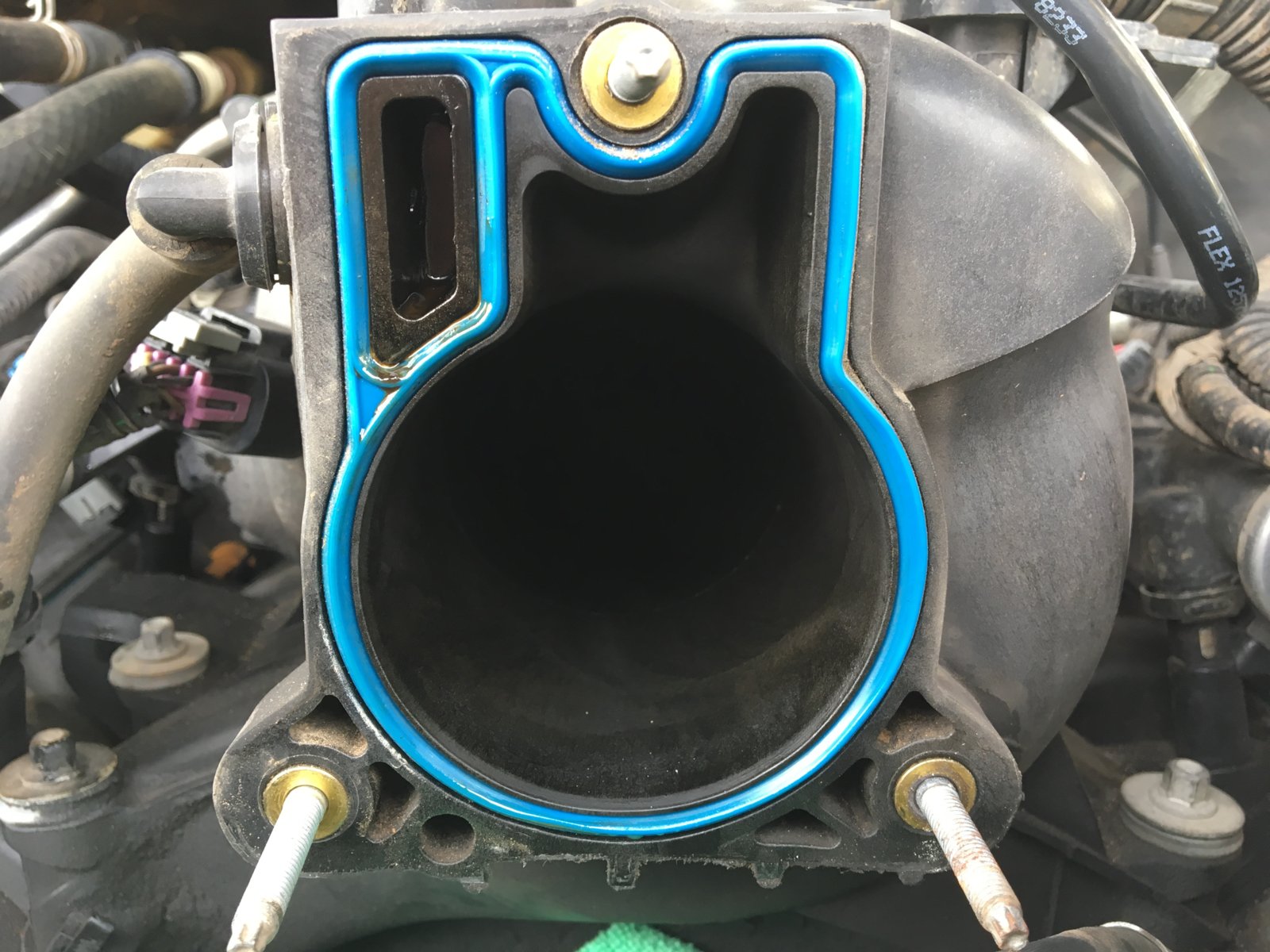

Removed the throttle body and gave it a good cleaning, have to see how it does afterwards, here are a few pictures of after it was removed!

Even after the intense cleaning on the throttle body I drive home and as I’m slowing down the RPM’s drop and almost stall! They go back up and as I put Tahoe in Park, the RPM’s drop again! Any thoughts?
30,524
47,954
unless you want to drop $85 on a diagnostic I would maybe just slap another throttle body on and see, even a used one from the junk yard, there not terribly expensive. on the older throttle bodys you could just change the IAC but I don't think you can on these drive by wire.
