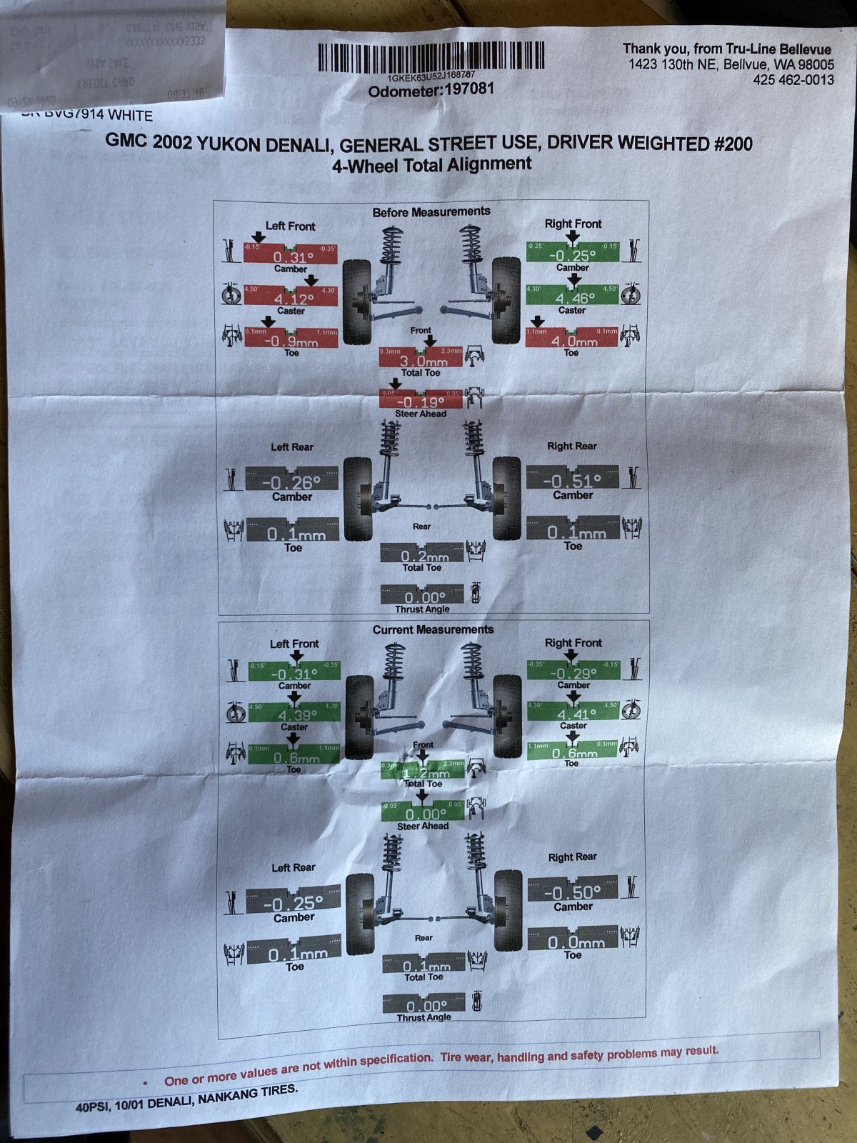

Hi PNW,
As for the alignment I used one of the top-rated shops in the area. Pulling is while driving, worst at speeds around 35. Clunking is a feeling, I performed most of the repairs. Always concerned while driving, just because I've never had such bad "clunky" steering. I'm headed out to adjust the steering gear box to see if that helps anything. Thanks for the help!!

Ok, the before and after readings look pretty good. I would like to see just a hair more caster lead on the RF but is ok for now. Be careful adjusting the steering gear box. Just an 1/8 turn at a time. If you go to far you cannot back it up because the damage is done. I would check all your previous work and swap the front and rear tires/wheels and see what happens. You may have a slipped belt in one of the tires. Are all tires wearing even across the treads?
