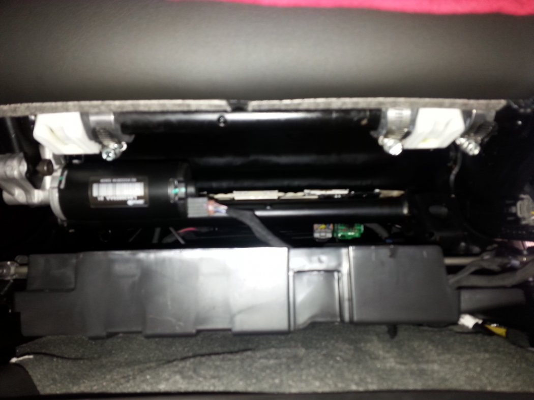

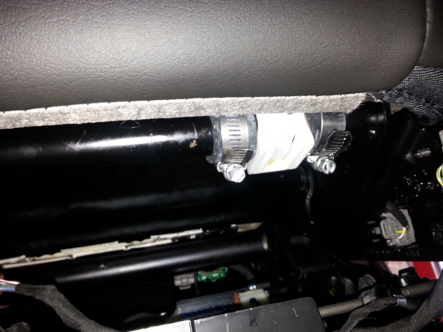

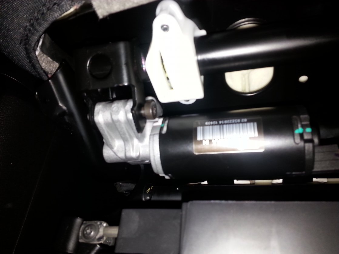

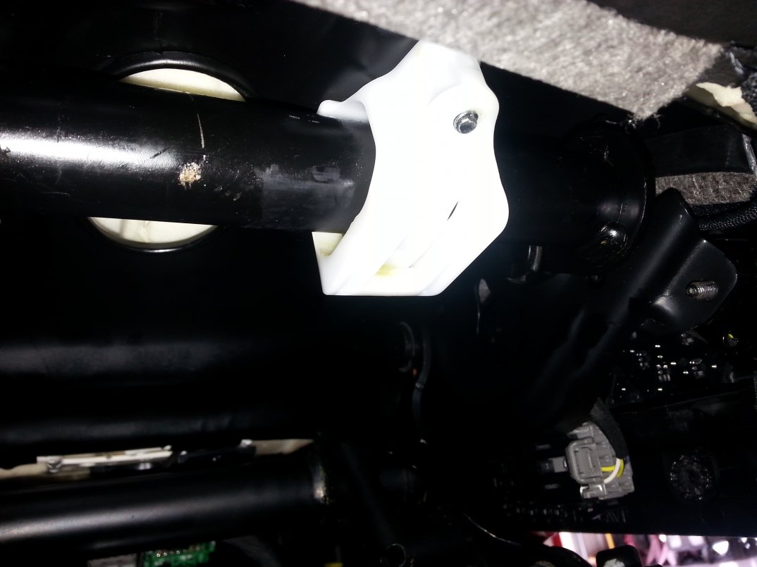

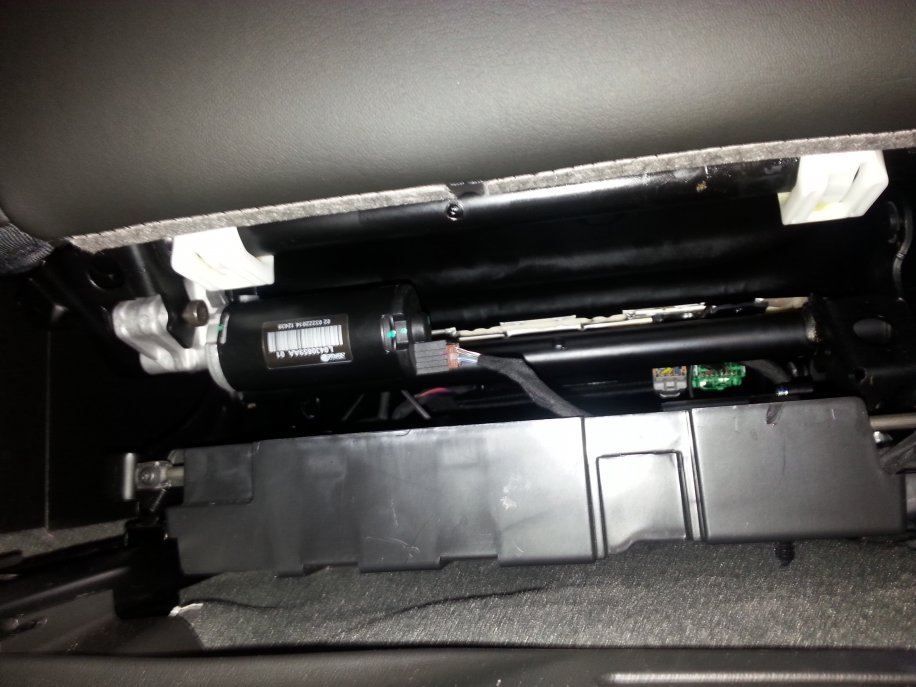

*** Update
That's it! I was able to put my hand on those white clips and you can feel the shift in the clip when you feel it in the seat. I bought a foot piece of 1" heater hose, slit it in half, slid it up against the white clips and then put hose clamps over them. Good to go!
Thanks for the link again!
Before and after pics. Looking under the seat from the front.
