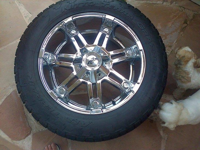

Thanks guys, im picking up some sweet rims and tires sunday.....BUT there to big for the setup...325 50 22's....so whats the easiest/cheapest way to make them fit

If you're doing keys in the front, it will align with stock uca's.
To fit those wheels and tires with total clearance you'll need a 6" lift. You may be able to get away with them with keys and a ton of trimming, depending on the backspacing.
Just a warning, cranked keys + low profile tires won't make for a very enjoyable ride.

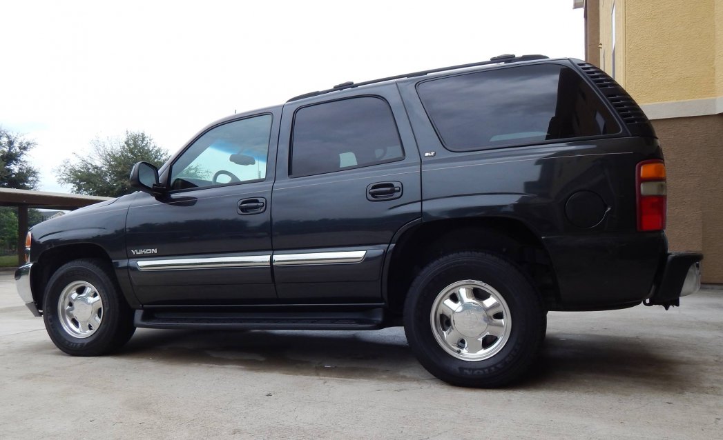

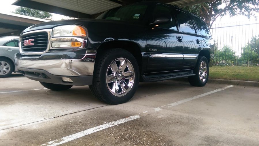

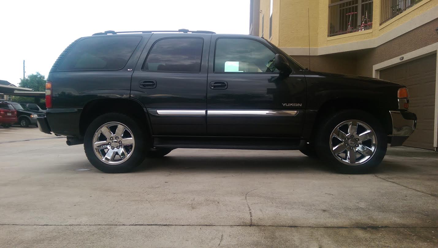

This is what I ended up getting, Next replacing ball joints, 1 of the uppers boot is busted, going with Raybestos pro grade uca's and Raybestos pro lower ball joints, and 2-3" keys
