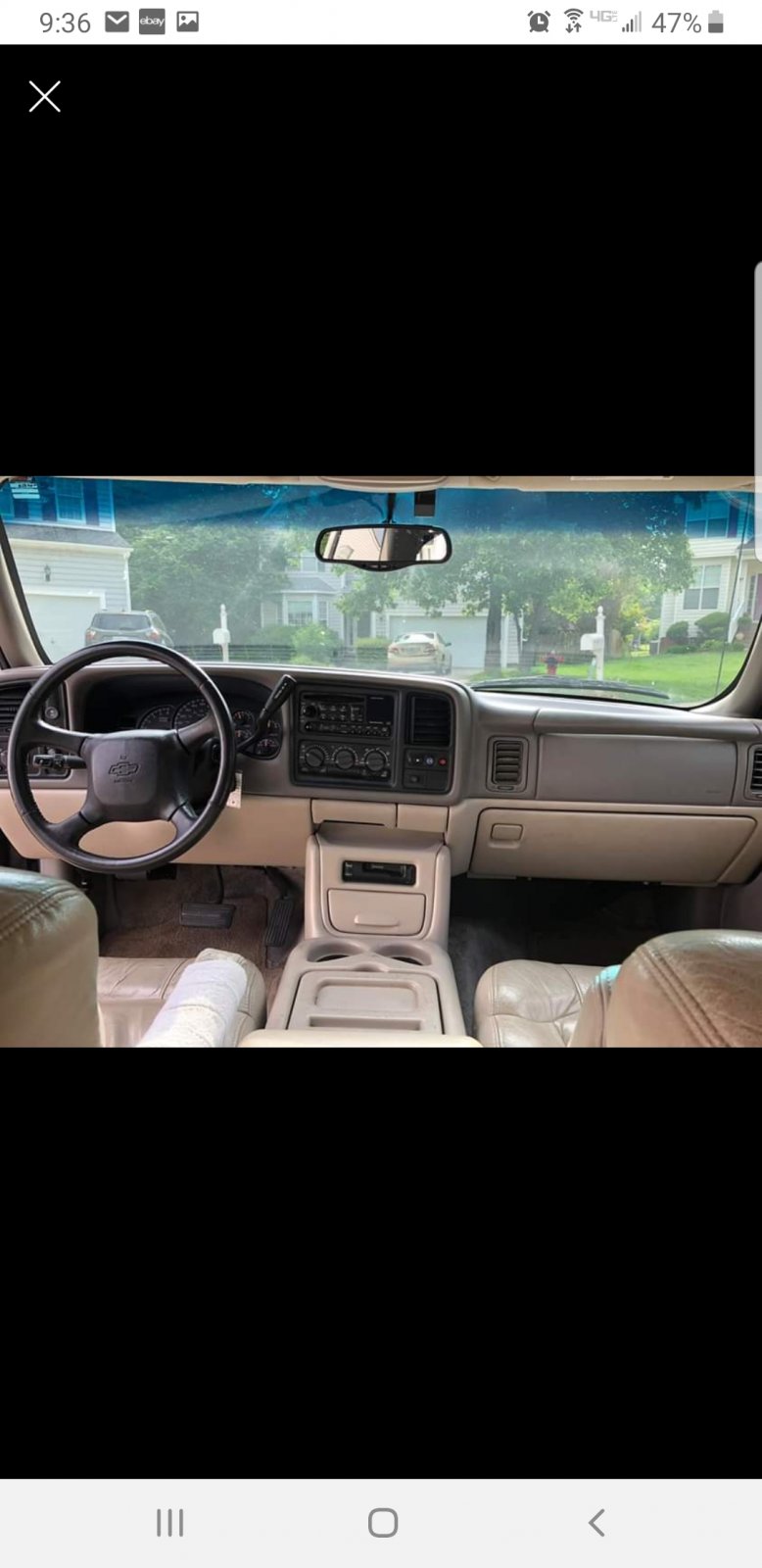

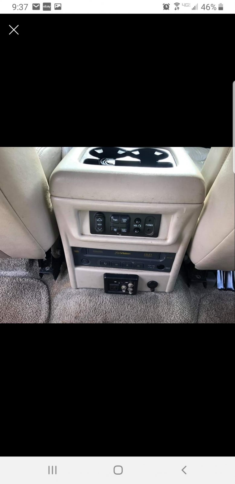

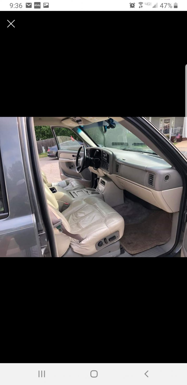

The Tahoe has had a stock entertainment center installed in it at some point. You can tell the wiring was aftermarket but the components are stock. It has the VCR, Power Inverter, small TV Screen, Center console, etc installed... I'm working on a no volume condition for this set up as we speak.
Screenshot_20190506-213708_Facebook.jpg Screenshot_20190506-213622_Facebook.jpg Screenshot_20190506-213702_Facebook.jpg

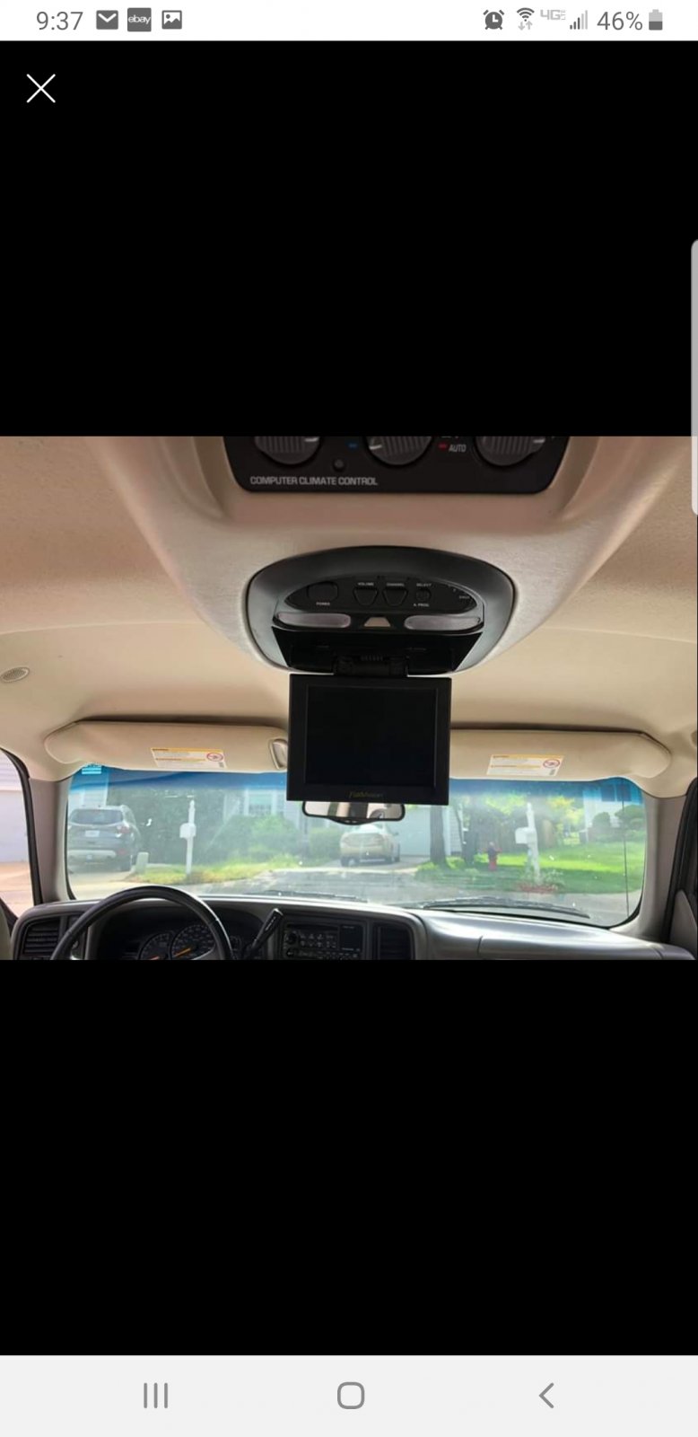

I'm in the process of replacing every speaker in the Tahoe as each and every one of them were blown. The cones were destroyed. I replaced the stock sub with a 600 Watt Boss 4 Ohm, dual voice coil sub. I run it in parallel so it would meet the stock 2 Ohm level. It performs well considering it is run by the stock amp! The rear and front speakers are next!
View attachment 235763 View attachment 235764 View attachment 235765
I don't think that's a stock center console. Can we get some more pictures of it? Never seen anything like those top cupholders.
Any chance it's a conversion like a Regency or Ducks Ultd or something like that?

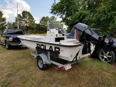

Welcome. Don't forget pics of the boat too. :)

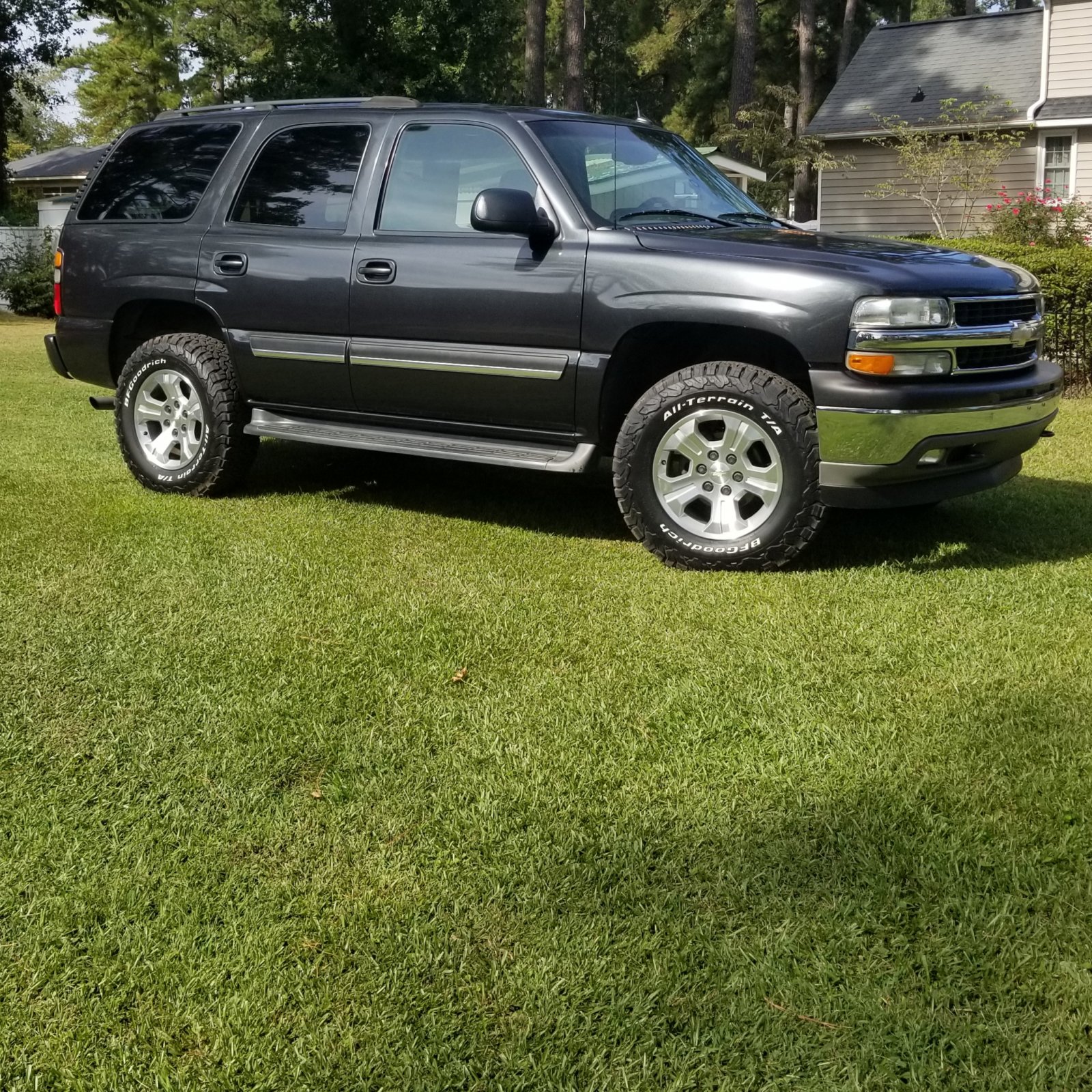

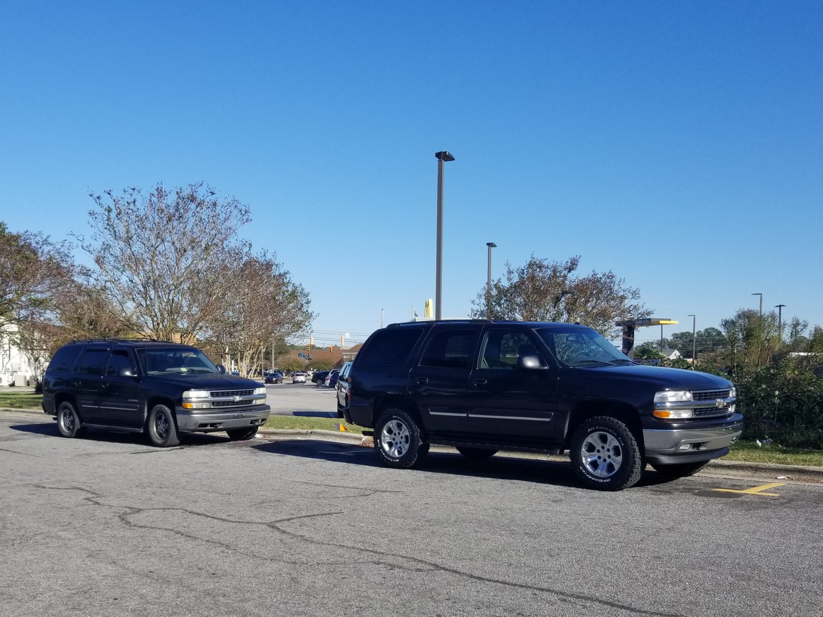

I did something very similar to @HiHoeSilver. Motofab keys from amazon (0-3" lift), z71 springs, and 275/70r18s. With wheels and tires it was ~$1500 and the wheels and tires were a majority of that amount. I installed it all myself including mounting and balancing the tires and the alignment (perks of having a friend who is a tech at a Chevy dealer), so the labor total was $10 to buy my friend lunch. I'd recommend just buying the parts new. The most expensive part of it is shocks and including that you could have all of your parts for ~$300.
Springs: https://www.amazon.com/gp/product/B00498ZR7A/ref=ppx_yo_dt_b_asin_title_o07_s00?ie=UTF8&psc=1
Keys: https://www.amazon.com/gp/product/B01N4LOPMF/ref=ppx_yo_dt_b_asin_title_o08_s00?ie=UTF8&psc=1
You can add rear spacers for even more lift, but that requires cranking the keys even more and you'll run into issues with down travel in the front end. Basically when you crank the keys to raise the front end, the resting position of the front end is higher. There is only so much up travel in the control arms before they will be sitting on the upper stops and you will not have any travel left.
I'll take some more this evening and show everyone. I didn't think it was original equipment!

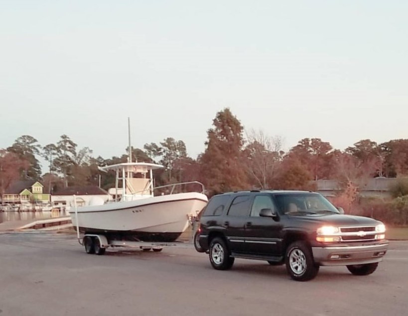

Sharp looking Tahoe brother! Man oh man!
Seems like the general consensus is to use the Z71 springs on the rear and keys on the front! Buy the lift shocks and enjoy the lift for what it is! May be what I end up doing.
Your opinions and shared expertise is truly appreciated!
By the way... My precious career demanded much of my time and sold my two previous boats. I now own a small river boat! After some work, it is a solid mode of transportation!

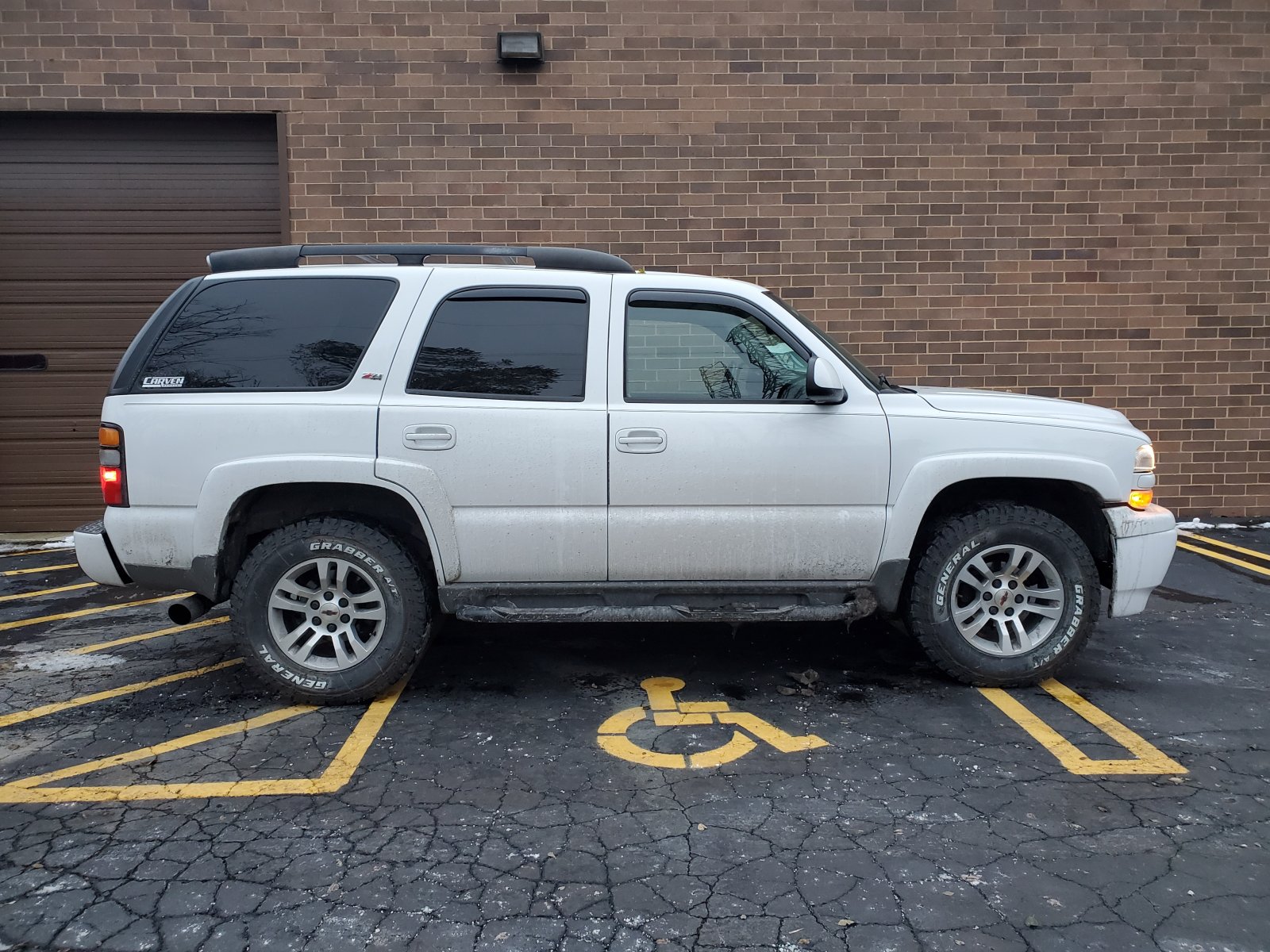

Offset makes a much bigger difference than wheel width. Mine are 18x8.5 +24 offset. They are factory 2016+ z71 wheels and I have 275/70r18 BFG KO2s. You could definitely fit a 285 width tire on that rim, but 285s are generally more expensive with an 18" rim. If you're keeping the 16s, 285/75r16 is a common ~33" size and should clear (haven't tested it). If you do a lot of off road driving, it will probably rub. On the street, you should have very few issues.
You CANNOT run 35s with only keys and spacers. I know some people have done it, but the front upper control arms will be on the bump stops and the truck will ride awful. The right way to clear 35s is a full lift kit.
